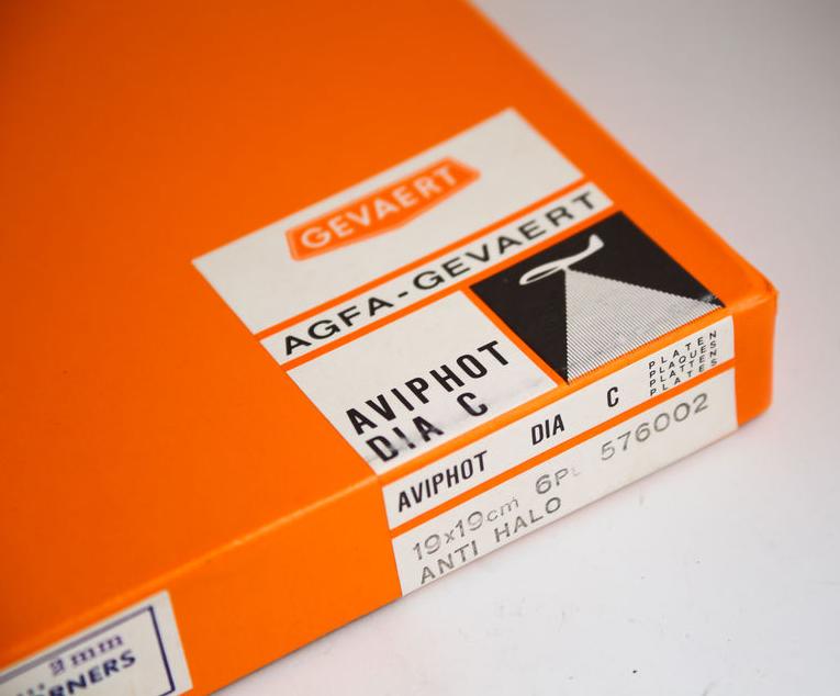

    Hello, I just got a pack of 19x19cm glass plates made by Agfa. The label just says Aviphot Dia C and no other information is available. I googled it and only understood that this is aerial photo material, possibly reversible.
    Has anyone have experience with this material -- exposure, development, etc.?
    Thank you,
    Vesselin
