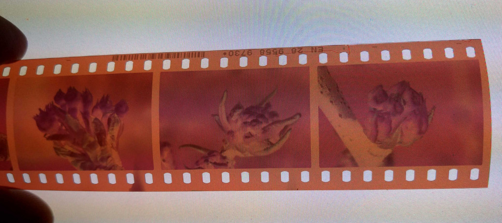

Neg snapshot to show density

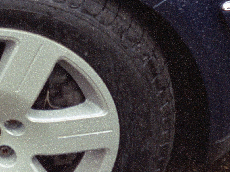

Here's the next roll, 50D. Still dealing with the "snow".
Olympus EE-2 (half-frame), Vision3 50D, 1/40 sec, F3.5 (manual mode)
Zoomed in, 3600 DPI:

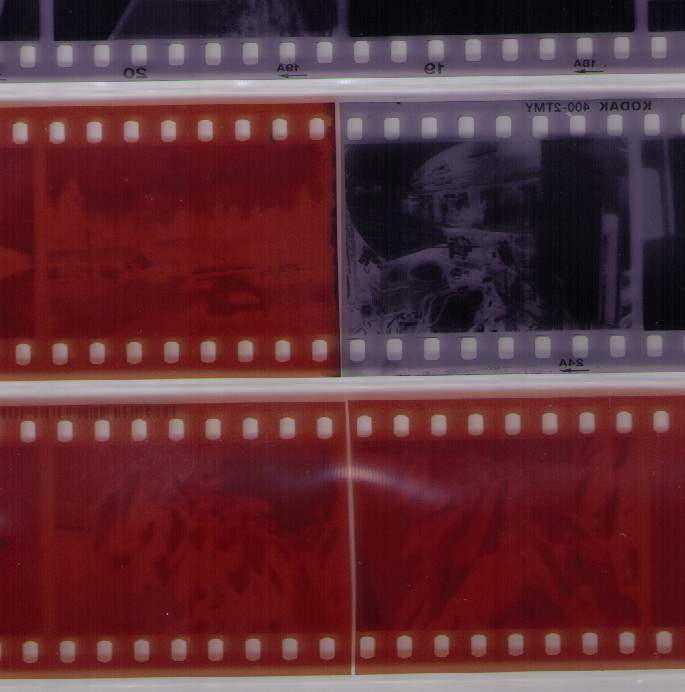

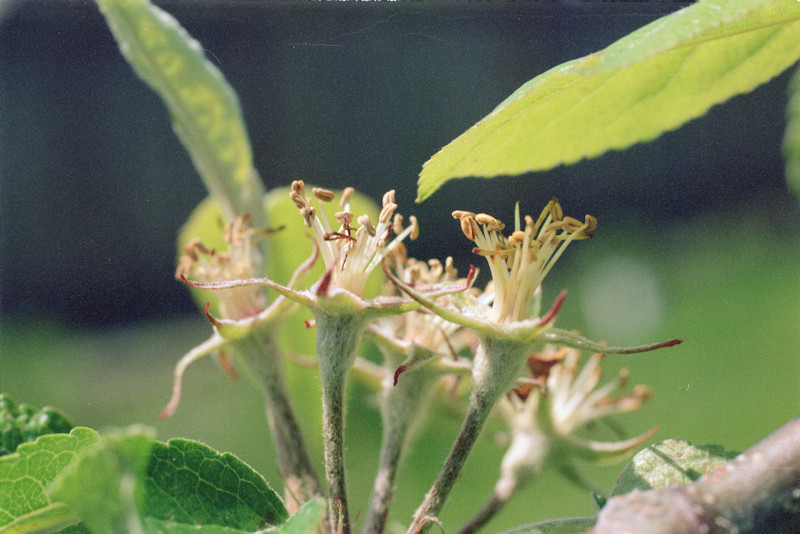

....and we've hit the end of the line. Developed some 50D last night, and I can't believe how thin the negatives are! (The scanner darkened them somewhat, but along with my admittedly over-developed TMAX-400 you get the point
However! ..
Look at what my scanner was able to pull from them:
Detail at 3600 DPI
Color accuracy is still impressive:
I also developed a roll of 500T, which I've yet to scan. Looks just as thin.
That's 14 rolls, or, 12 uses with great results. I don't know if it's weak due to age, use, or (probably) both. I mixed this in last October was it? 7 months!
In the future, if I purchase it again I'll try to use it up in <6m and stop at 12 rolls. That's a bargain for $50. Thanks QWD!

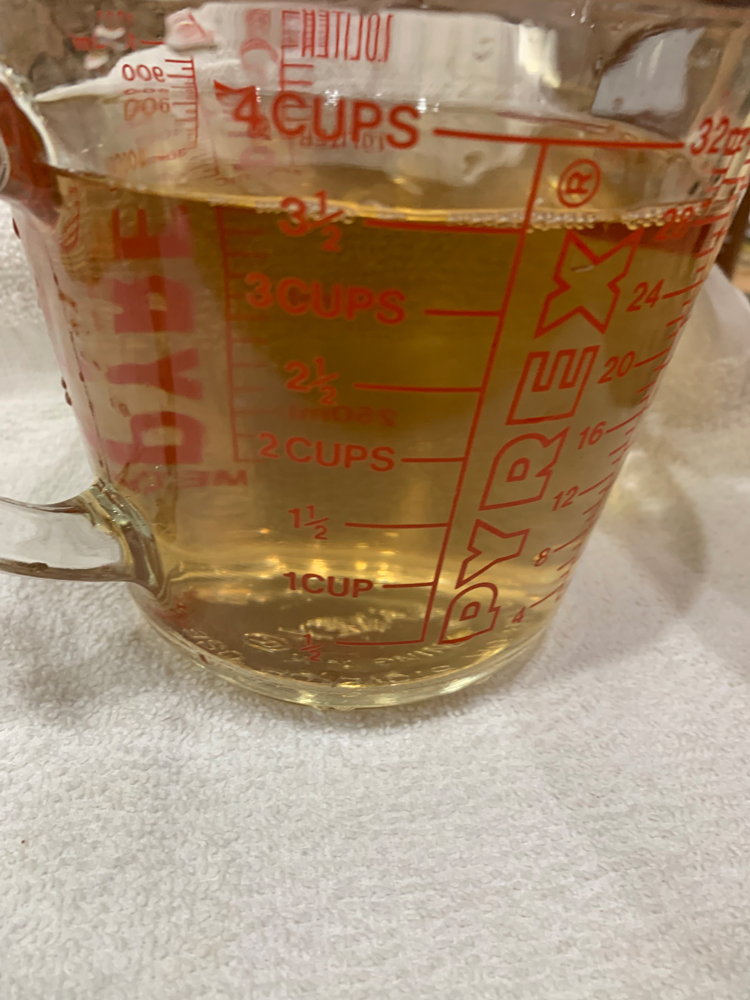

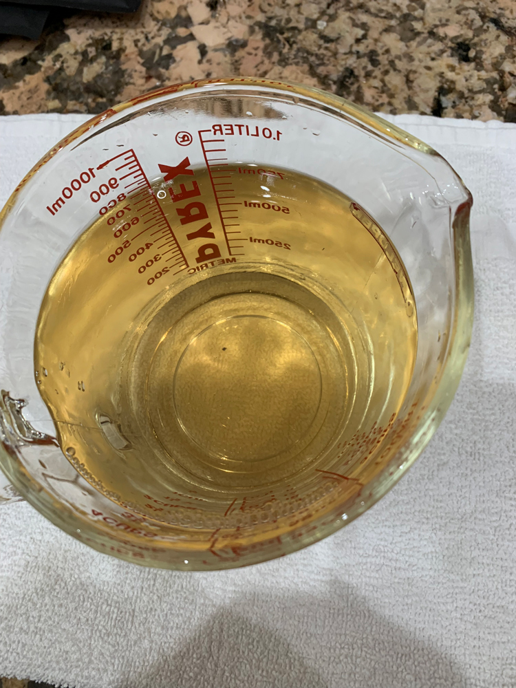

I mixed up my new kit this weekend. I purchased it in January from Freestyle and I'm wondering if I let it sit too long. The developer had about 1/2 teaspoon of brown flakes and looked like this after running through a coffee filter. is it any good or do I need to start over with a new kit?
Brad Deputy
Feb 23, 2021
172
Martha Lake, WA
Same thing happened to me as well. I ran it thru a coffee filter to remove the flakes. It didn't seem to affect the performance.
I read somewhere else that if you keep stirring, they'll eventually dissolve. I guess they're oily?
