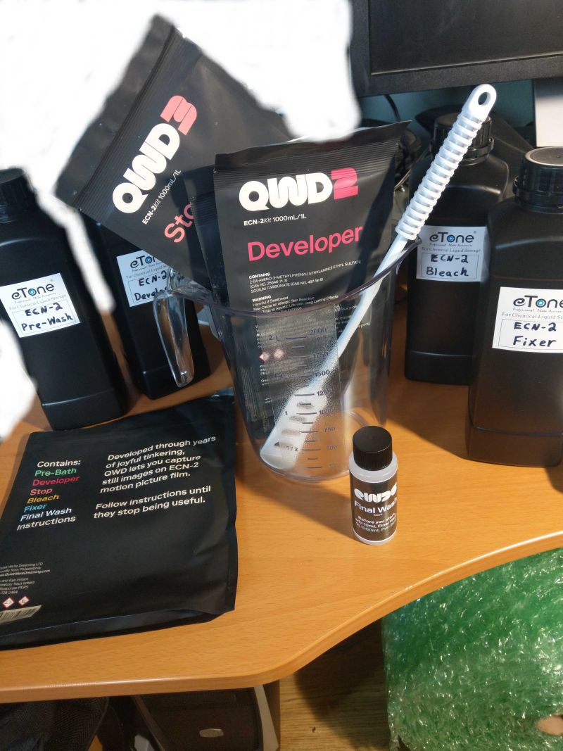

What do you mean by '2 in one' is this a two step developer?
Dev+Prebath, I have no clue if that matters.
I never used it any other way than just dev and fix, no stop or bleach. Very simple.
"It is specially formulated without compromise for modern color films, not requiring a stabilizer bath. Modern emulsions were designed so that one-hour photo labs wouldn't need haz-mat training for formaldehyde, and have built-in dye stabilizers and hardeners that are released through the simplified 2-bath process. You can have beautifully developed, bleached and fixed color negatives, ready to scan or print. All you need is water, a thermometer and any simple tank and reel system! "
