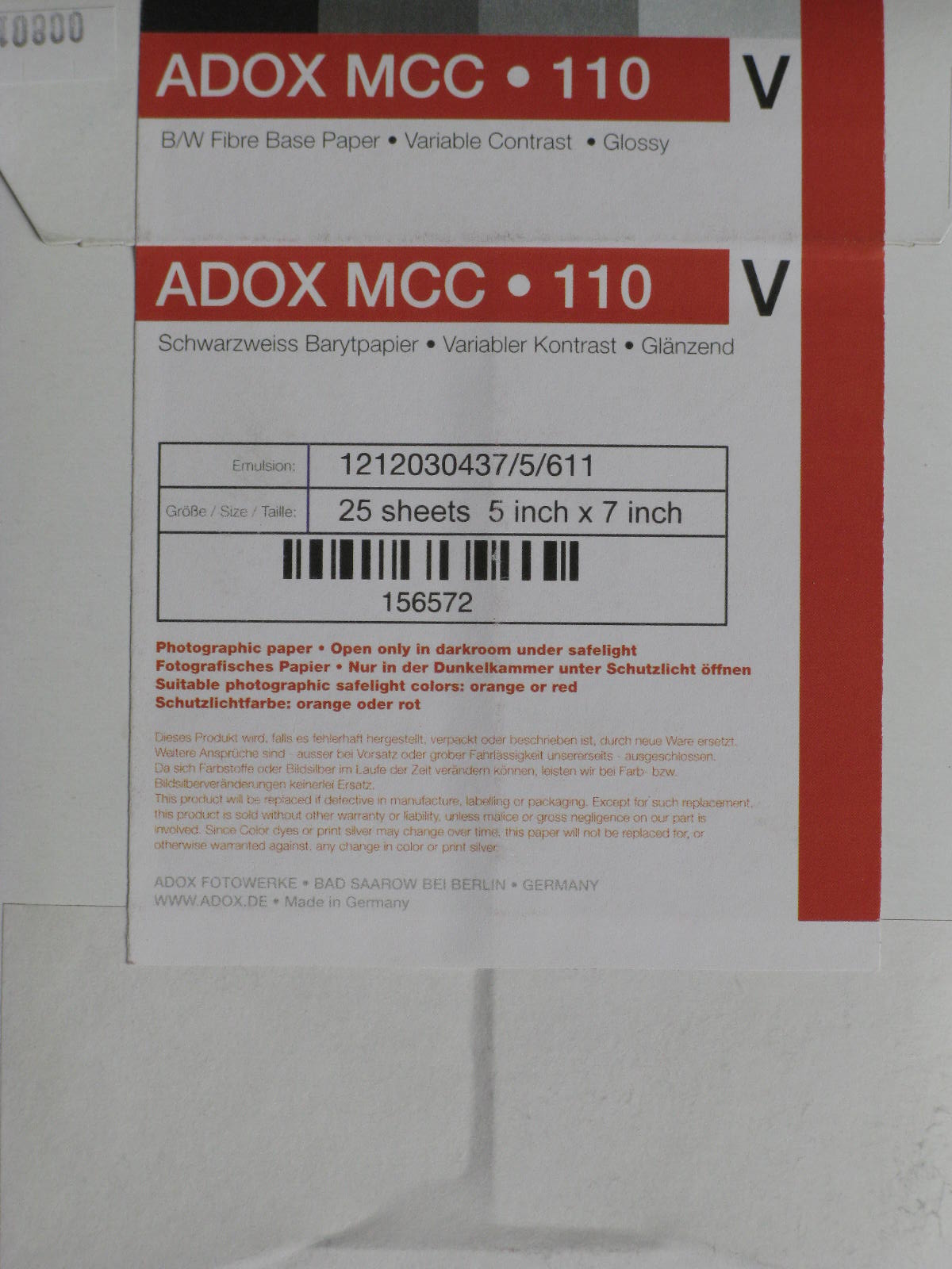

Thanks Mirko. I've attached a picture of the label to this post.
Freestyle had shown that and the 5x7 MCC 110 I also ordered as "In Stock" when my order was placed. The shipment received yesterday included only the MCC 112, along with a backorder notice for the MCC 110. Then they apparently found some in their retail store, because today FedEx returned with the other paper. It too has no production date on the label, which I've also attached a picture of. My suspicion from March of last year (see post #35) must have been well founded, if the 1212030437/5/611 emulsion number similarly indicates manufacture during 2012. :smile:
This paper has not been (finally) packaged by us. These are emulsion numbers from the 100 sheet packs. Freestyle has a room where they can repackage paper from 100 sheets to 25 sheets if they get more orders for the small quantities and have the bigger packs in stock. In this case the repackage it and apply a new label (rather than have you wait 6 weeks to pull more product from Germany).
it´s a special service they provide.
You can tell by the barcode not being ours as well but the internal Freestyle product number. Everything is corect though since this emulsion number matches the original 100 sheet packs.
I guess you can tell them if you do not want this or you just ask us for the production date.
