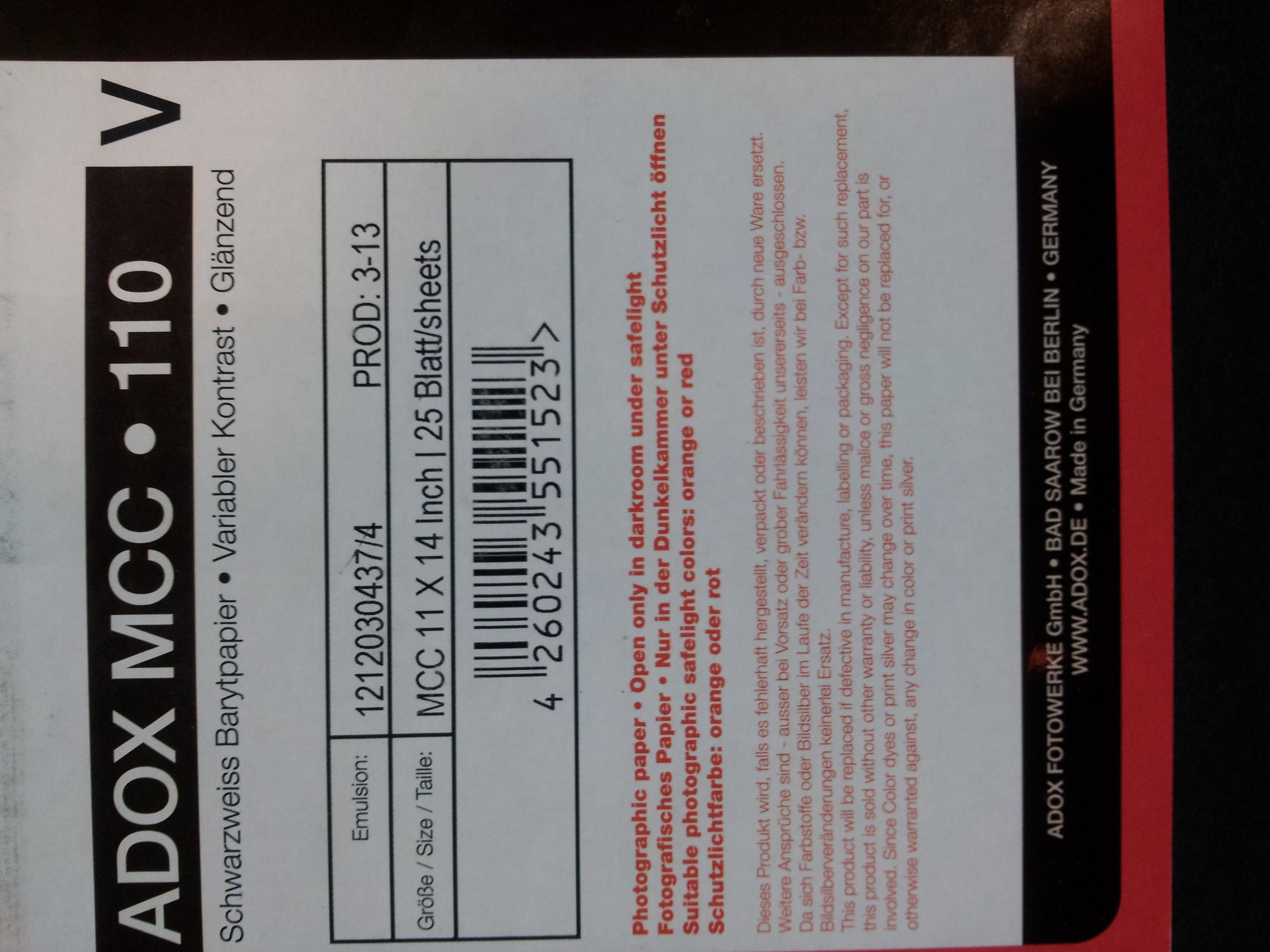

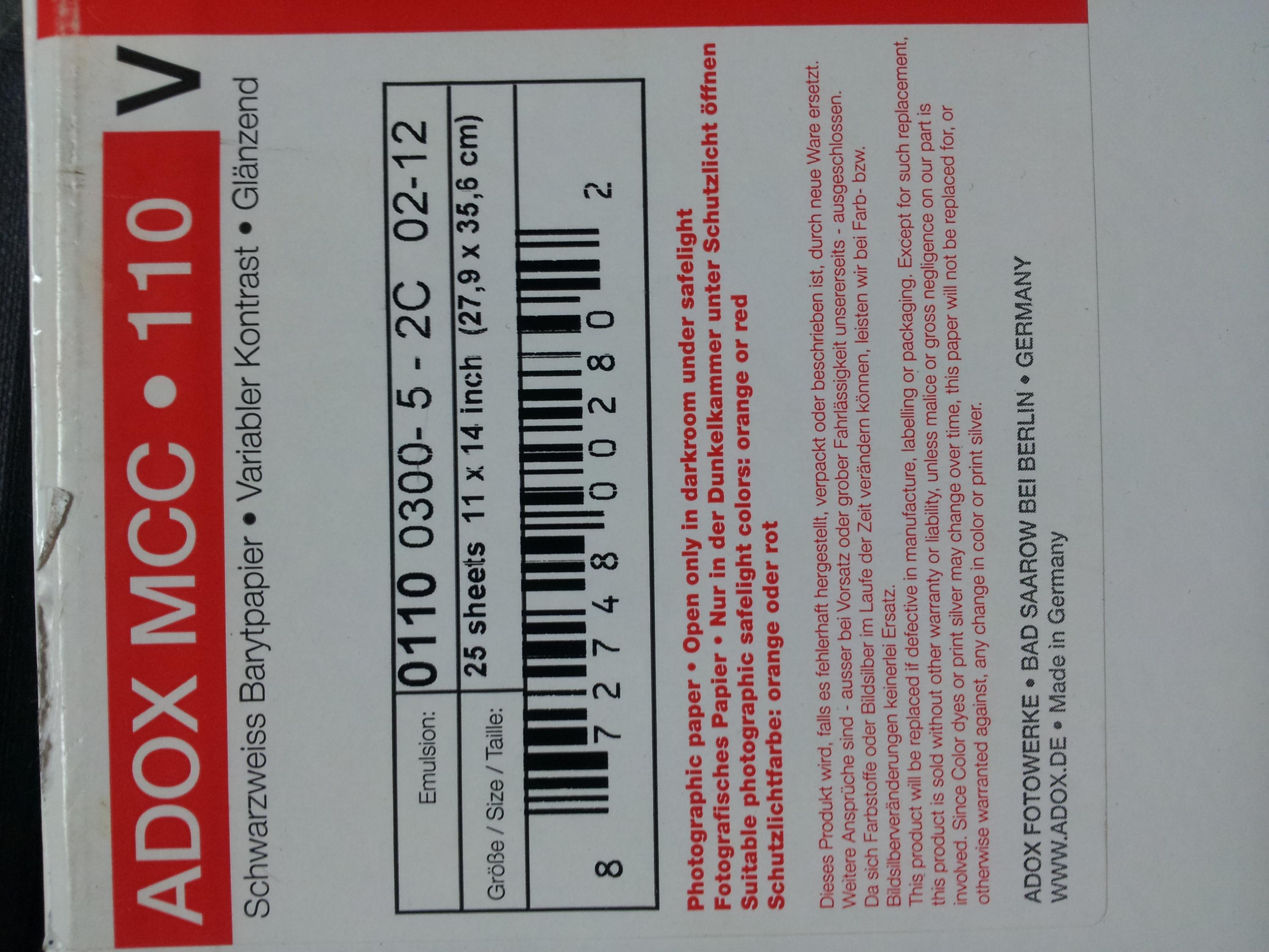

I have been using Adox MCC 110 for a few years and I have recently noticed some serious change of its characteristics.
It used to come with White boxes (I assume it's until beginning of 2012) then it changed to Red boxes(paper is same as one in white boxes though), then again, it comes with same red boxes but the description of the emulsion code (which you can find on the back of each boxes) looks in very different way. You can also find the production date on the right side of the emulsion code according to an instruction of MCC; "5-12" means "May.2012" for instance.
Anyway, I happened to get some batch which was manufactured in and after Jan.2013 from Freestylephoto and Fotoimpex someday and that was a total different paper from what it used to be. I printed both of new and old one at the same time;with same negative,same exposure and same developer, and anyone on this planet could tell the difference between them. I wouldn't say it's because of fogging or manufacture's failure as they're very consistent within each batch (even with different sizes).
As long as I experienced, the new one has much more contrast (old one can't get same contrast of new one even with two higher grade), more warm side (more controllable with a choice of developers), a slightly brighter surface (it also happened to Ilford papers by the way) and response better in Selenium toner. I personally much prefer the new one because I used to have problems with old one; it's sometimes very low contrast (even with a condenser head and Agfa's contrast filters), it couldn't get any warm tone regardless of developers or not really change in Selenium.
Now I'm having a trouble with making sure that I would get a new batch from Freestylephoto as they still have both of new and old batch in stock. I was told that It'd be very time consuming for them to find some specific batch from their huge warehouse so I would have to order more than 5 boxes of same size if I wanted it. Fotoimpex, on the other hand, seems to stock mostly new one (The last time I ordered 12x16 from them, I've got a new one).
So I keep asking myself if I am the only person who faces this problem.

The reason why we print emulsion numbers on the boxes is to make it possible for the user to buy from one batch (in order to print a series with the same settings) and to track claims (if they come up). The reason why we started printing the production date is because customers asked for it.
The observed changes in packaging are due to the implementation of the above and changes in confectioning (now done in house since about 2 years).
So if you prefer one emulsion number over another you can ask your retailer for this service and will find all informations on the box.
As far as I have understood Freestyle does not refuse to do it, neither will Fotoimpex.
So the question really is now: Where is the Problem? ;-)

There are always noticeable diffenreces between papers from a new batch and an older batch. No matter which manufacturer you compare.
This does not mean there is no batch to batch consistency. If you (could) compare fresh batch to fresh batch no differences would show but you can´t.
Our competitors decided to harden their paper less which gives the paper a higher end grade. We decided to pull even on the last production.
So if you compare the batches you shall see a higher contrast with high filter values (because the older batch has by now fully hardened and then the gradation comes down) but you should not see any other differences apart from the fact that now you cannot dry the paper on a hot press anymore without using hardener in the fixer. But then again things like lith-printing or selenium toning are not part of the standard testing procedures so if he sees differences he does not have to be wrong.
Our standard tesing procedures are the same ones Agfa used in the good days. We can´t go even beyond this level under todays circumstances. No manufacturer gives a guarantee for identical lith or toning behaviour.

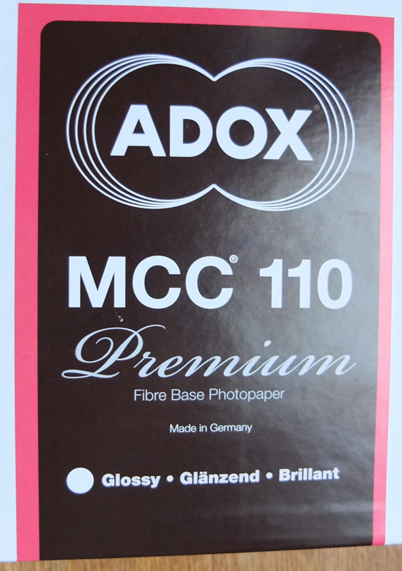

When I first saw this thread I wondered where the red boxes had come from because in all the U.K. retailers' pictures of both Adox MCC 110. and the RC MCP the boxes are white. It may be of course that they have now switched to red boxes but have not bothered to update the pictures of the Adox boxes. I just don't know
What concerns me is that there seem to be the problem with the white boxes as highlighted above and that maybe the U.K. retailers are still selling their white boxes until their stock is exhausted so anyone buying it will find the same problem
Can any APUGers based in the U.K who use Adox paper either MCC or MCP say whether they can now buy the red boxes and have they noticed a difference between the white and red boxes?

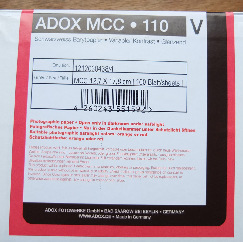

I received a box of MCC110 5x7" 100 sheets this morning from Fotoimpex in Germany. Box is white but label is black with just border in red. Emulsion number but no production date at least as advertised on Adox website. Can somebody tell me about production date of that one ? See pictures below.Adox1.jpgAdox2.jpg
That confusion should not have happened if Adox had added just a note on a sheet of paper put into the box after changing the emulsions. With processing chemicals one is always advised to follow the latest instructions delivered with the package.
Why not the same with photographic paper?
This summer I received two boxes of 9 1/2 X 12 inch paper with the identical emulsion number but completed with the caracters P-02-13 . I suppose that means february 2013. My boxes were red with black labels but I think white boxes are used for some sizes as long as they have them in storage. My papers were of the new and restored quality which means excelent.
Karl-Gustaf
