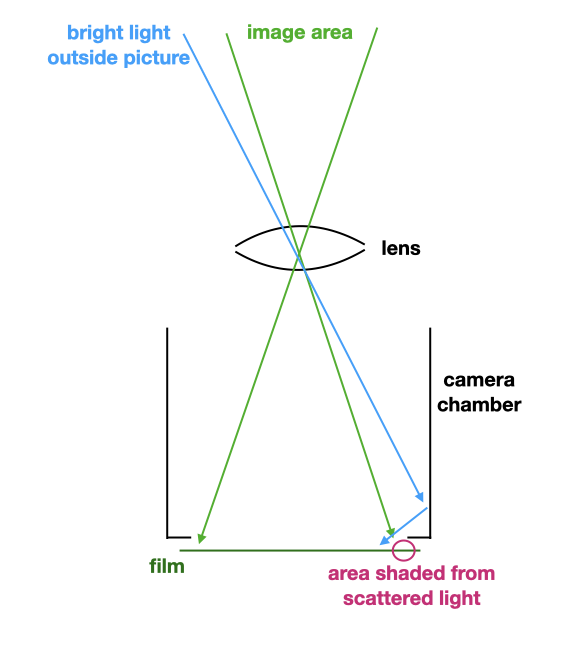

I received this from HB in New Jersey today. It looks like Photomultiplier was on the right track. It’s definitely the best explanation I’ve heard. Since it happens with an SWC and a 501, decaying black palpus isn’t the issue. I’m going to use a lens shade religiously from now on.
“A technician in Sweden had a similar response. He said it was light admission into the film back. Are you using a lens shade or shooting towards a light source when it happens? It’s possible the black palpus in the cameras are cracking and deteriorating. If that’s the case , it won’t absorb light. This can’t be repaired but we can still check the cameras to see if that is the case. Also, we can evaluate the film back to see if it’s because of an issue with it.”

For clarity, is my understanding correct that the thread has come to the conclusion that the shadowed area that we have heard about and partially seen is that part of the negative that has not been exposed to extra flare, while the rest of the negative has been exposed to that flare?

The thing casting the shadow is the film gate itself. The notches prove that. It's not an obstruction between lens and film. The question is, where is the extra light coming from. That is likely from outside the image, reflecting off the side of the body chamber. Here is a diagram of the suggested cause. This is most likely to happen when there's a lot of bright stuff like sky or sun outside the field of view. Use a more restrictive lens shade, shade the lens from the sun with your hand or the dark slide, etc.
Bingo.
This is why I ALWAYS use the lens hoods.

I might add that i even reproduced the shadow experimentally by placing a focusing screen in the film plane. The shadow was clearly visible when holding the
camera against a bright light. But it happened only at certain angles, that maybe explains why it occours only from time to time when the conditions are met.
One can try it with thin translucent paper held against the back of the camera and B setting on the lens.

So here's the question, for those who can see this in their negatives: what does the inside of their camera bodies look like? Is there like, a big chunk of missing anti-glare coating? Or is it more subtle?
Jul 21, 2021
183
Austria
Standard pre-palpas inner surface in pristine condition in an 500C/M from 1974. No matter how good the anti-reflection coating might be, the sun or probably even bright lit clouds are just very bright objects and otherwise low enough
reflection coefficients of the coating can be insufficient for such demanding conditions.
One of those cases where good practice is just as important as the gear itself.
The lens hood is designed to mask out as much from the image that does not belong to the frame itself as possible. Sure, it can not do it to 100% because the 80mm hood also says 60mm on its marking, so there might be a compromise.
I often just use my hand (or head/body) to cast a shadow on the lens aperture without interfering with the FOV itself. By doing that, the biggest issue (the sun) is masked out.
