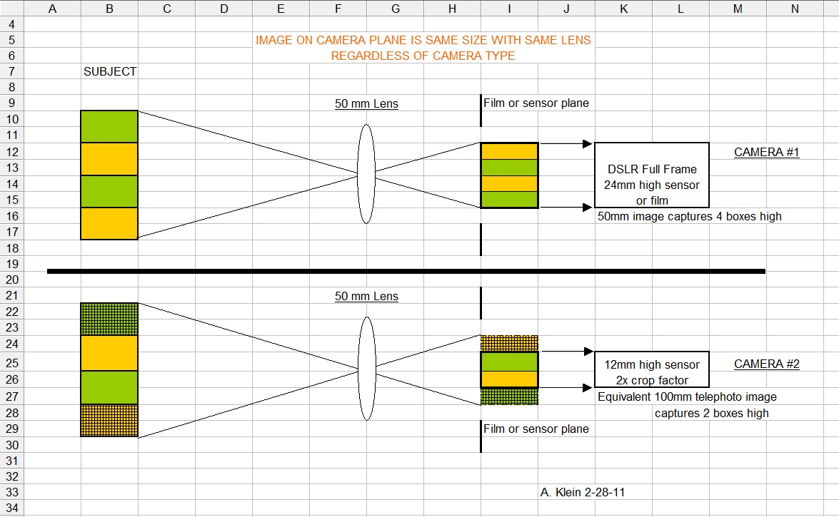

I put together this detail to explain crop factor.
And since 24x36 is actually a crop of all the larger formats, the 'crop factor' is proven to be a mental crutch for FL 'equivalence' to change from format to format for those unaccustomed to working in different formats. (I shot in 4 formats but never previously used any 'crop factor' -- except initially when going from 135 to digital APS-C...using the same set of lenses for both, which had never happened before.)
