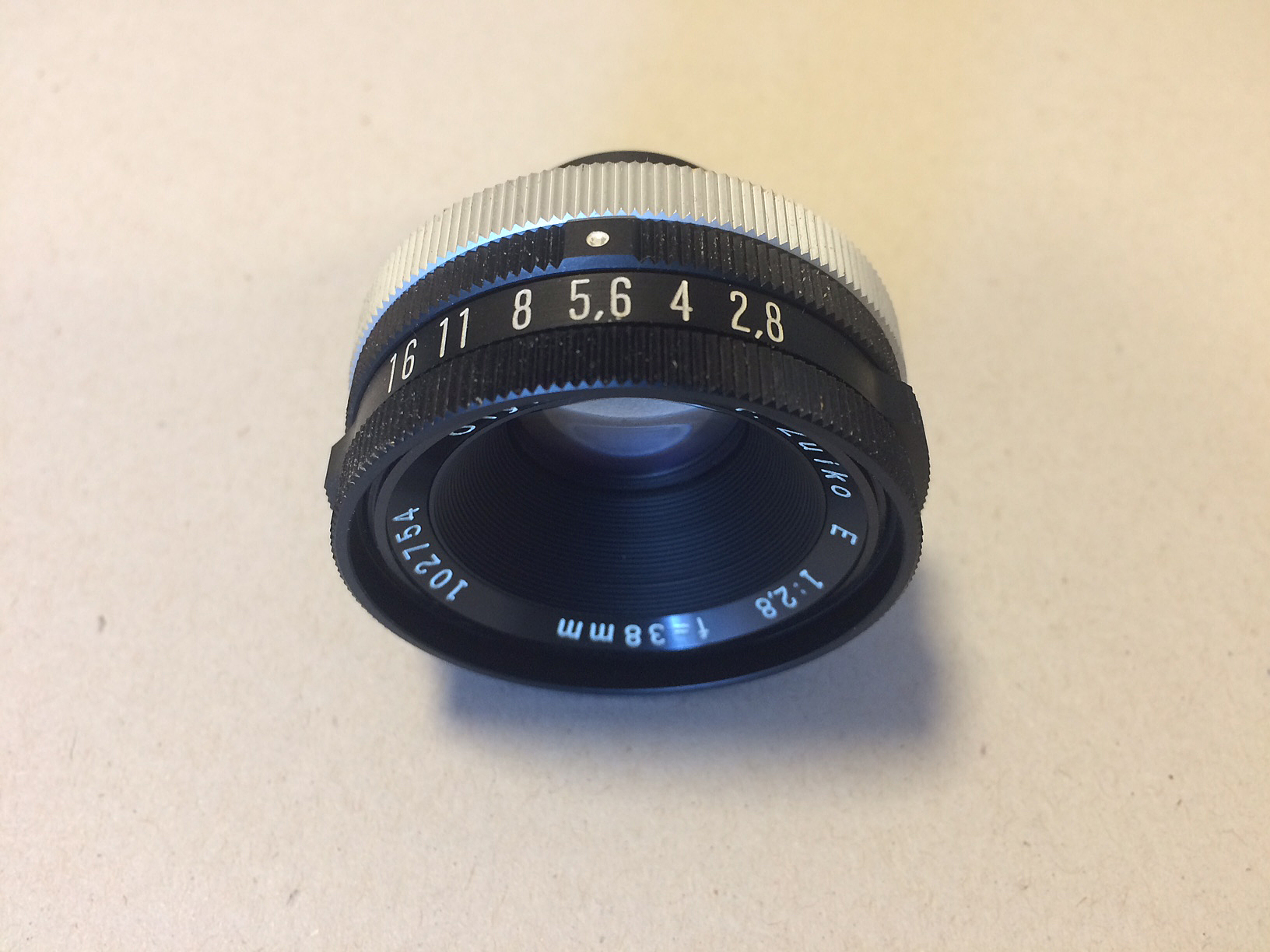

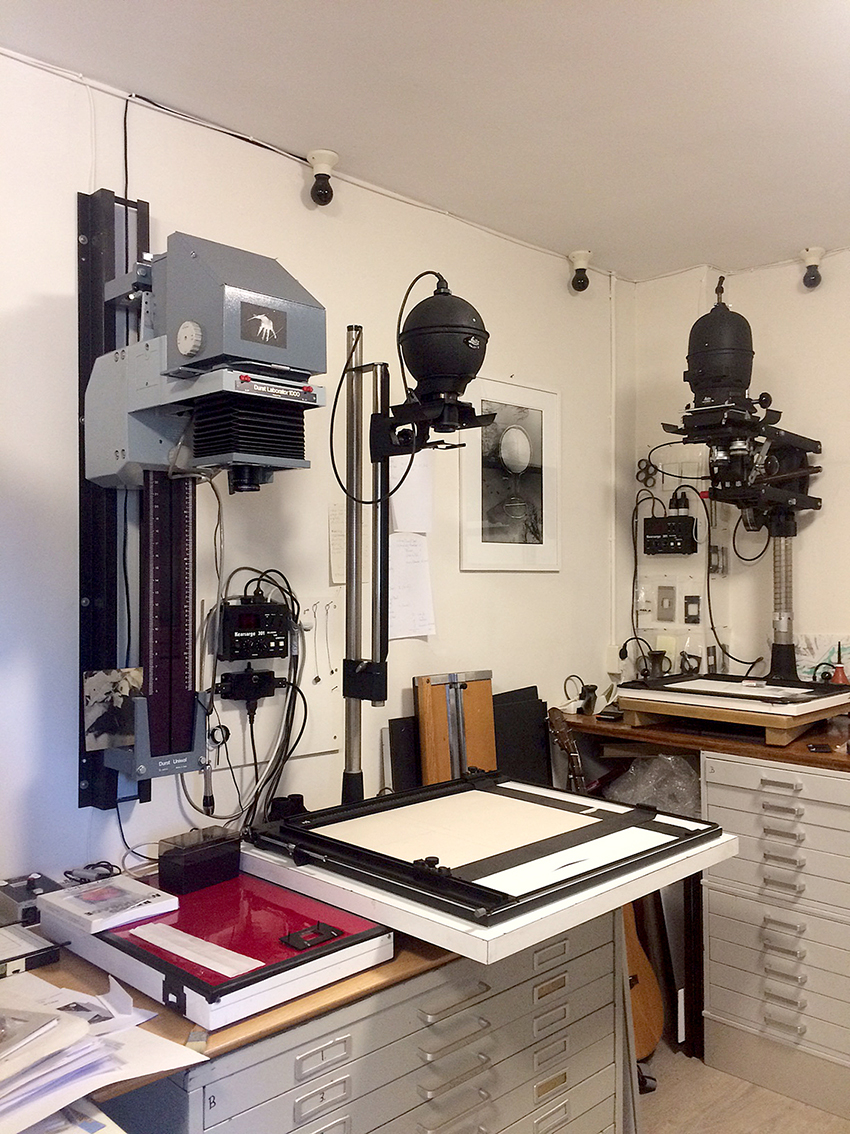

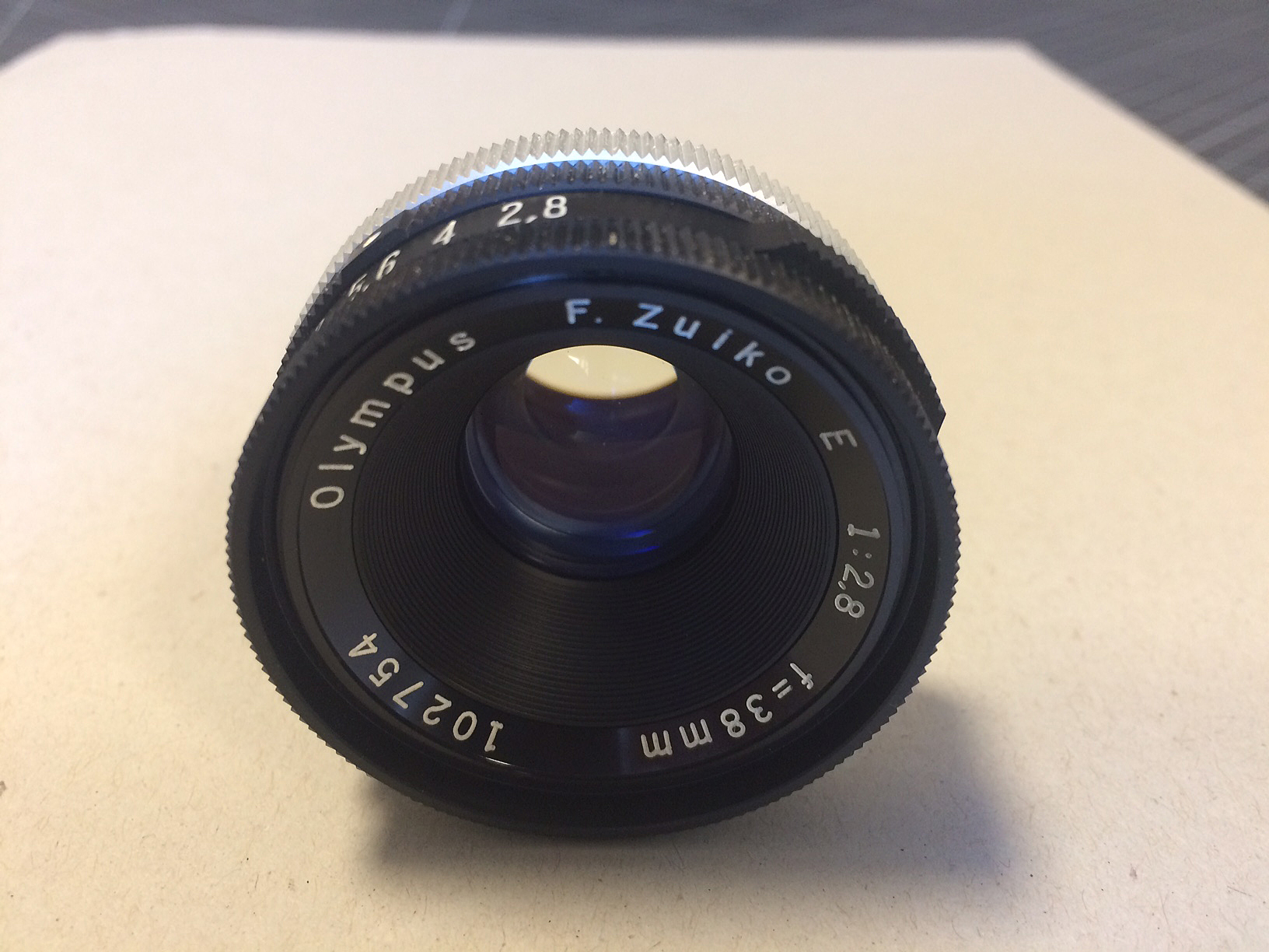

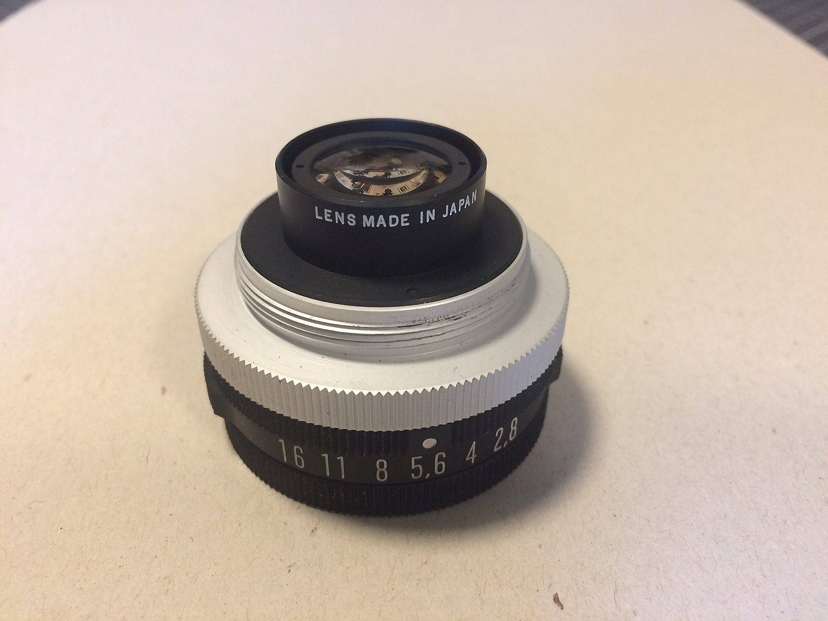

The reason for not using the Focomat Ic is that's it's automatic focus creates problems when using the 38mm Olympus lens. And the Valoy II gives much shorter exposure times because the negative sits closer to the light bulb. I attach some pictures of this lens, plus a data sheet Olympus provided with the lens.
Pictures below. The Valoy II is the enlarger in the middle and it is set up to do 50x60cm (20x24in) - from half frame using the 38mm lens
