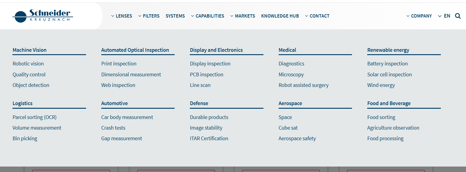

What would they be used for now? Who would still be making them?
For example, Schneider Kreuznach:
