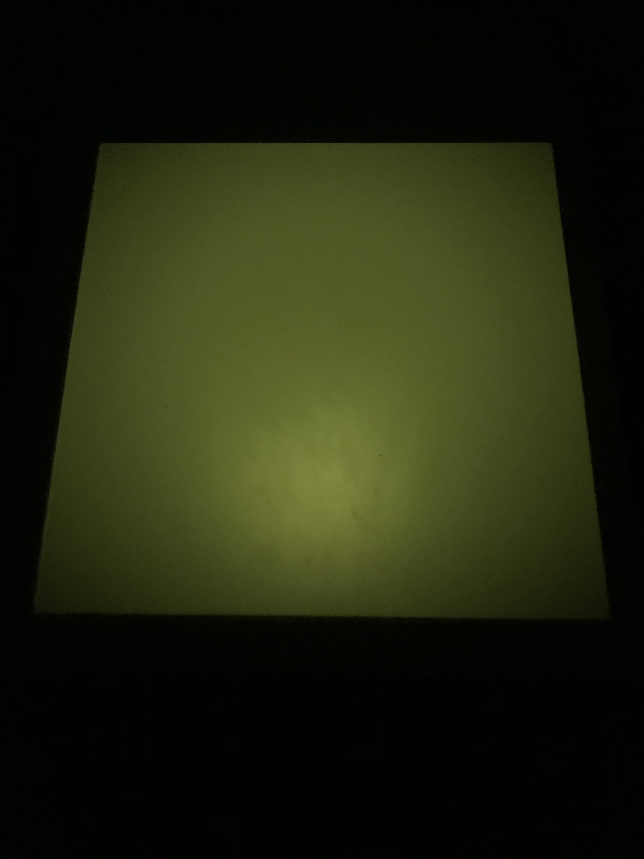

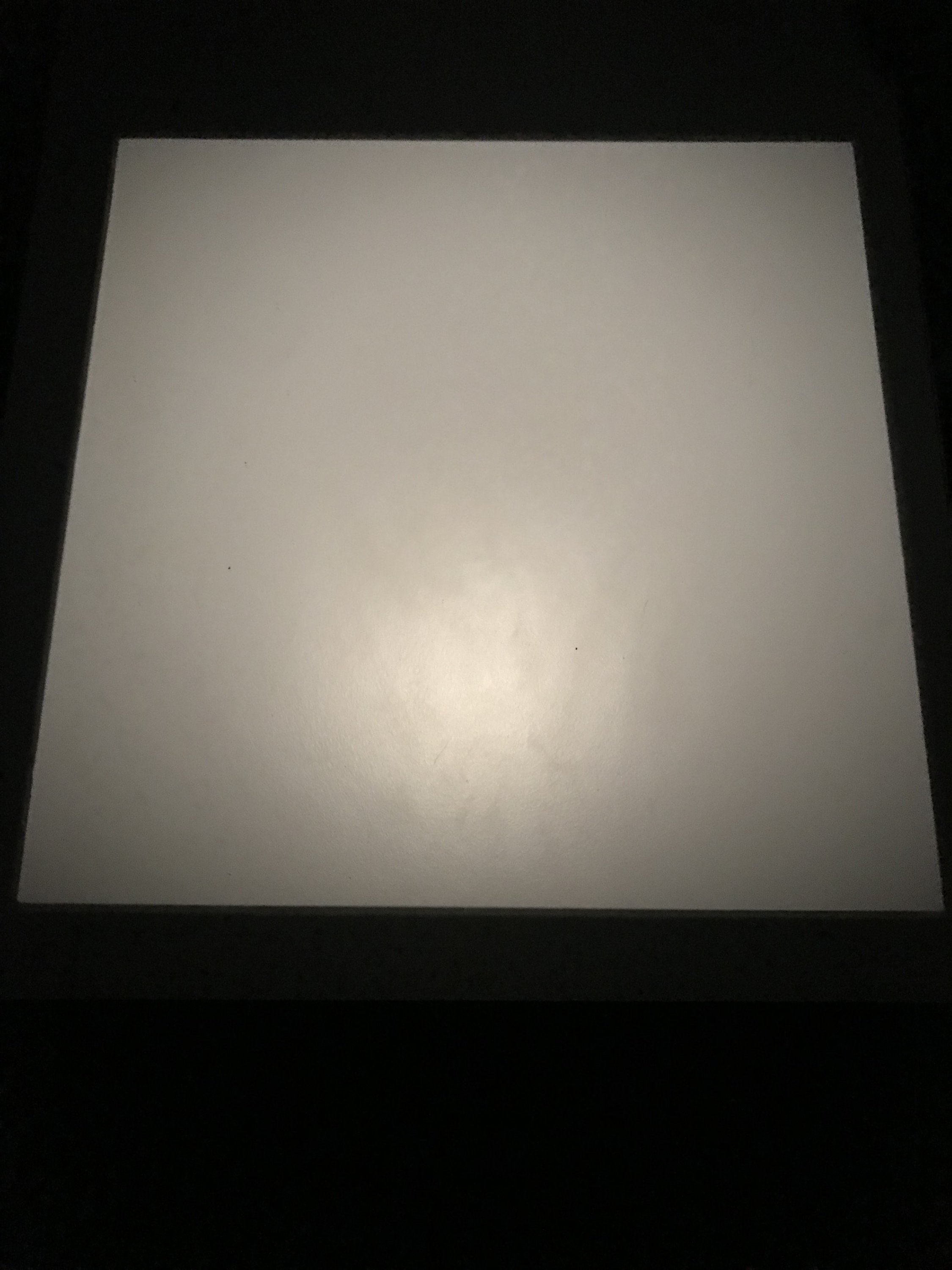

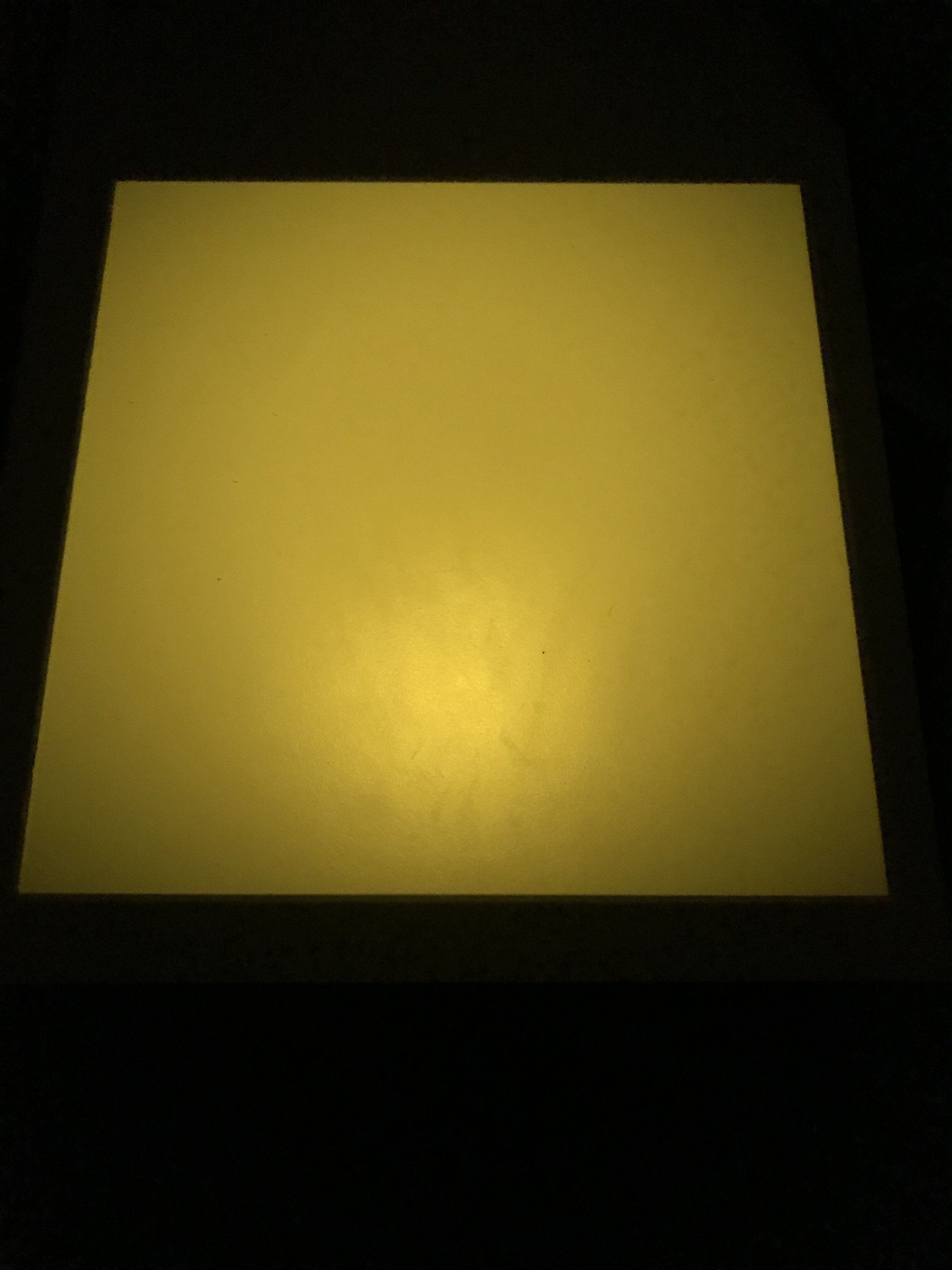

I recently got a Besler 23c iii with color head. I’ve made a couple of test prints and a few work prints. All of them have what I’m pretty sure is a hair through them. I first used the lens(35mm) that came with it and made a couple of test prints when I noticed the hair. It seems to be somewhere that it can move somewhat since it’s never quite in the same spot print to print. Bought another lens(75mm) and made sure to give it a good wipe down before setting it up. Tried a test print and still that hair showed up. Looked around and wiped off the diffusion panel(not sure if that’s what it’s actually called.)Then I made a larger work print which also has that hair.
Any idea of somewhere else this hair might be hiding other than the lens, negative, negative carrier, and diffusion panel? I'm guessing it's somewhere between the negative and the light source otherwise I'd probably see it. Don't really want to crack the head open searching for a hair. I am also open to the idea that it's not a hair since I am new to enlarging/printing.

If you suspect a hair, then assume that it is indeed a hair. Armed with that steadfast belief, then take apart any and everything till you found it. If you don't want to "crack the head open" and have looked everywhere else, then you KNOW where it is. Crack the head open, whatever you mean by that. I suspect that you are probably stopping your lens down to 8 or 11, which would give enough depth of field to focus on a piece of trash well above the negative plane. Just do it. That's the rules. Problems are alway in places where you'd like to avoid going.
Apr 14, 2016
814
Bavaria, Germany
Have you made a print with the lens wide open? If the hair also appears sharp on that print, it must be very close to the negative carrier. If it only appears sharp if the lens is stopped down, it might be somewhere around the lower part of the condensor / mixing chamber.
I´ve once had a hair stuck in the opening for the negative carrier. Drove me nuts, I cleaned the carrier 10 times, and never saw something when the carrier was not in place, but when pushing the carrier in, the hair got in the way again.
Give everything a good clean, look out for dirt that might move in and out of the light path, brush / vaccuum everything off, and you should get rid of the culprit.

That looks more like a crack then a hair. And it must be very close to the negative, so I would suspect the bottom diffusion panel on the colour head.

Take the lens off and put the negative carrier in without a negative. Shine a flashlight up from the baseboard and look up into the turned off enlarger to see if you see anything. Then, with the empty carrier still in and the lens off, turn the enlarger on and look up to see if you can see anything.
A mirror may make it easier to see up into the enlarger.

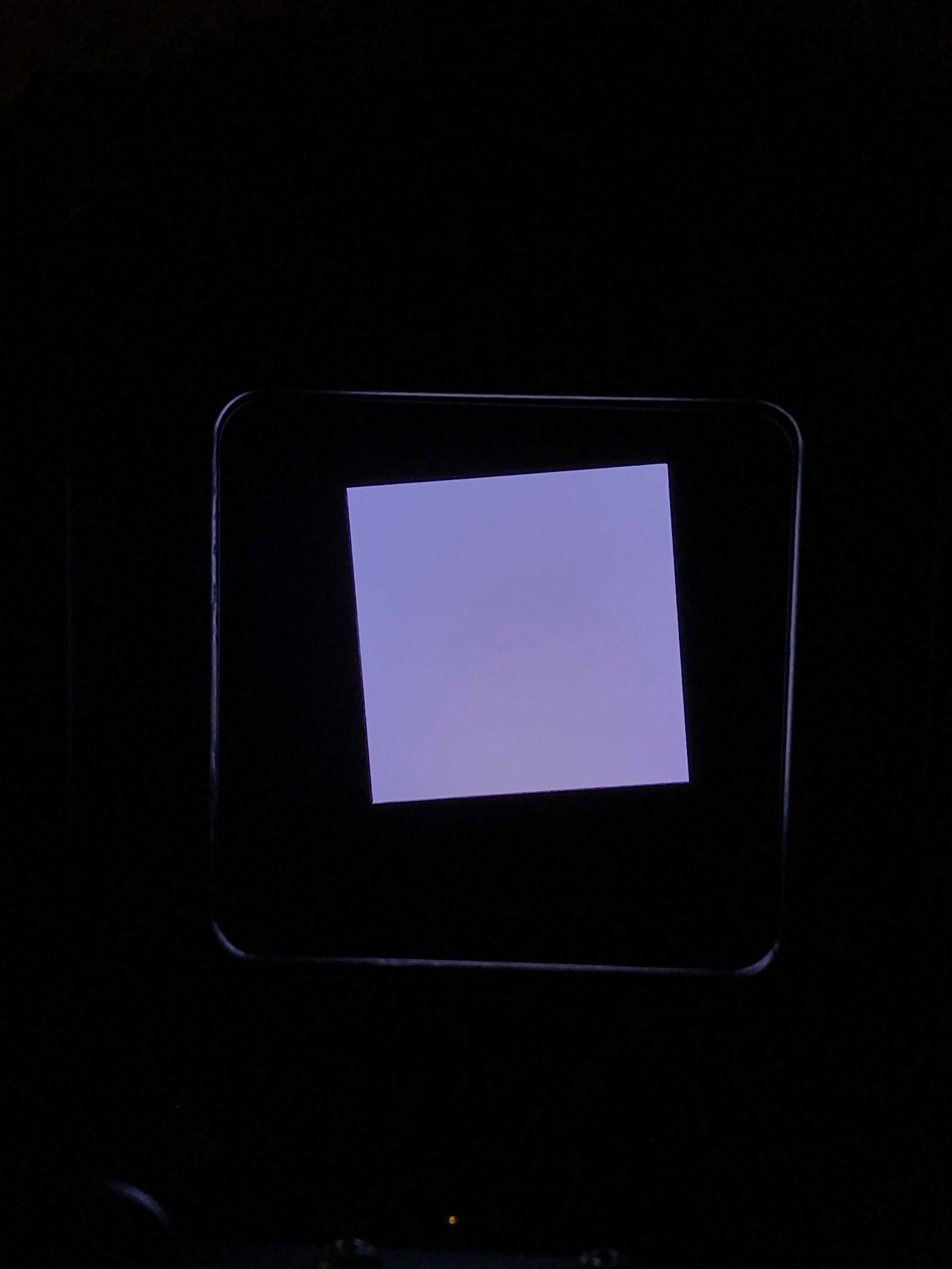

Gave that a try and didn't see anything. Not sure if this picture is worth much.

I'm tempted to say that I do see something - and therefore drive you crazy!
Is the fact that the light area is not square to the rest due to the fact that you haven't lined up the carrier squarely?
A further test is to put the lens back in but don't put a negative back in. Now turn on the light source (maybe with less magenta) and observe the easel as you move the focus up and down. Do you see any sign of the line appearing at any spot during the focus travel?
A further test to try when you are next printing is to do a print with the lens aperture set to its largest opening - f/2.8 or 3.5 or 4 or whatever applies.
If the line isn't visible in the print, that would be an indication that it is due to something which is not at or near the position of the film - it isn't within the depth of focus.

Gave the focus travel a try and still didn’t see anything.
The prints actually are at the largest aperture and with everything set to zero.
Would there be much point in seeing what happens without the easel?
