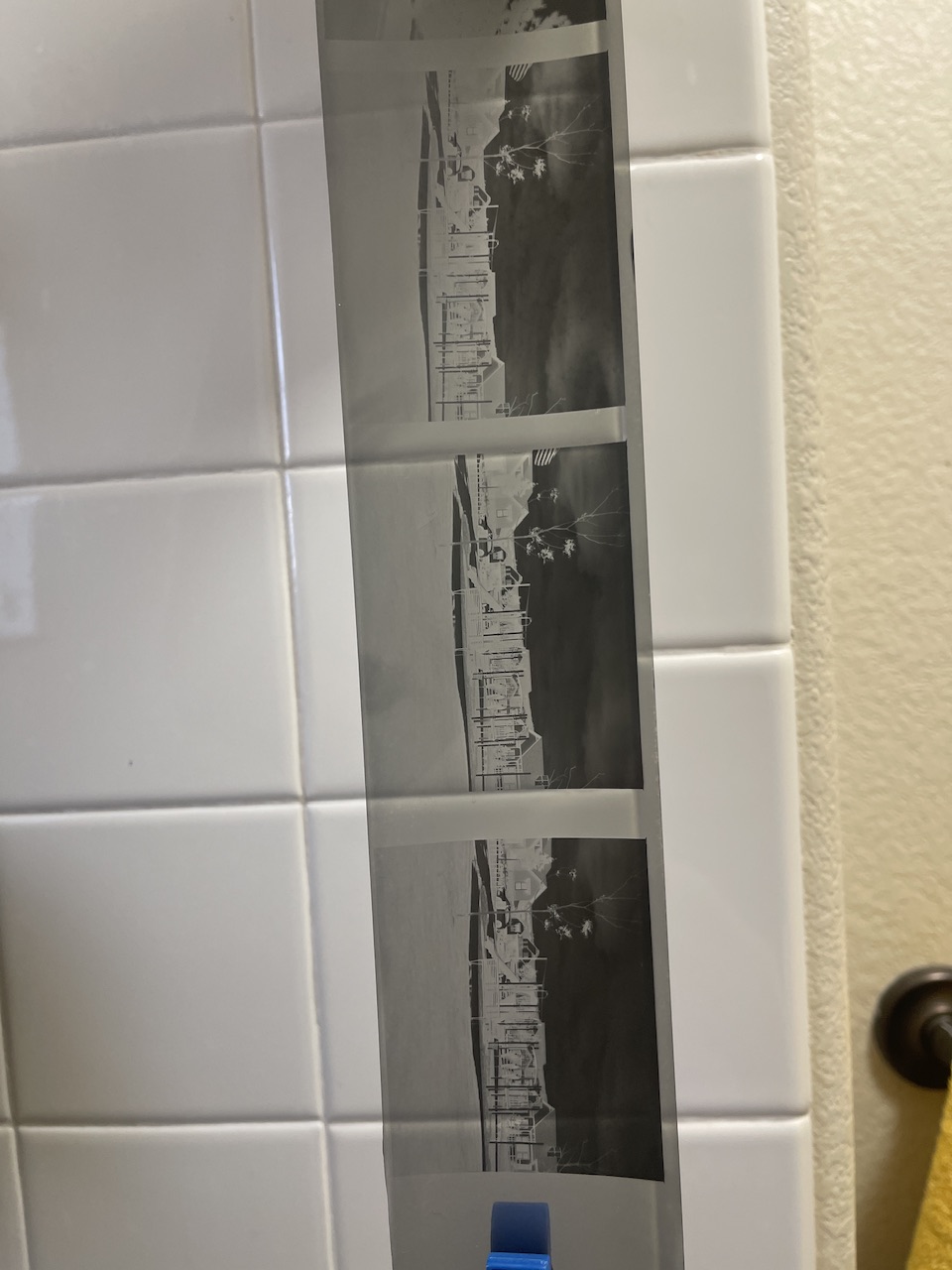

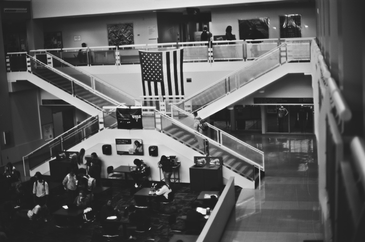

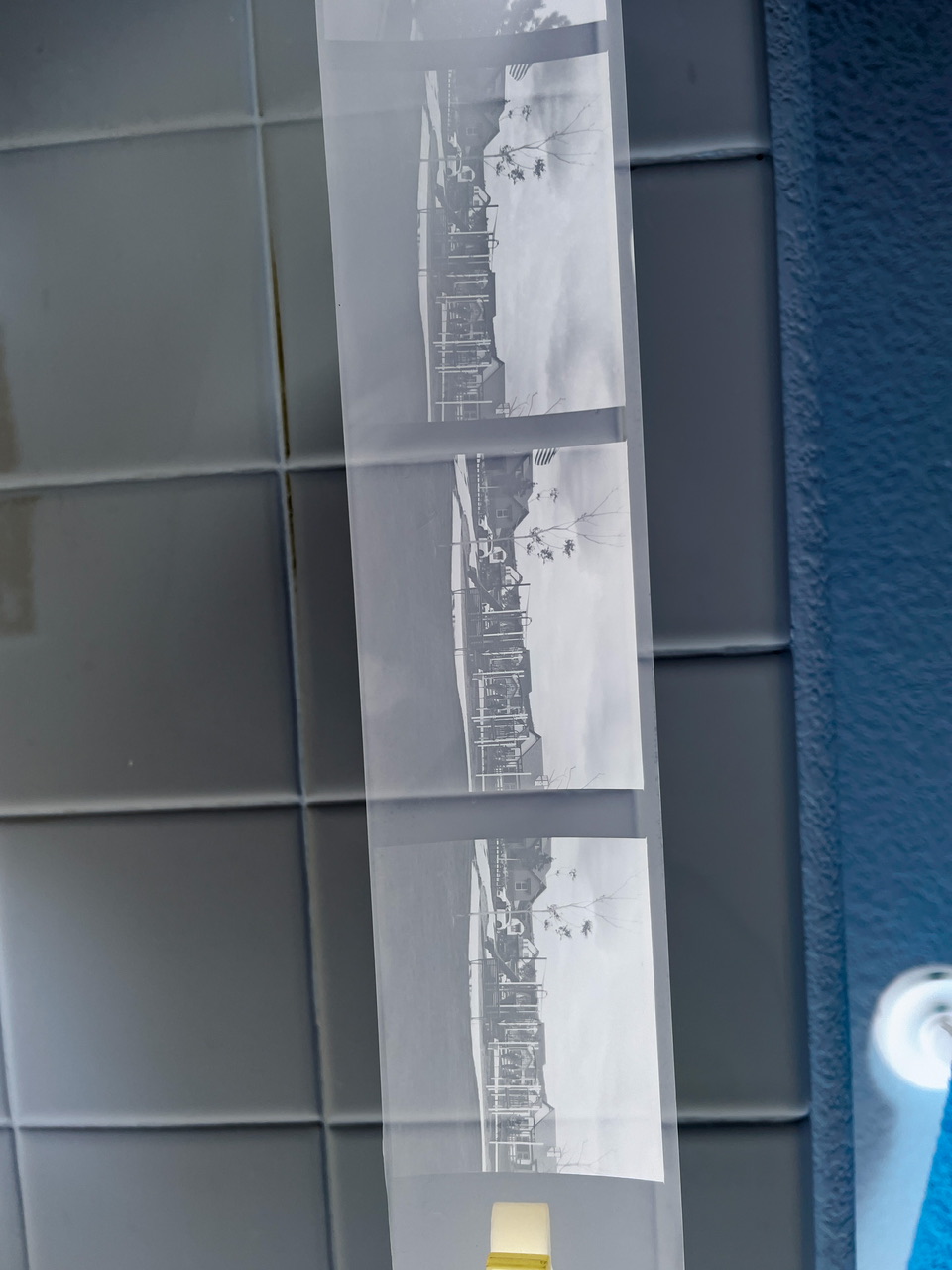

Bracketed exposures around EI 50 (middle), +/- 1/2 stops. Negatives:
Inverted image:
The part I exposed to room light, film is not fully black.

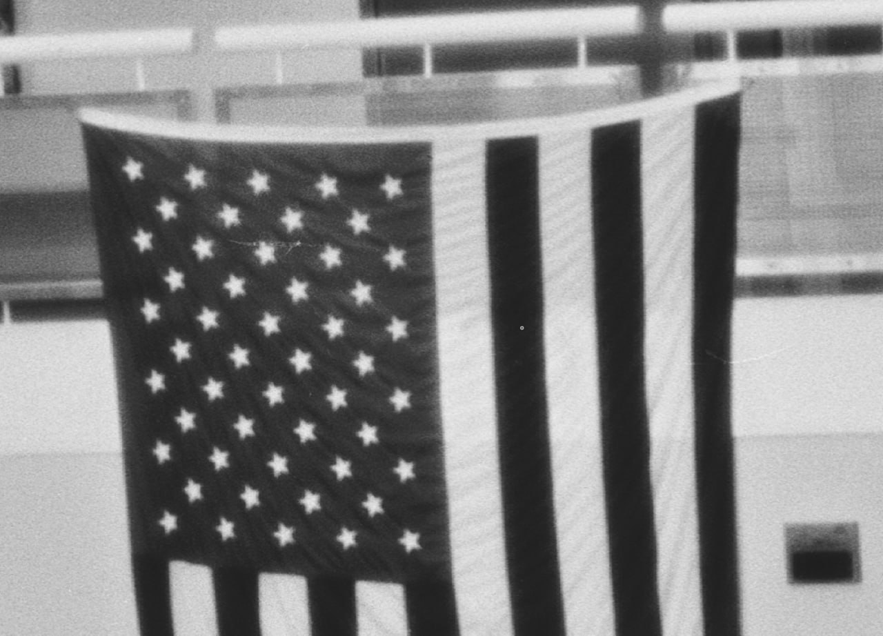

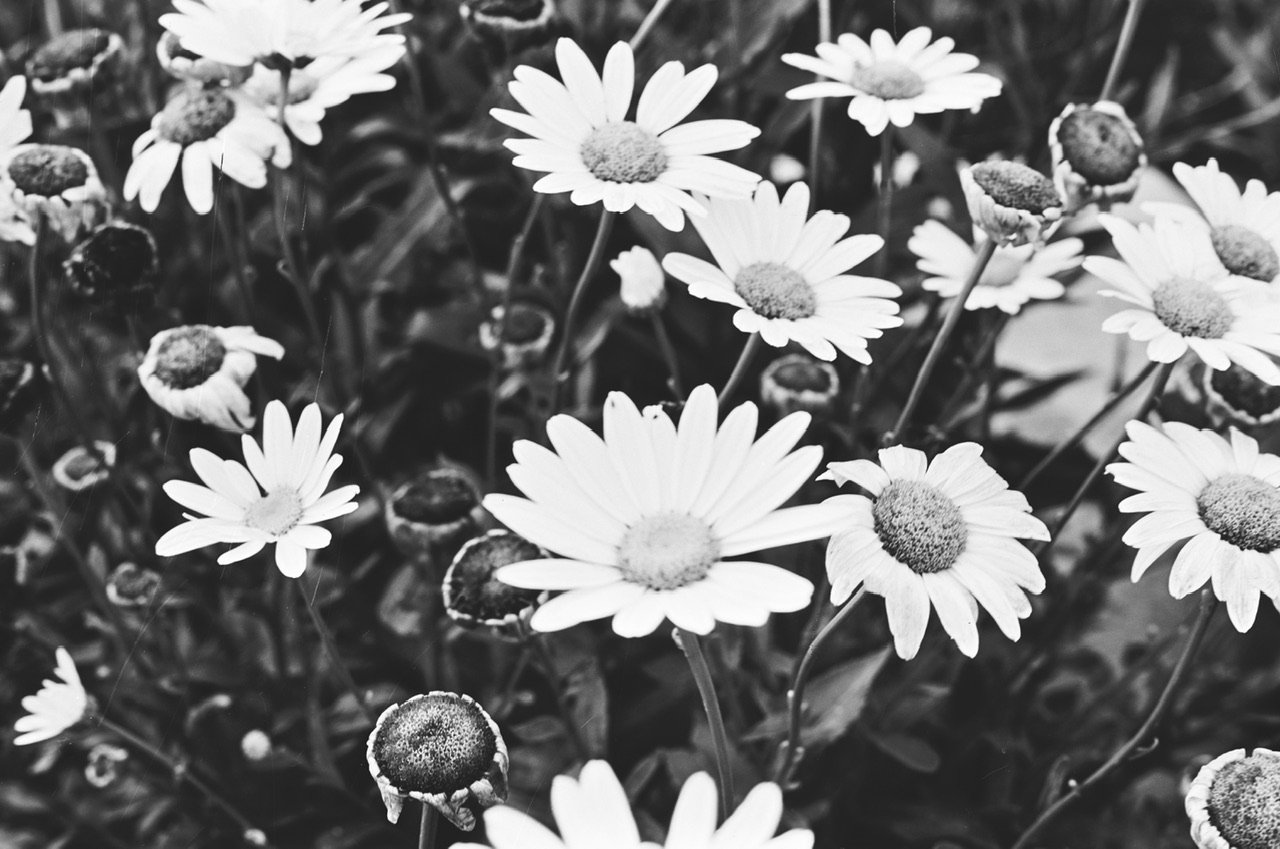

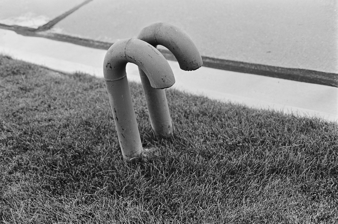

Well, I gotta say, Foto-32 and H&W control is an amazing combination. I think CMS 20 II and tech pan still have it beat in terms of pure resolution, but I wouldn’t say it’s by that much! And, it’s at a relatively fast speed too, especially compared to something like CMS 20 II. Maybe still a bit contrasty for some folks, but I will definitely be using this combination more in the future. I really like the look.
Cropped to 250% to show detail:

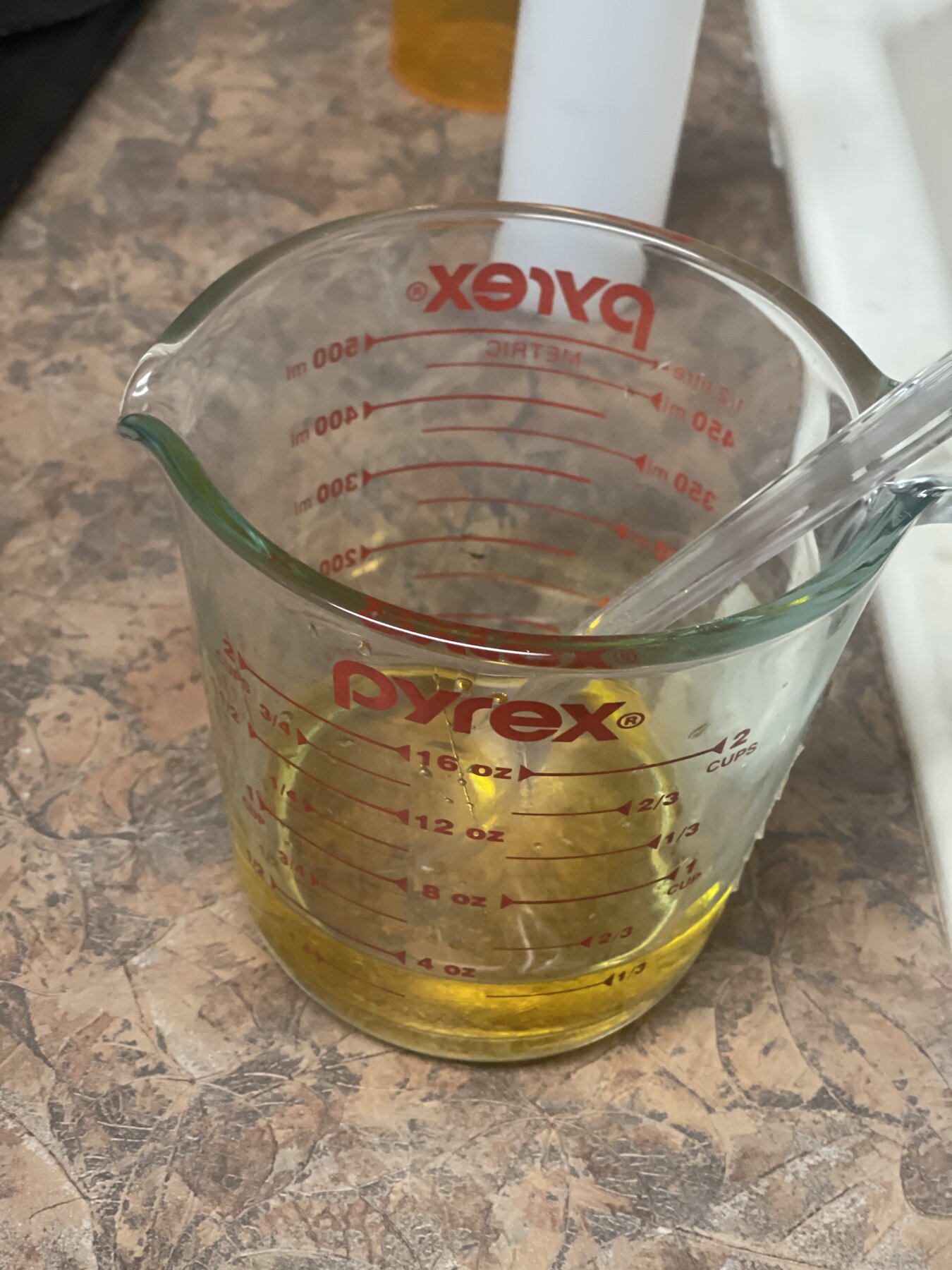

I do not like Phenidone… I was trying to get it to dissolve a little bit faster in the propylene glycol, so I put it in the microwave for a little bit… the solution turned deep orange. Which, I’m pretty sure it means that I oxidized most of it. So, I started over, this time putting it in the microwave for less time… it’s pale orange, which I don’t like, so I think I have to start over again… am I just being an idiot? Or is there some sort of tricks that I’m just not aware of?
pale orange
Wouldn't worry me too much. Not ideal, not catastrophic either.

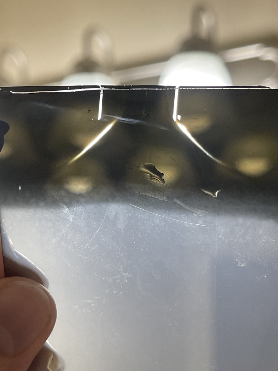

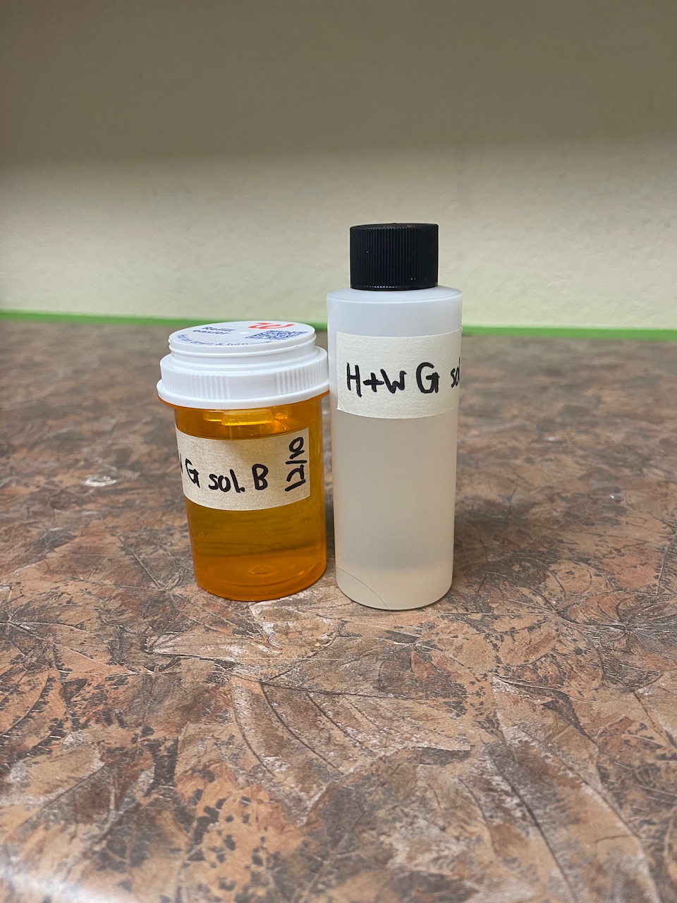

well, I mixed another batch of this up (finally), and… that’s not good. I don’t know if it’s the phenidone or hydroquinone, but one of them is definitely not happy.
Dissolve phenidone in methyl carbitol first.
Not sure what that is.

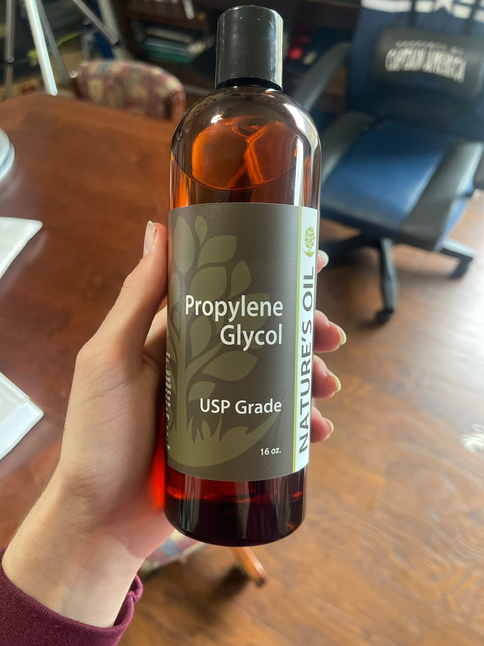

I believe that the problem is not the chemical powders, but the propylene glycol that I have. Apparently it is very hydroscopic and so it probably absorbed some water since the bottle it came in has a lid that doesn’t seal it airtight. Which is very annoying, but at least in theory it means the developer should still work, albeit the shelf life is no longer indefinite
OK, now this is really weird… The mixture is almost completely clear now, so I don’t know what happened.
