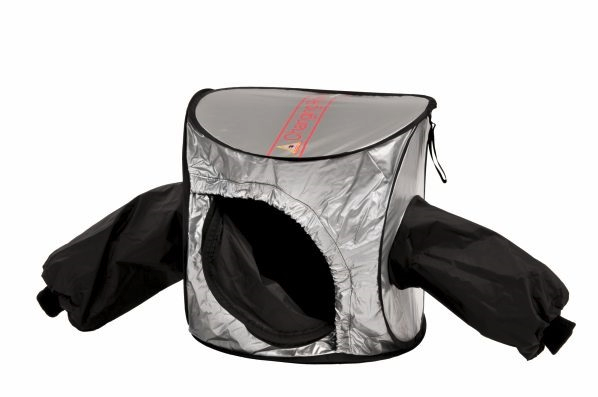

I think a changing tent works better than a bag although like them all it can be sweaty on a hot day. But like this one marketed by Calumet you can stand a Paterson tank upright in it, have all your reels and scissors and film arranged inside where you can easily feel for them, and it's less likely to harbour dust.
https://www.wexphotovideo.com/calumet-film-changing-room-bag-1629684/
When I saw the Calumet name I immediately assumed it was some old stock, since Calumet went bust in the U.S. about 10 years ago. When I looked it up on Wikipedia I found out that Calumet is still a going concern in the U.K. and Europe. They were certainly a well respected equipment supplier on this side of the pond, but how are they regarded these days on your side?
