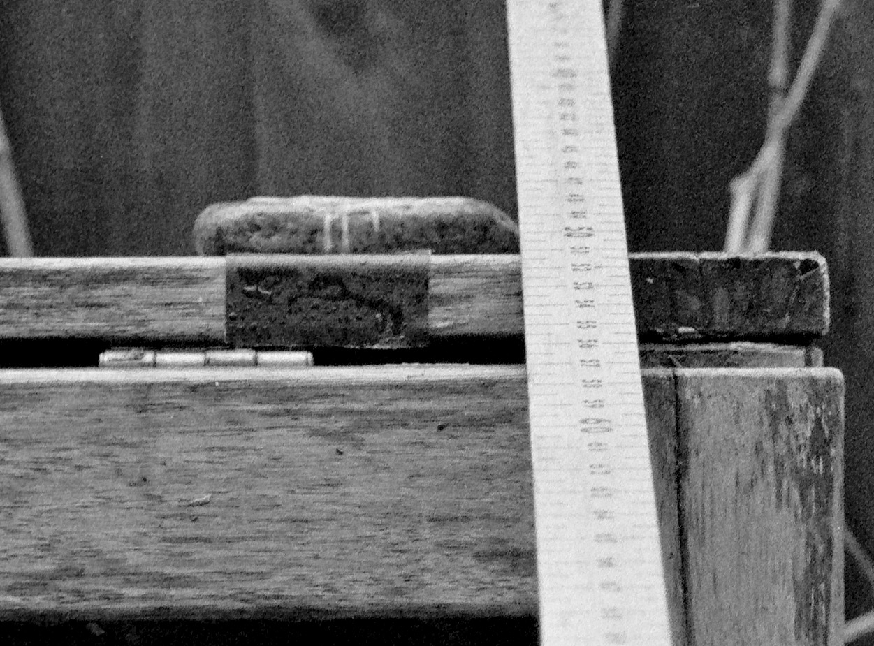

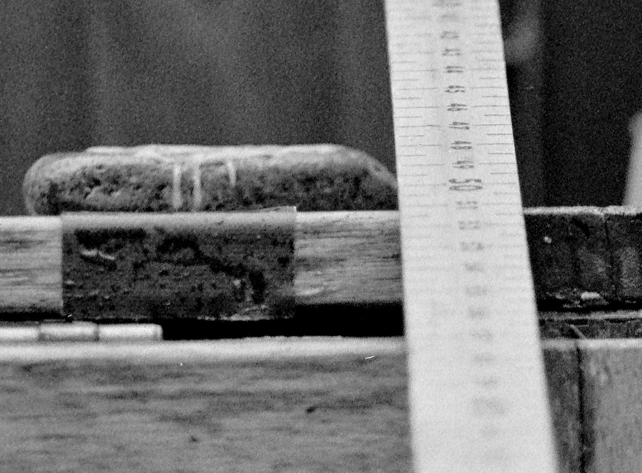

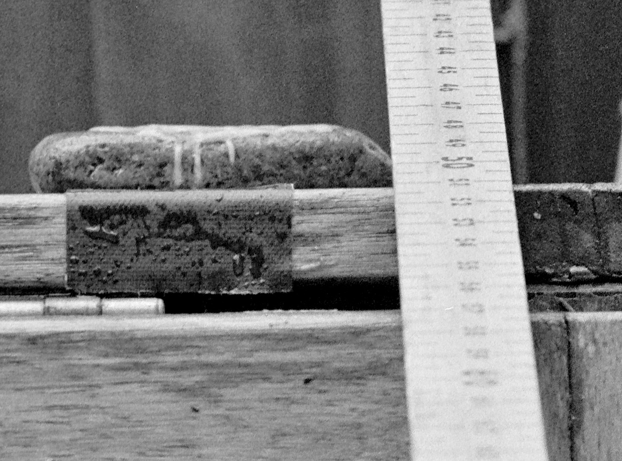

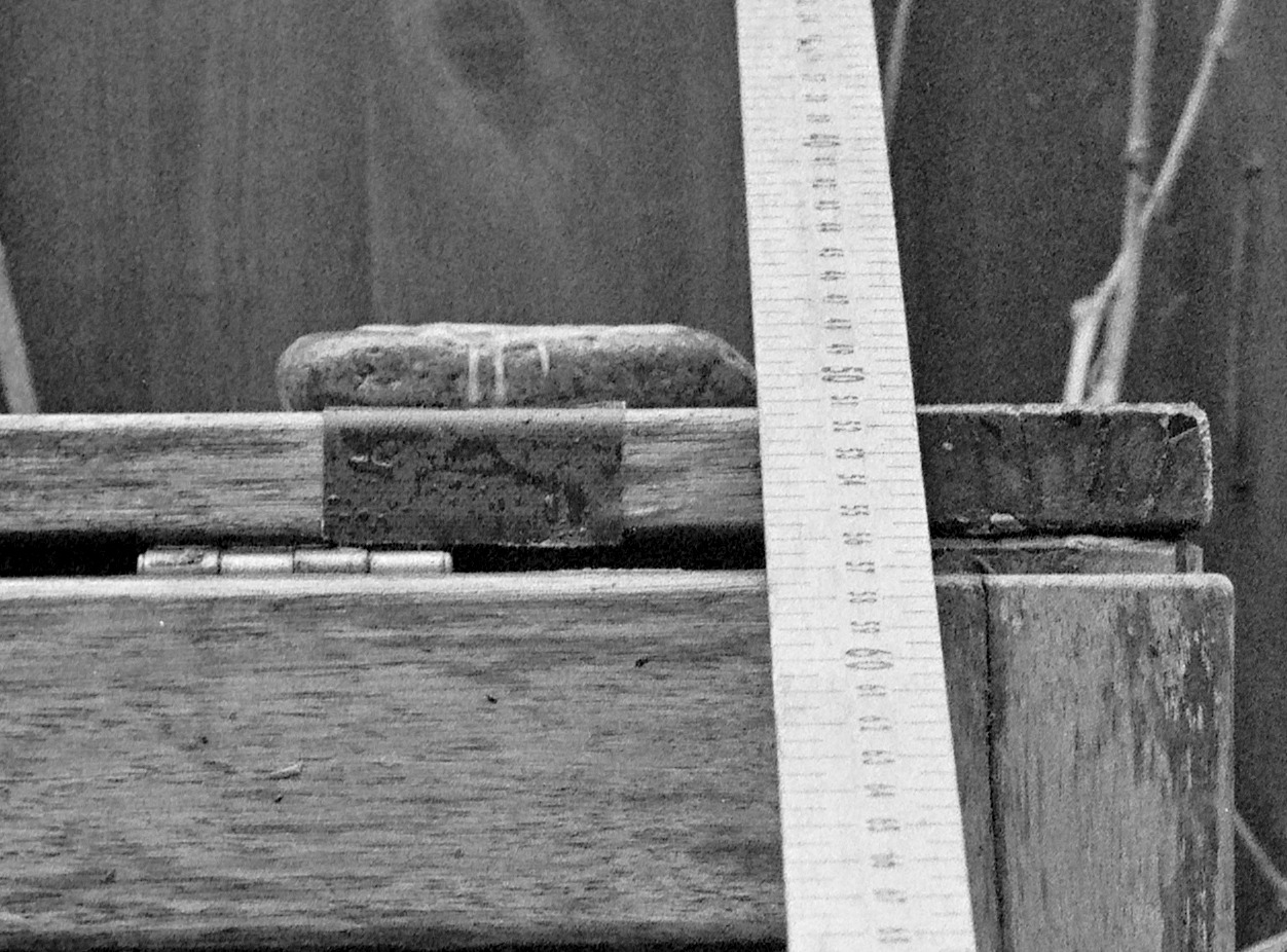

Here are some test pictures. 100% crops. RF was focused on the piece of tape which lined up with the 50 mark on the rule. 3.5ft distance.
90mm lens at f/4 then f/8. Focus seems to be slightly behind target.
58mm lens at f/5.6 then f/11. I think the focus is in front of target.

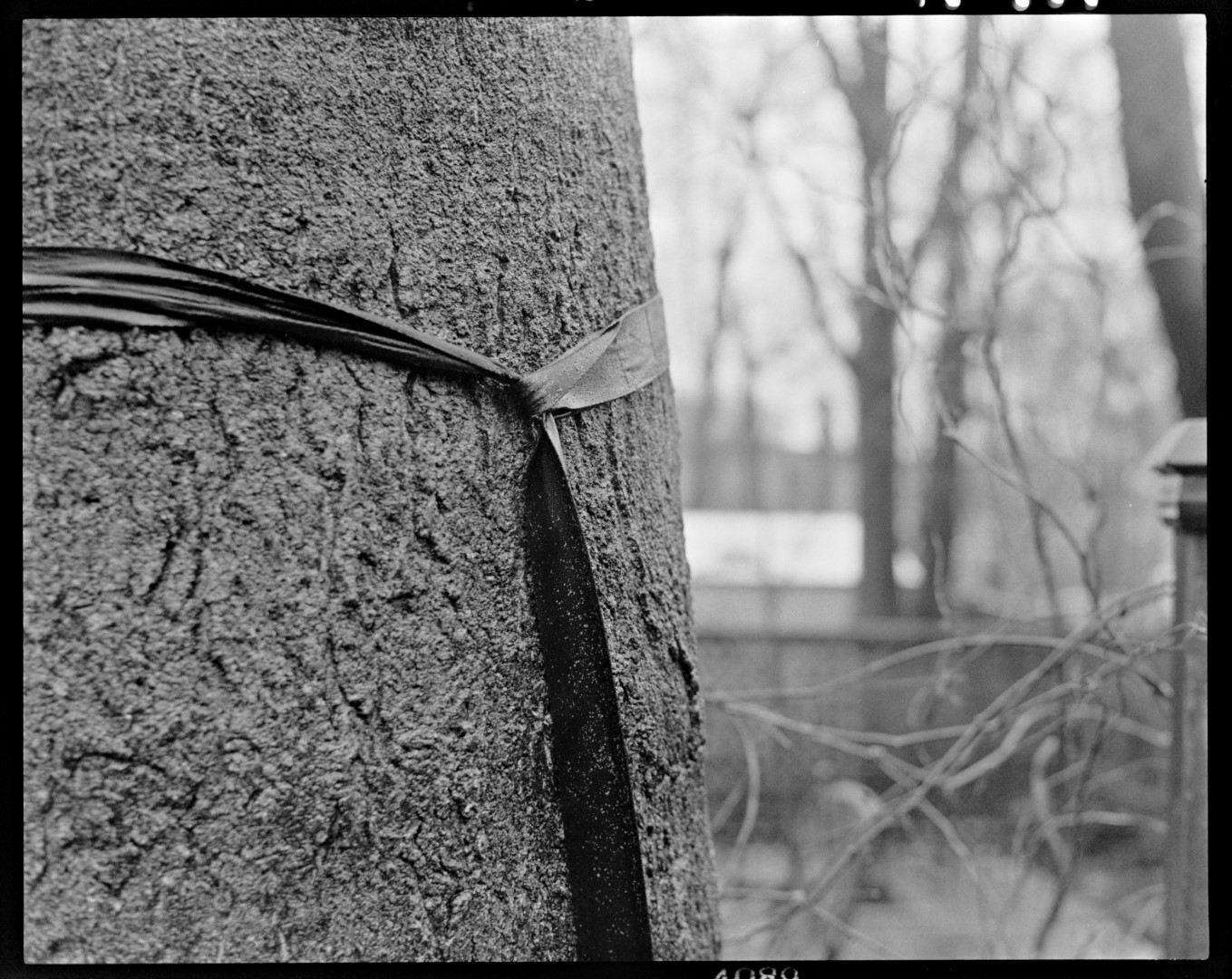

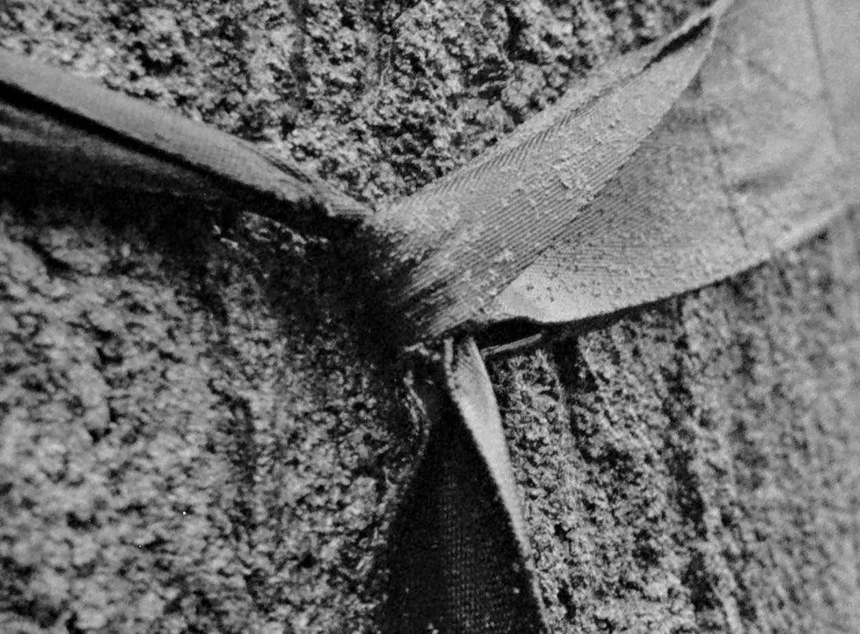

Focus was on the knot. 90mm f/5.6.
I'm not sure what to conclude regarding the focus shift due to presumed bulge. Maybe that "f/8 and be there"?
