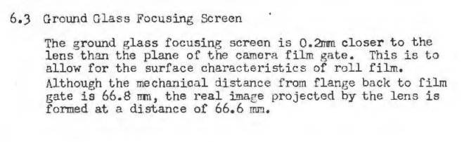

I'm working on a Rapid Omega 6x7 and found the following statement in the repair manual:
Ground Glass Focusing Screen
The ground glass focusing screen is 0.2mm closer to the lens than the plane of the camera film gate . This is to allow for the surface characteristics of roll film. Although the mechanical distance from flange back to film gate is 66.8 mm , the real image projected by the lens is formed at a distance of 66.6mm.
What are those surface characteristics? I suppose there is some bulge. Happy to hear your ideas.
Weird. It sounds as if the film itself is getting pushed forward into the film gate, ahead of the edges?
0.2mm is not a small amount for focus.

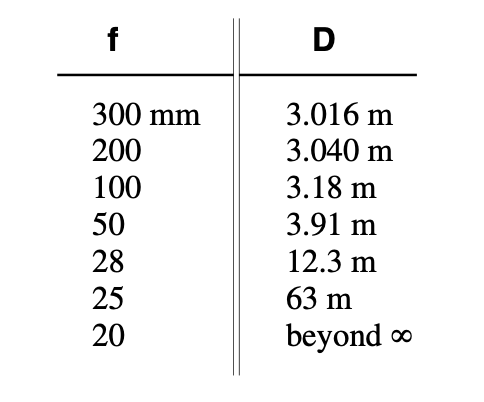

Coincidentally (or perhaps not?), Harold Merklinger discusses the consequence of a 0.2mm shift in the film plane in his book The Ins and Outs of Focus. It varies with focal length of the lens. Since the book is freely available on the internet, I guess I may quote it here:
Well, let’s suppose we are photographing a person indoors. He is seated in a high backed rocker about 10 feet from our camera. About three feet behind him is a window. Through the window we can see part of the house next door and beyond that the mountains. We use a variety of lenses from 300 mm to 20 mm in focal length. Unknown to us a bit of film is stuck on the film pressure plate of the camera and so the film is actually .2 mm closer to the lens than it is supposed to be. What objects will be in focus? Using the basic lens formula, Equation (1), we obtain the answers shown in the table below. f is the focal length of our lens, Dis the distance from the lens to the object actually in focus. The subject’s eyes are at a distance about 3.000 meters (about 10 feet) from our lens.
From this table we find a number of interesting results. With the 300 mm lens, we focused on the bridge of the subject’s nose, but his eyes are in perfect focus. With the 200 mm lens we focused on his eyes, but his ears are perfect. With the 100 mm lens we can see every grain in the wooden back of his rocker. With the 50 mm lens the window is perfect. With the 28, the house next door is just beautiful. With the 25, those mountains aren’t bad at all. With the 20, nothing, absolutely nothing is in focus. We have a soft focus effect throughout!
What we see here is that long lenses are actually quite tolerant of errors at the film plane. Short focal length lenses, on the other hand, require absolute precision!
Merklinger is talking about 35mm here, but earlier he discusses the effect of format, concluding that although the geometry of larger formats means they are more tolerant of errors at the film plane, they have a larger image area for film curvature to manifest, and this will have the greater impact. Hence cut film, vaccuum film holders, or even glass plates for critical work; also very small apertures.
