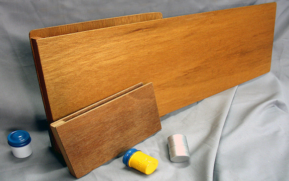

Make a ground glass cover...
Like this...
Some plans are on on my DIY page here...
http://re-inventedphotoequip.com/DIY.html
Reinhold
