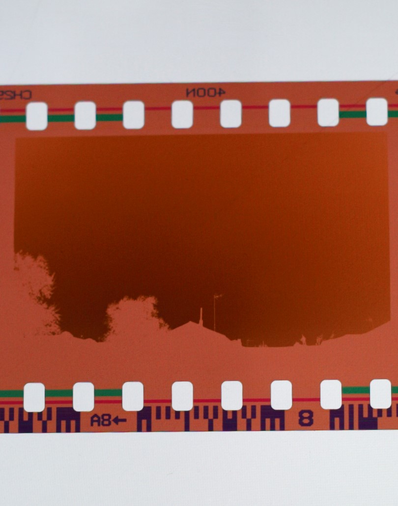

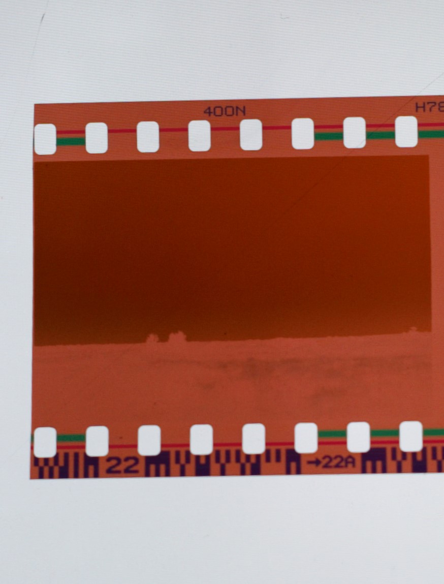

View attachment 207534 View attachment 207535
This are the negative of the respective photos. take a look
Good you have downloaded photos of the negatives.
From the color and density of the film side patterns, development looks perfect.
Still suspect scanning problem. I started to think that the shop scanner software was adjusted to assum all films are daylight, and compensating for various density and color from frame to fram.
Your film scan is over corrected and in the wrong direction, I think.
I can not assume bad scanner at this time, before you do the following:
Study scans from other frames in the same films that was correctly exposed in daylight/around midday.
Let us know please.
If you comeback to the lab, ask for scan of individual frams with manual corrections, not the preset corrections.

Well the negatives appear well developed, I think you will find that even if the scanning is better, the under-exposure will still mean that you will end up with disappointing results.
They may not be green, but they will still be very dark.

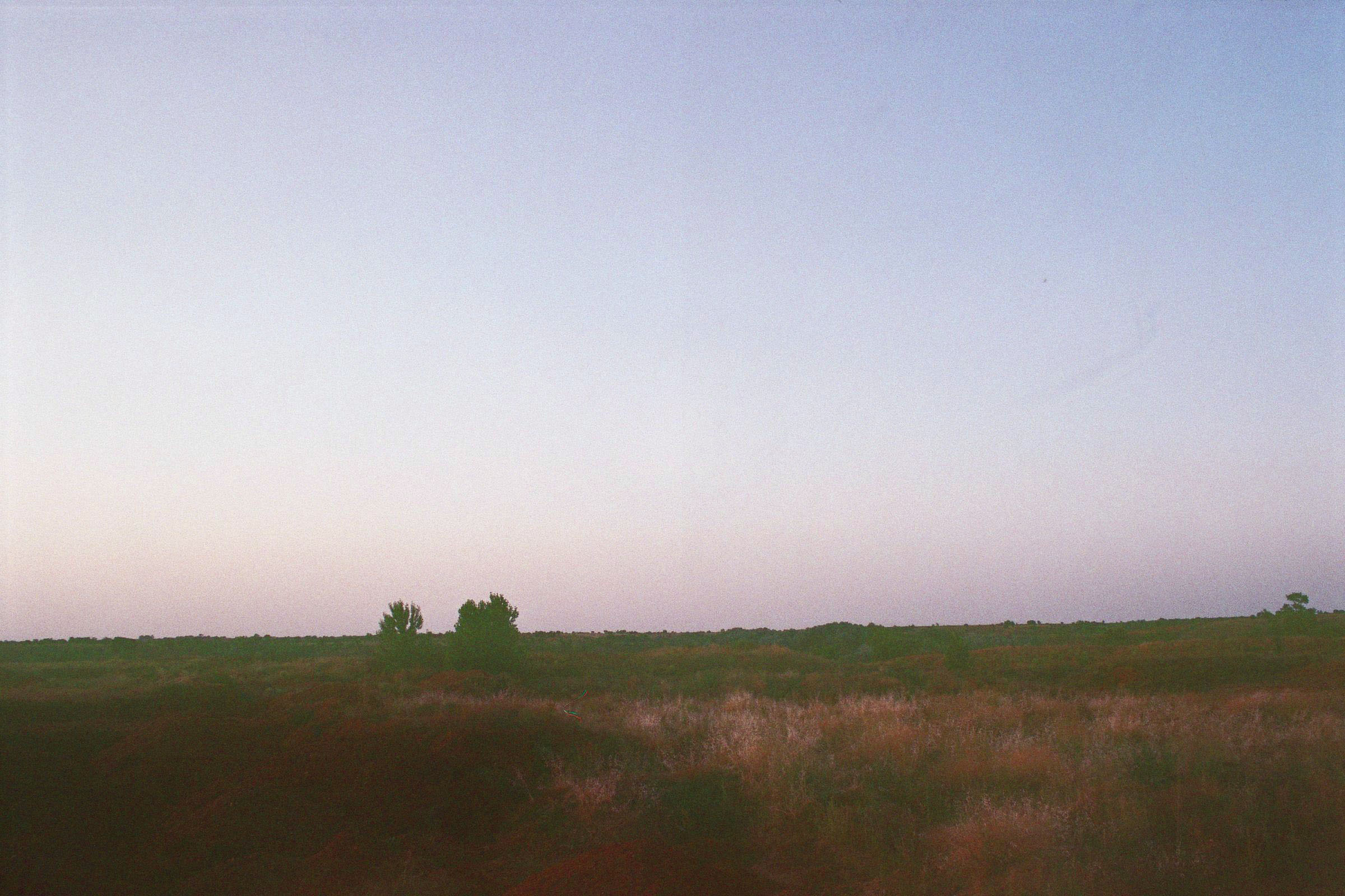

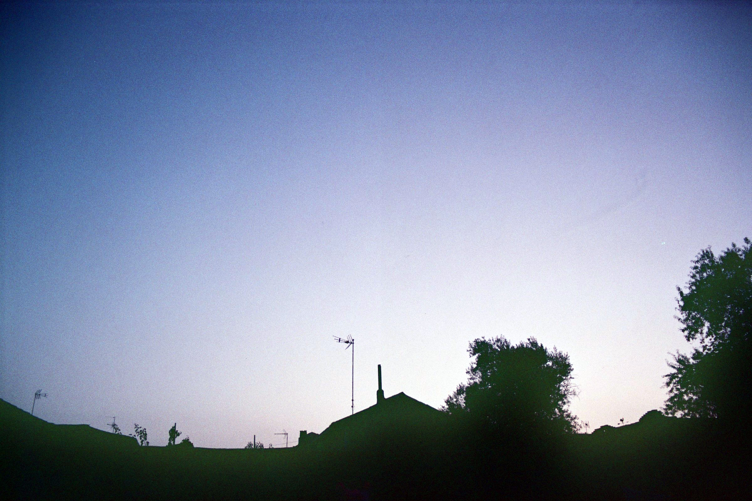

On the 2 pics i wanted a black silhouette but it became green
You cannot tell development quality from looking at these. If you could, labs would not need control strips. For example, crossover and its degree cannot be revealed by such markings. That said, I think the problem is in the scanning.

I am 20+ years removed from my minilab experience but the problem here is at least two-fold. First is under exposure. If that were the only issue, the black would still be BLACK, not some other hue. If we assume that the other part of the problem is film processing... it’s obvious there is serious crossover happening with the RGB plots, particularly in the shadows. If the lab’s process was in balance, i.e. tested daily and adjusted accordingly (read: replenishment within manufacturers specs), the plots would remain consistent right to the bottom of the toe. Easy-Peasy, but you have to monitor daily. The negatives look overly magenta to me, which is consistent with the green print cast.
The other side to this is the scanning, as has already been mentioned. OP when you scan your negs turn off all adjustments in your software. Be sure you are scanning just the full negative area, including the shadows, but don’t compensate in the brightness/contrast, curves, levels, color balance or any other setting. Turn off all automatic controls. Once you are sure of that, than your resultant scan should accurately reflect the information within the negative. If your scan returns the green cast in the positive, or magenta in the negative—your scanning is probably accurate and as good as can be done in this instance. The problem is somewhere in the processing.
Any properly exposed negative with the full range of tones and the magenta cast would be harder to spot as the printing machine would have enough information to correct for the cast. The problem could be on the printing side of the operation but given how the negatives look to me, I think it is the film development.

Yeah, it's a scanning issue. Though it is still underexposed a bit. You might consider using a graduated neutral density filter for stuff like this, unless you want a silhouette. In which case, you overexposed it a bit. In either case, the scanner didn't do such a good job.
But regardless of what scanner you use, you'll likely have to correct the colors in a photo editing program like Photoshop. You can't rely on the scanner software alone to do all of the work. I find that even using an automated color correcting software that works fine for "properly" exposed negative, you typically get bad results with "improperly" exposed negatives. Hence why manual control and skill are so important.
Here's a quick edit I did to the photo you posted. If you look at the histogram of the original photo, you can see that it wasn't scanned or edited well. My edit isn't a whole lot better, as I just spend about 20 seconds on it, but it shows what 20 seconds worth of manual effort can do that automatic software cannot. All I did was blindly adjust the color balance using the histogram with the curves tool. If it were my photo, there would be a lot more I would do to it to get even better colors and such, but that would take significantly more time than 20 seconds.

Keep in mind the OP indicated he wanted the pics to appear as silhouettes, probably more like ced's post, very dark, near black. Underexposing the film probably was appropriate.
jim10219
Jun 15, 2017
1,627
Oklahoma
Keep in mind the OP indicated he wanted the pics to appear as silhouettes, probably more like ced's post, very dark, near black. Underexposing the film may have been appropriate.
Yeah, I know. I was just showing that the colors are all there and correctly balanced in the photo, meaning it's a scanning issue. I was also kind of dealing with it more generally, in case someone else runs into a similar issue and stumbles upon this thread in the future. But you are correct.
