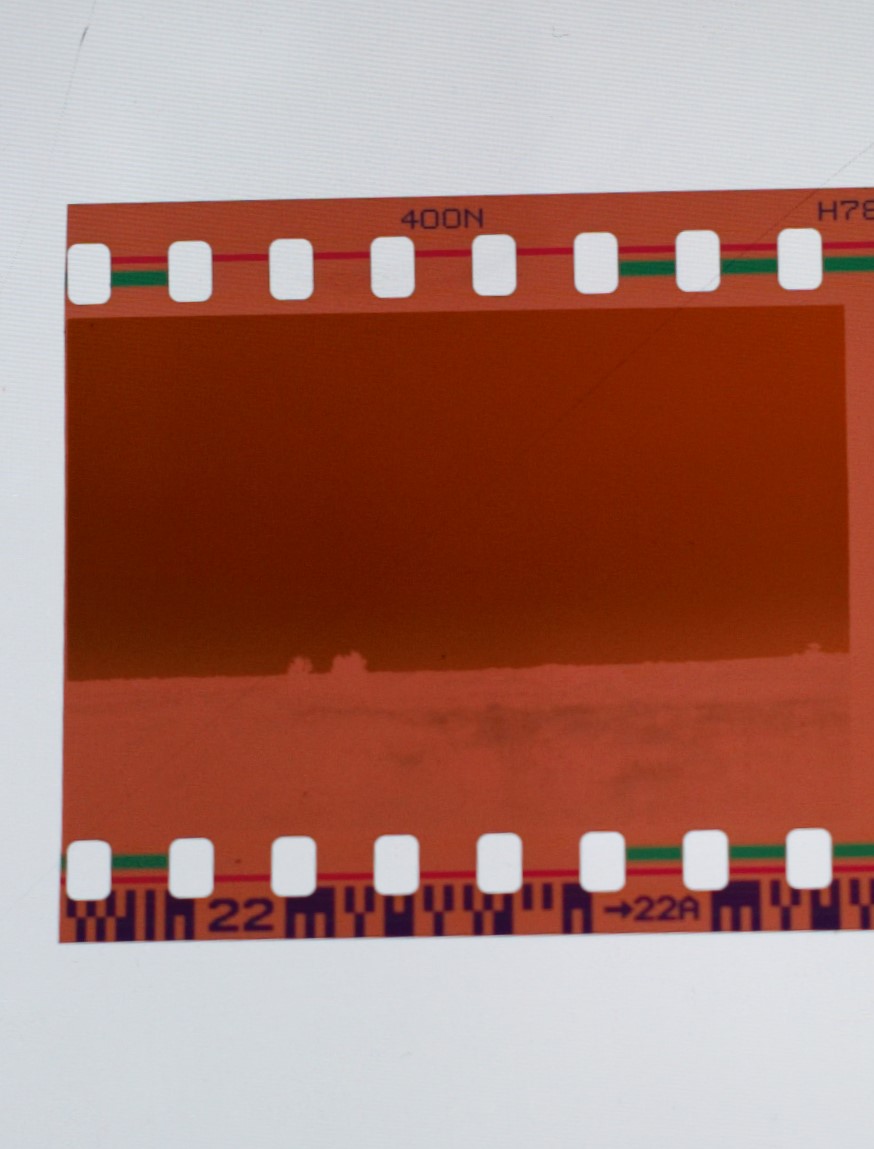

The problem here is that so far we seem to be having difficulty in helping the OP with how he gets to the real cause of the green in his positive picture of his negative. Is it a scanning issue or is it an in-camera underexposure issue that causes the green effect? All I can say is that until now I have never seen this green effect before in negatives where a lot of the scene is underexposed. If this is a direct result of underexposure then this would mean that underexposure in scenes caused by the predominance of a light area such as sky will always cause a green effect in the positive so a picture of a person against the sky will always cause that person to be green because the negative is now permanently the wrong negative colour and in effect there is no cure in a darkroom RA4 print process?
I find this difficult to believe. So is it solely a scanning problem or is it the negative. If the negative is fine i.e. an RA4 print of it would result in the buildings simply being dark as I would expect then it becomes a hybrid issue, doesn't it?
So, OP, here's my suggestion: Can you take a photo of the 2 negatives so we may look at them and decide if it is a film processing problem or a scanning problem.

Sure i'll take a photo to the negatives. I'll make them tomorrow morning (spanish hour) and post them here again.

If you look at your negatives you will see that they are almost blank in the areas that correspond to the dark and green parts of your prints.
Blank parts of negatives mean that not enough light got to them to allow the detail you like to be recorded there. In other words, they were under-exposed.
The under-exposure most likely resulted from your camera meter reading the sky instead of reading mostly the ground with a little bit of sky mixed in. Shots with a lot of sky often end up fooling meters, unless you watch for that.
With respect to the negatives you have, a custom print, properly done by a skilled individual would most likely show very dark and detail free shadows in those almost clear areas. The lighter areas in the scene would be lighter than that, but still disappointingly not bright.
The custom print would get the colour closer to right though.
Your prints, and the scans that they were most likely made from, reflect the fact that they were almost certainly made using automatic machines. When those machines encounter a severely under-exposed negative, they struggle mightily to extract as much from it as they can find, even if there isn't much there to extract.
Those automatic, best they can do efforts usually result in something pale and discoloured.
If you give the film more exposure, the automatic systems in the scanners and printers have something to work with, and usually do a better job.
