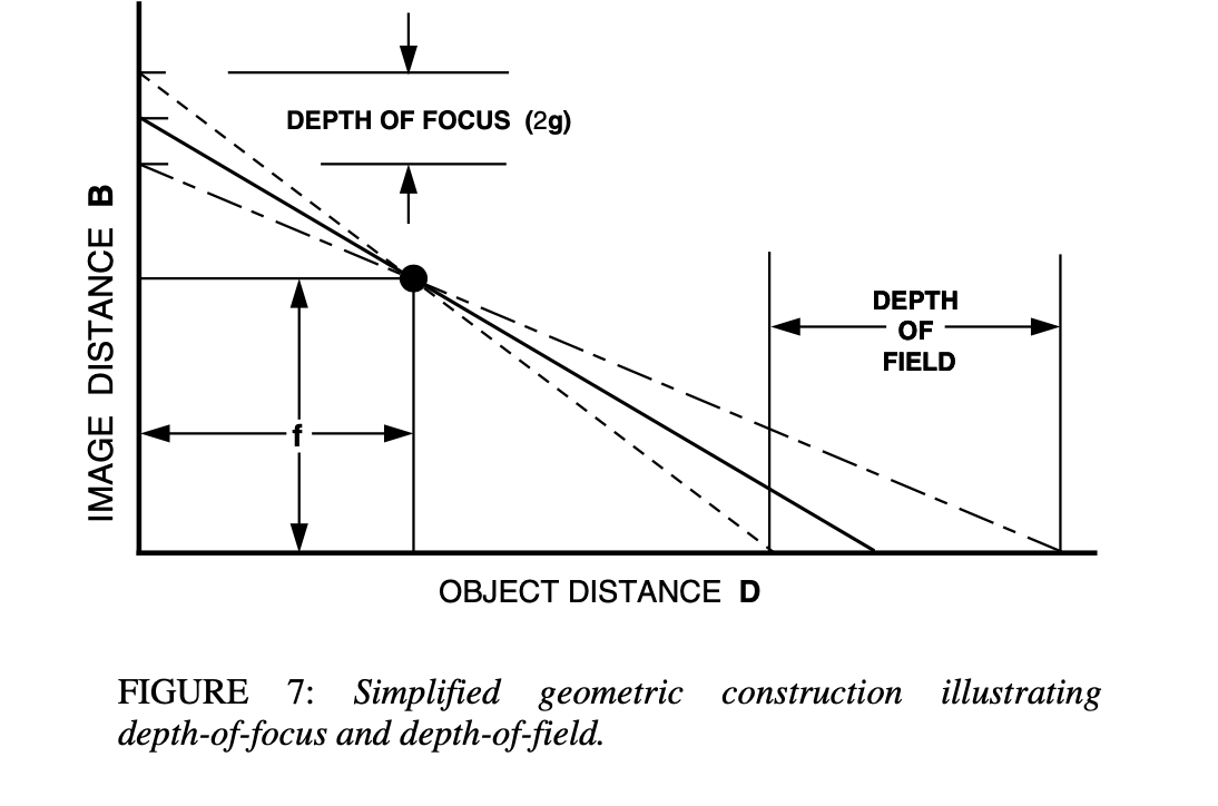

Is the middle correct? I don't know. In the view camera formula at the object side, the DOF is 2/3 behind and 1/3 in front at the hyperfocal distance, whereas at the image (film) side it is 50/50. On an enlarger, we can compute the answer using geometry and the diagram below, but what have you found with your actual measurements?

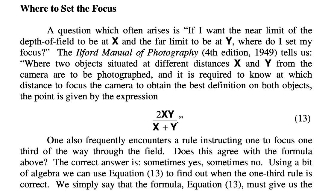

Full text in "Ins and Outs of Focus" Harold M. Merklinger 1990
Worth considering third of way through may be the best focus.
Is this consistent with our earlier discussion about whether the changes are linear?
Yes, the hyper focal distance is well known and makes sense there is some of that at play here.
So I am looking forward to suggestions, but will take it for granted there is a 1/3 slash 2/3 breakdown and I will try to get it in the right direction.

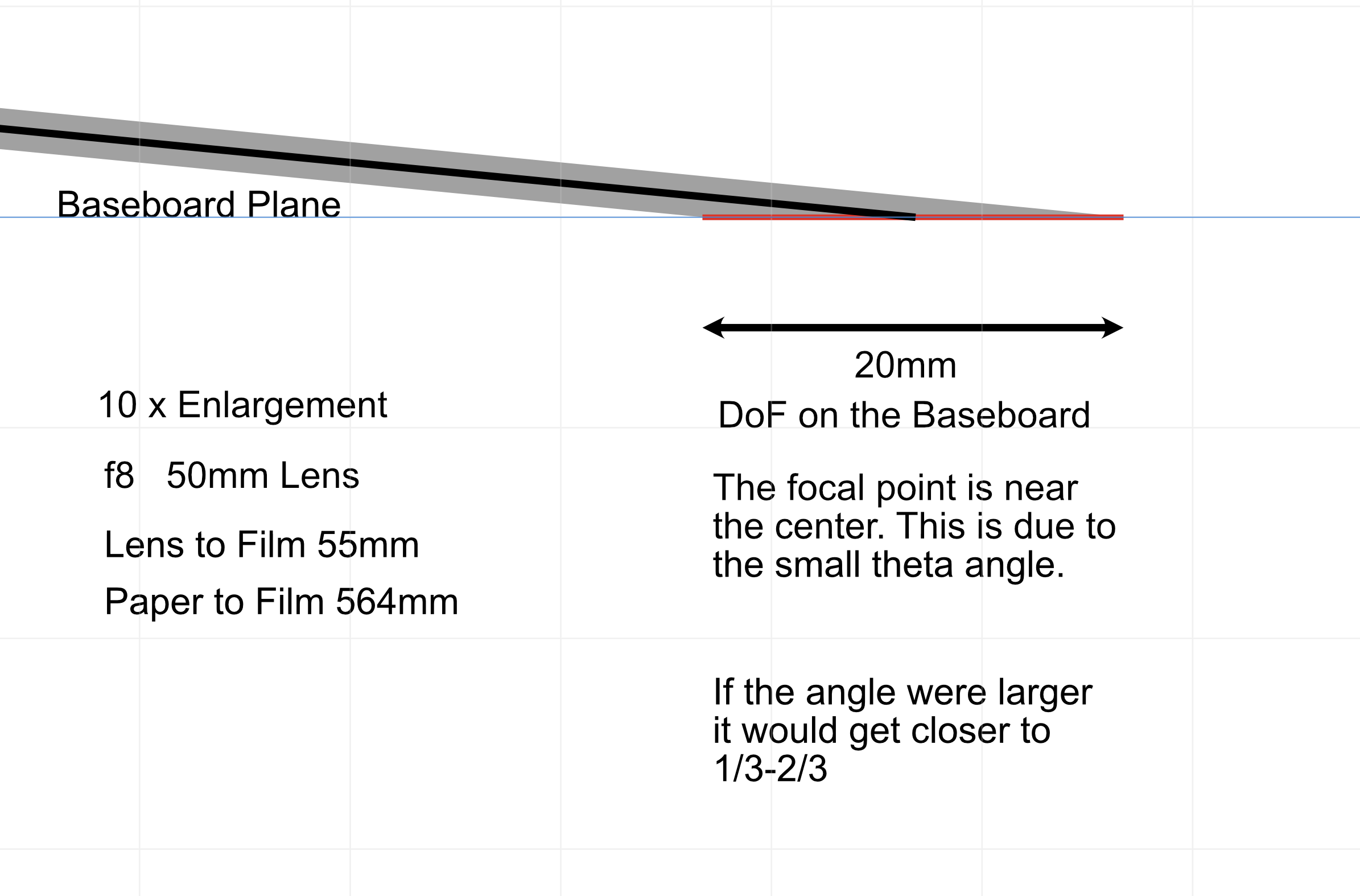

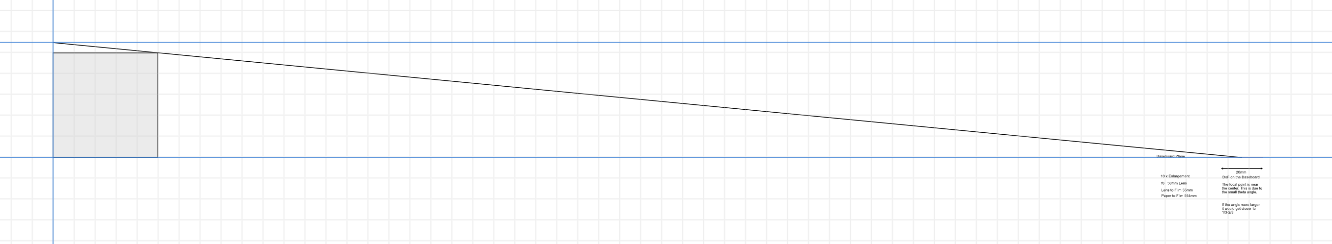

So, plugging practically used numbers to the equation is important in this case. The angle that forms the DoF limits is so narrow, the model shows the focal point in the MIDDLE of the Depth of Field, not 1/3-2/3 like the view-camera model in the earlier post. The math is the same, but the magnitude of the numbers is very different and yields different results!
I did not zoom in on the left side of the model (the negative side), but as Bill has already shown us, and as one can imagine, the Depth of Field is very very small.

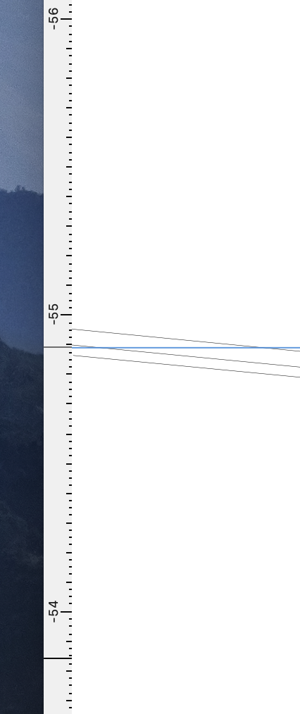

Ok, in case you would like to see it, this is the DoF at the negative with 10x enlargement and F8 50mm lens. The DoF is about 1/10 of a millimeter.
Wow that’s beautiful!
At the negative it looks like 1/3 and 2/3
So that answers two questions:
When focusing with the enlarger head, where is the focal point located between the extremes? Near the middle.
Does a thickness of paper matter under a grain focuser? No. At f8 with 10X enlargement, the depth of field at the baseboard is sixty times greater than the thickness of Double Weight paper.
That is just from the lines being so hard to draw that close together with the software. Already in the view camera the DoF is very close 50/50 at the negative. In the enlarger in my model it is even more exact at the middle.
REMEMBER REMEMBER, the lines in the model are not the light rays from the lens to the baseboard. This is just a geometric model to calculate the angles that form the DoF.
So, as the two divergent lines have a smaller angle from the pivot at the corner of the box, and as they intersect the "negative plane" at more of a 90 degree angle, the focal point is more right in the center.
The reason for the 1/3-2/3 DoF in the scene when using a camera is the shown mathematically when the two lines diverge a lot form the pivot at the corner of the box and they intersect the subject plane at a very shallow angle.
This was a real surprise to me as all a long I thought the diagram would look like that in post #55 above.
