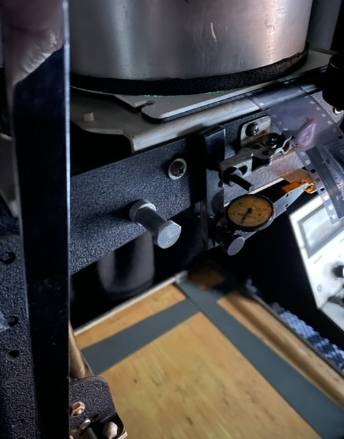

I'm a couple of years late to this thread, but the title caught my eye when I was bored. I'm one of those who does use a waste print underneath the focussing aid.
It's totally OK to put paper under the grain focuser to account for the thickness of paper because it is more accurate.
It's totally unnecessary, proven by experiments.
I occasionally use a piece of paper, even though I proved there is a great range of focus at the easel.
With this setup, there is precision of 0.001” at the negative stage.
With 50mm lens and 35mm negative enlarged to 11x14, crisp focus falls within a range of 0.006” at the negative stage. With paper you can dial into precise and accurate focus. Without paper you throw away 0.001” of accuracy.
That’s about a sixth of the tolerance.
The time spent paying attention to this detail is better spent checking the cleanliness of your sink, because a stray splash of fix that you touch before picking up a fresh sheet of enlarging paper will ruin a print more quickly.
