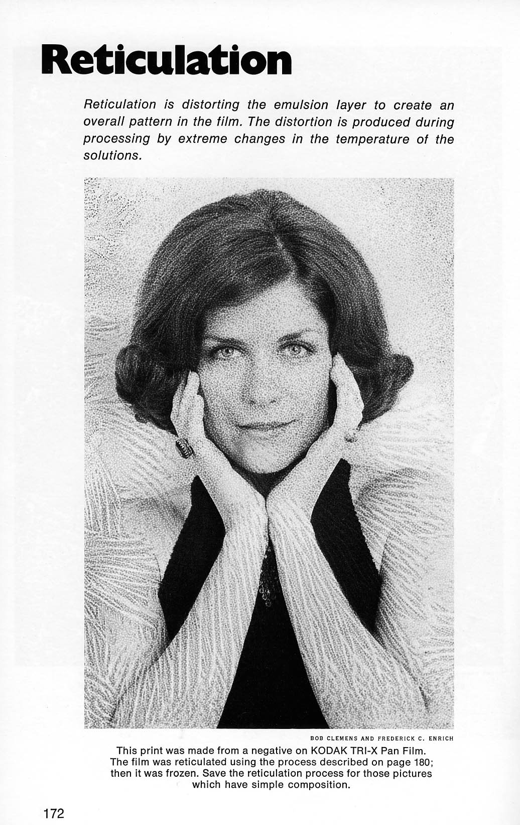

Reticulation
For those of you interested in this subject an its use, the Kodak How To book "Creative Darkroom Techniques" devotes a whole chapter to creative uses of reticulation in B&W and color films.
They describe heavy and light reticulation and large and small patterns.
Here is a photo done by two of Kodak's research photographers, one of them coincidentally a good friend of mine. So, this is one of dozens of photos illustrative of the subject matter and which only shows one type and size of pattern. The original is about 5x7 inches in the book and so the full impact will be gained by zooming to about that size.
This picture combines a mild grain pattern and an ice crystal or frosted look by heating, cooling and freezing the film to get the extreme frostlike patterns and the reticulation.
You can use temperature and the flow of the water used to create and control the size, shape and to some extent the pattern that reticulation takes. The study of reticulation was reduced to a rather high art at KRL at one time as you can see.
Enjoy.
PE

For those of you interested in this subject an its use, the Kodak How To book "Creative Darkroom Techniques" devotes a whole chapter to creative uses of reticulation in B&W and color films...
Now THAT is reticulation! It's also quite beautiful :smile:
The Collotype process of yesteryear was in part based upon the deliberate reticulation of gelatin to produce a printing screen.
There is a wonderful example of a Collotype at Luis Nadeau's site
Yes Ian, the Collotype uses this phenomenon and an excellent example from one of Nadeau's photos is here: http://www.photoconservation.com/images/stories/pix_2/CollotPC957macro_8x6.jpg In which you can see the pattern that reticulation imparts to a Collotype image.
The Kodak book devotes 11 pages to the chapter on reticulation. This work died out though after the new hardeners were introduced as it was so hard to generate reticulation in the new films. But it does show how much work went into both identifying, studying and reducing it to an art form during its time.
PE
