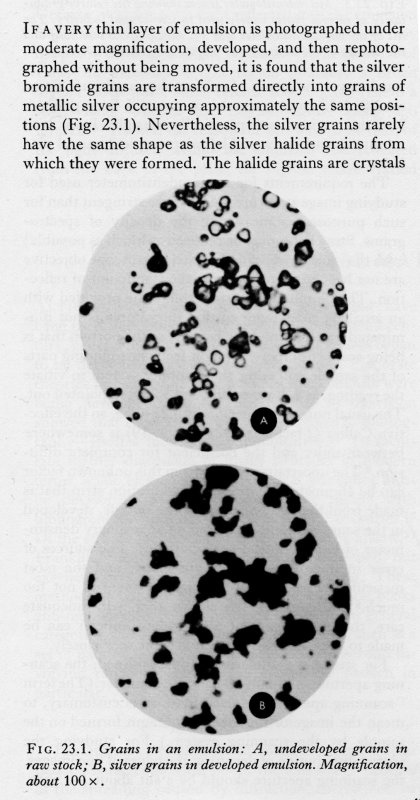

In the OP, I posted figures from a work by Ross showing that although there is vertical movement in images due to development effects, he showed less than 2 microns of lateral movement of these same images. There was no clumping, just the illusion of clumps by viewing small, random particles down through the film which were separated vertically by quite some distance (on a micro scale).

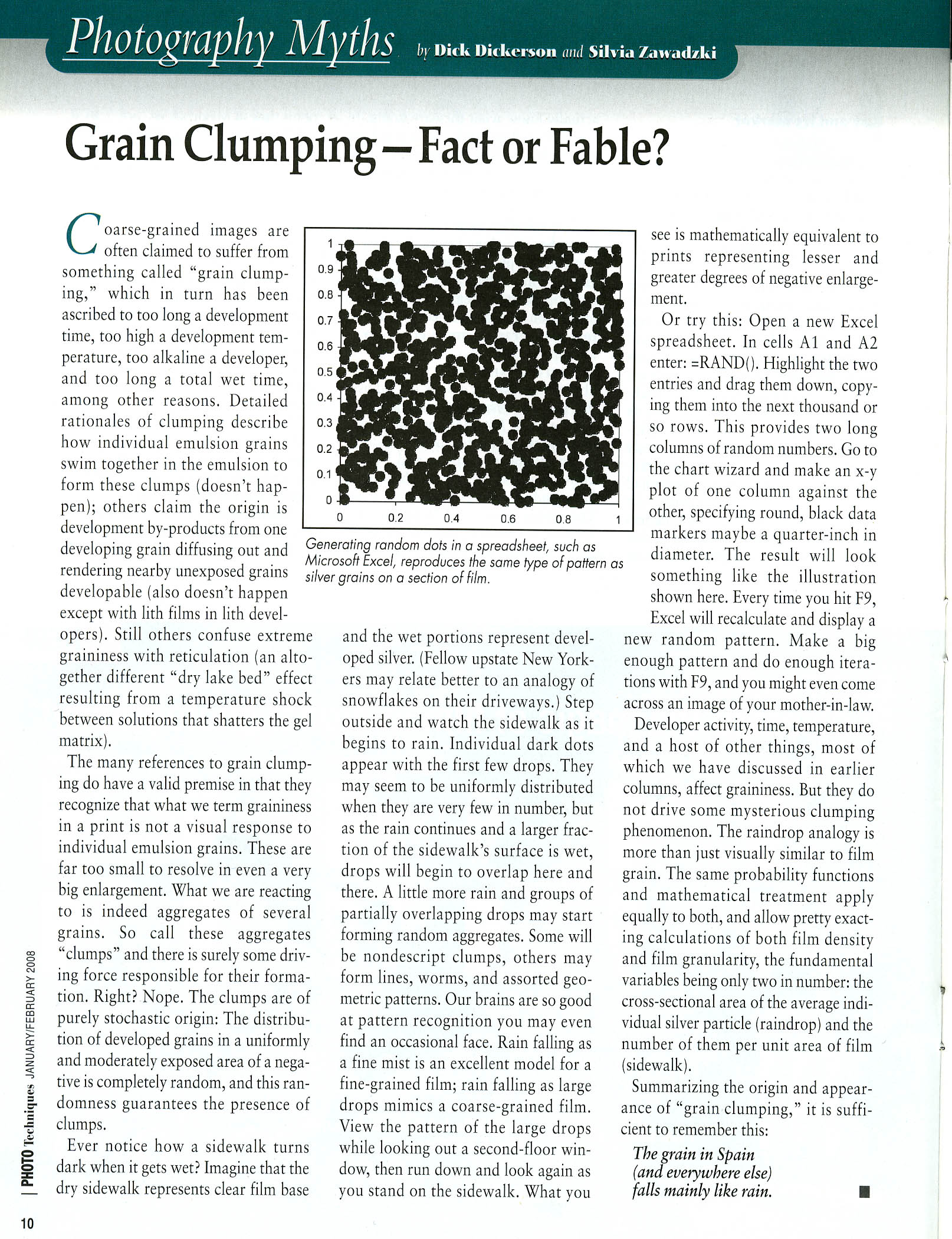

Here is the article. I hope it explains things to you and puts this in the proper perspective. It is in agreement with my previous posts and is Dickerson and Zawadski's definitive and latest statement on the subject. It is undoubtedly in opposition to the theory of clumping and ignores "micro reticulatin". It is also probably the article that Ian refers to earlier, but he misremembered the conclusions and date, as I find no other article on this subject matter by Dickerson and Zawadski back to 2002.
The document is stored at 33% of its size, and expanding it or zooming in will give you full resolution.
Enjoy.
PE

Thanks for posting that, it goes on from an earlier article where they show that the developer temperature doesn't cause grain clumping, assuming you compensate development time for the higher temperature.
However it doesn't address what happens when there are temperature shifts between process steps and why that appears as increased grain.

Yes Ian, they dismiss clumping in all cases in their entire series by summarizing it in this article. Early on they show variations in grain as a function of development time, density, and contrast just as I have posted earlier in the RMSG graphs. And, they dismiss reticulation. We have to see an example, and probably more than one because this is a random (they use the word stochastic) event, as they mention. Eventually, you can see a portrait in grain of your mother-in-law (as they say). :wink:

As a general reply to you Ian, it is clear that the Kodak people ran processes from 65 to 75 degrees F with variations between solutions wrt temperature. In any event, D and Z make no mention of reticulation of any sort within that range nor does Kodak warn of it. So, since micro reticulaton is apparently not on the table for them, what are we to think. Well, since there is no mention of it, I guess we will continue to argue.
The referenced article(s) describe grain as a variable with process conditions, and one that varies randomly from roll to roll and scene to scene just as the fall of rain varies from storm to storm. The fall of raindrops is not a constant nor is grain.
BTW, just a thought here. If you believe in the arguments in favor of clumping and micro reticulation, then you are giving a powerful argument to the digiheads who can point to a serious flaw in analog with a minor error in processing. (one that probably only a dozen or fewer even claim to have seen and for which no proof is offered).
The bottom line so far is that there is no such thing as grain clumping! If you cannot agree with this, take it up with D and Z, who are experts in the field. If you believe in micro reticulation, you are stretching your imagination IMHO, as arguments that it exist are totally without merit. No documented evidence exists.
