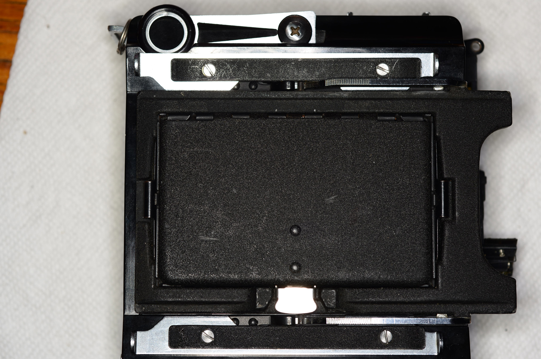

Okay, I almost started a fresh thread for this, but decided to add it here -- it's related to my Grafmatic aspirations.

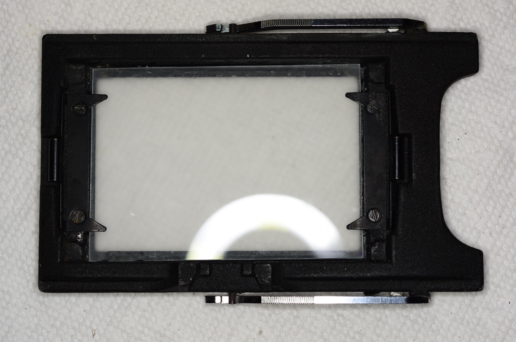

I bought a Graflok screen/hood assembly (the bit that lifts out to mount Graflok attachments -- no ground glass, but that's easy to fix), thinking I could transfer the "Graflok" back from a plastic electron microscope camera body I've used (about three times in fifteen years) as a pinhole camera. Went to mount the screen and hood, however, and found the spring legs don't even come close to fitting the Graflok back I have (I presume this means the back I have is "international" rather than "Graflok").
I saw the entire assembly, frame that mounts to the Speed/Crown body and all, on eBay shortly after I ordered this; they do come up occasionally, but I wanted to check that I wasn't just missing something. I should be able to unlock the slide plates and just drop the screen/hood assembly into place, right? Do the real Graflok frames have much deeper extension on the lock plates to accommodate accessories that I'm pretty confident fit this back (like Polaroid pack film holders)? How do accessories like Polaroid backs and Grafmatics center, if they're narrow enough to fit under the ground glass of a standard spring back?
A Graflok/International back is a design that conforms to film holder/accessories standards only. Their focus panels can vary and not interchange.
Some spring backs do not extend far enough from the camera to allow a grafmatic to slip into the film holder frame of the camera.
Any film holder designed for a Graflok style back should fit into the holder frame and be locked into place with the slides.
Most if not all accessories will have a slot in their sides that the slide locks into.
Standard two sided film holders can be held in place with pressure from the slides even if they do not have slots for them.
The have the light trap ridge that slides into the grove on the insertion side of the camera back. They are the same dimensions from the light trap to end as standard two sided film holders. They are held in place by pressure from the spring back of graflok/international slides.

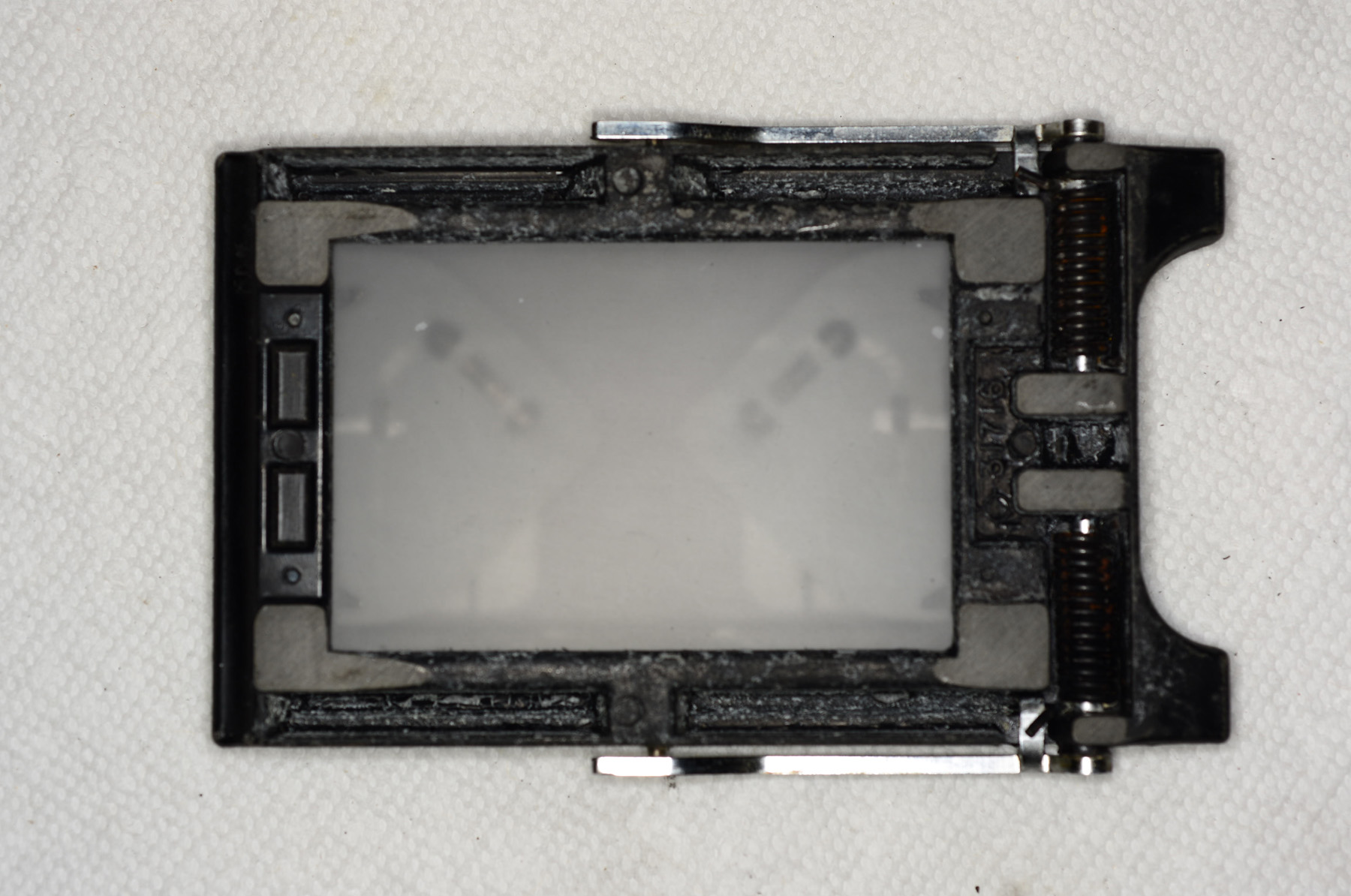

Okay, then I'm asking the question backward -- I've got the Grafmatic, and three old Polaroid backs -- a 500 (singles, like 55), 405 (3x4, aka Type 100) and 505 (4x5 print pack film), all of which are Graflok mount. I know the 500 fits under the ground glass on my Speed Graphic's spring back, and is Graflok compatible -- the 405 and 505 don't fit under that ground glass (I've mounted them on spring backs by taking the screw out of the middle of the spring leaf and retaining the Polaroid back with a piece of brass sheet, bent to fit).
But if the Graflok mount is only that big, how do the spring legs on the Graflock focusing screen/hood assembly fit (thinking of modifying the mount I have, rather than shelling out for another complete back)? I've never seen a full Graflok back up close...
This is the graflok back on a Century Graphic, a 2 1/4 x 3 1/4 camera.
The focus panel is held by spring loaded arms with a hook on the end. The hook fits under a rod to the side of the film holder area. The focus panel is removed by pressing down on the knurled section of each arm and sliding the panel to the right. Installation is done by sitting the panel in the holder opening with the arms to the right of the rods/catches then pushing left.

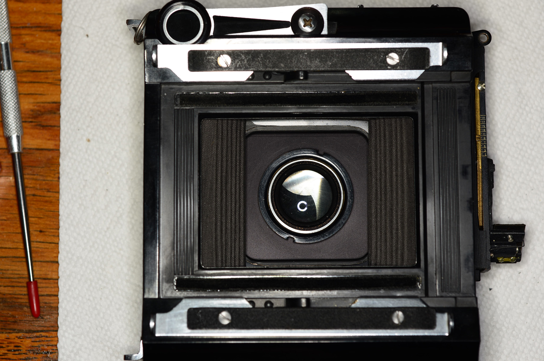

Post pictures of the back you have you want to modify.
Ah. I see now. So to modify the lock-on back I have, I'd need to cut the relief for the spring arms under the lock plates, and install the rods. Seems possible. First, I need to take the back off the body and check if it's hollow; if not, I should be able to detach the lock plates and use the screen/hood assembly to ensure the reliefs fit and locate the rods.
Still seems possible. I'll get some pictures of the electron microscope camera's back, hopefully tonight.

So the question is, is it still possible to upgrade my Anniversary Speed to a Graflok? I'm not very interested in just buying a Pacemaker model -- they're not that common with the Kalart RF (which I understand is the only one that can be fairly readily recalibrated for different lenses), and a Crown won't float my boat (not least because my primary lens on the Speed is in a shutter with the works removed -- essentially a barrel Tessar).
There was a retro fit graflok made for the Anny but fiinding one these days will be hard. The screw holes for the Pacemaker Crown/Speed graflok back are off set about 1/2-2/3 the diameter of the screw to the right to where the Anny screw holes are. The holes can be elongated and made to fit.
