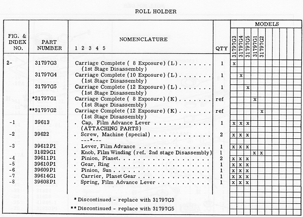

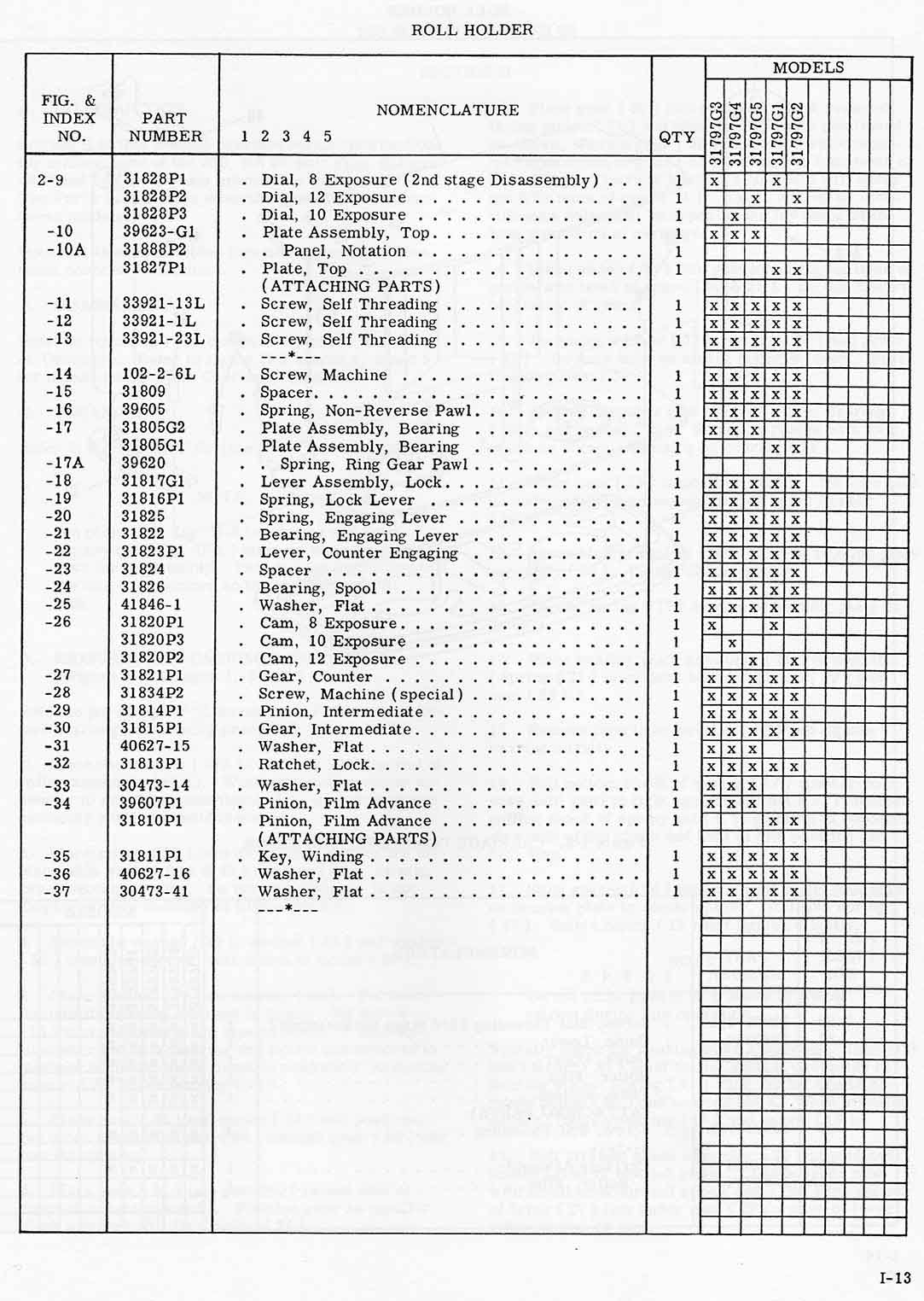

Wind key index 35.

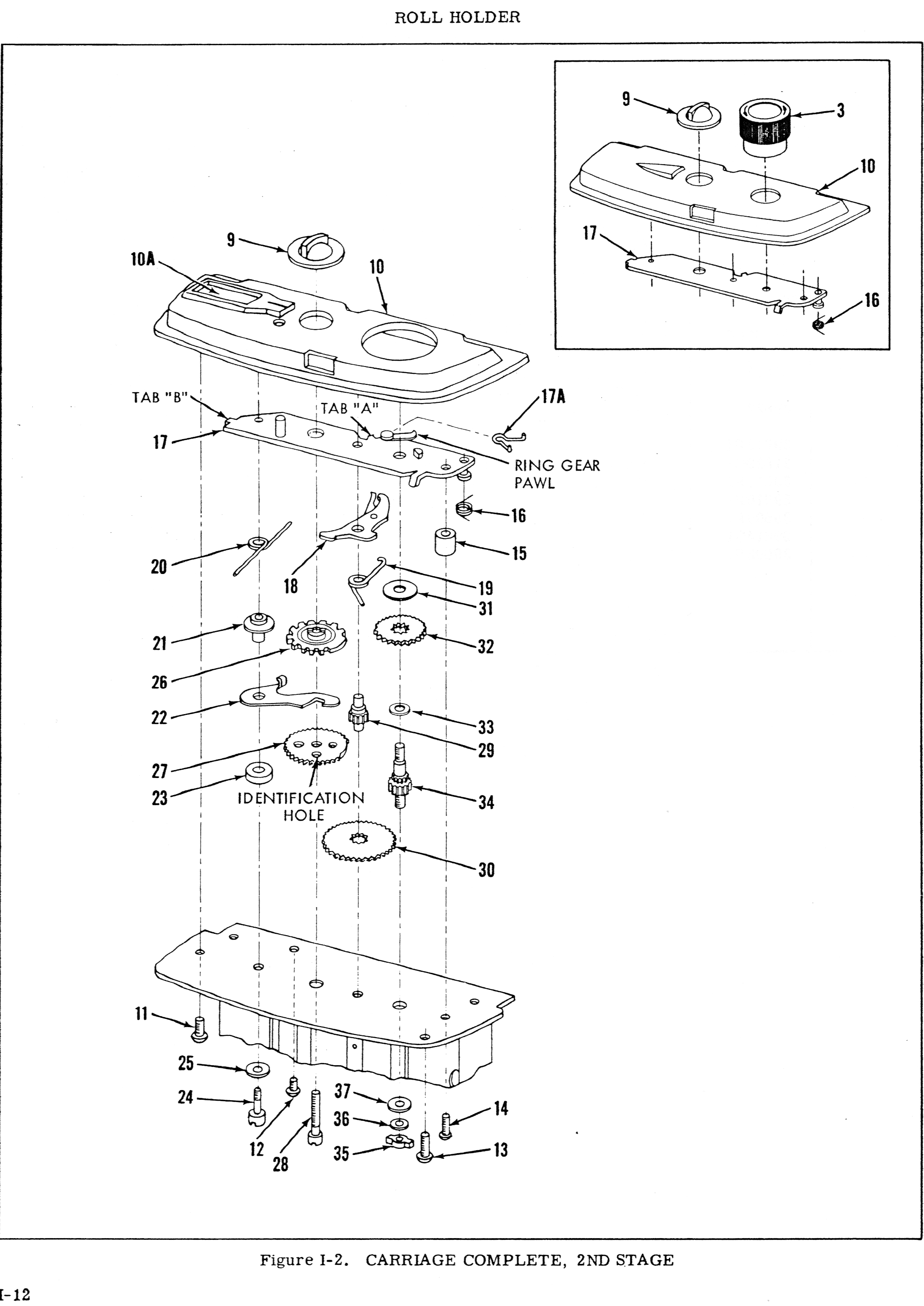

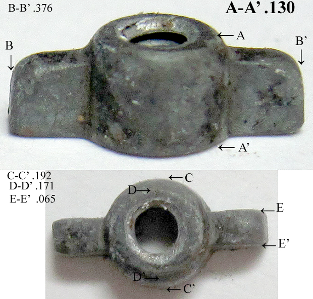

Ah... misunderstanding... its not the plastic wind key #3, which is giving the trouble..... that is turning the gears and the "Knob" #35, that actually rotates the film. Its the "Knob" #35 that is not functioning properly. It turns, until you touch it! Somehow stripped.
Is that just pressed on?
Proof:
When I rotate the plastic knob, and hold the gear #32, the plastic knob will not turn, proving that the plastic knob #3 is not what is stripped. But when I rotate the plastic knob #3, and hold #35, you can see the steel shaft turning withing #35.

The humor is that its not the plastic top knob, that you keep referring to.. its the actual part with the two prongs, labeled #35 in post #11, of the diagram that you sent, showing the breakdown of the parts, so there is no need to unwind that knob, as you describe in post #15.
The trouble is at the bottom of that shaft, where it enters the domain of the film chamber. It turns with the shaft until you resist it with a finger, but you can see the bottom of the shaft, that ends in the film chamber, turning, so gearing, winding knob and all else on that shaft is OK as the winding knob is not stripped.. The bottom film advance, "Knob" that goes into the end of the actual film cartilage, is what is stripped.

And I have made new ones from brass rod.
While holding index 3 steady index 35 should unscrew by turning it to the right. If index 35 just spins pry it off. Continued attempt to use it in its current state may require it to be cut off and replaced.
Tip: winding to a frame number will lock pinion shaft 34 making removal of index 3 or index 35 easier.

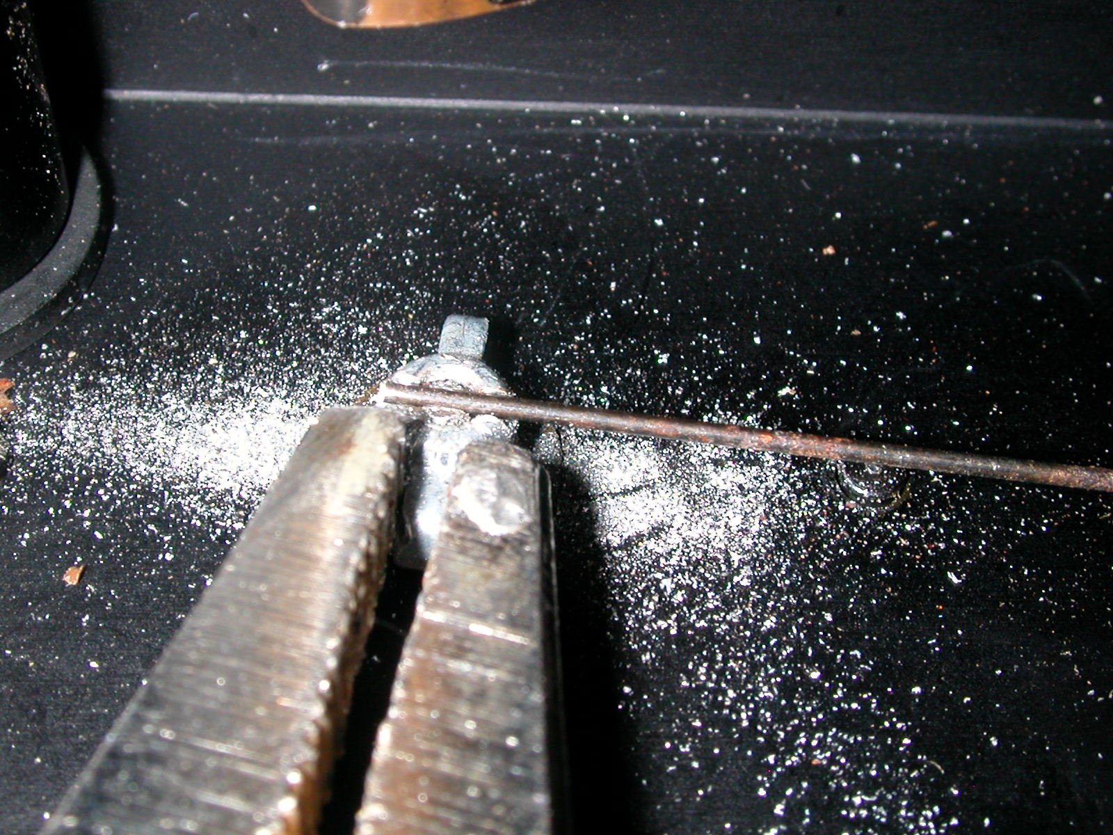

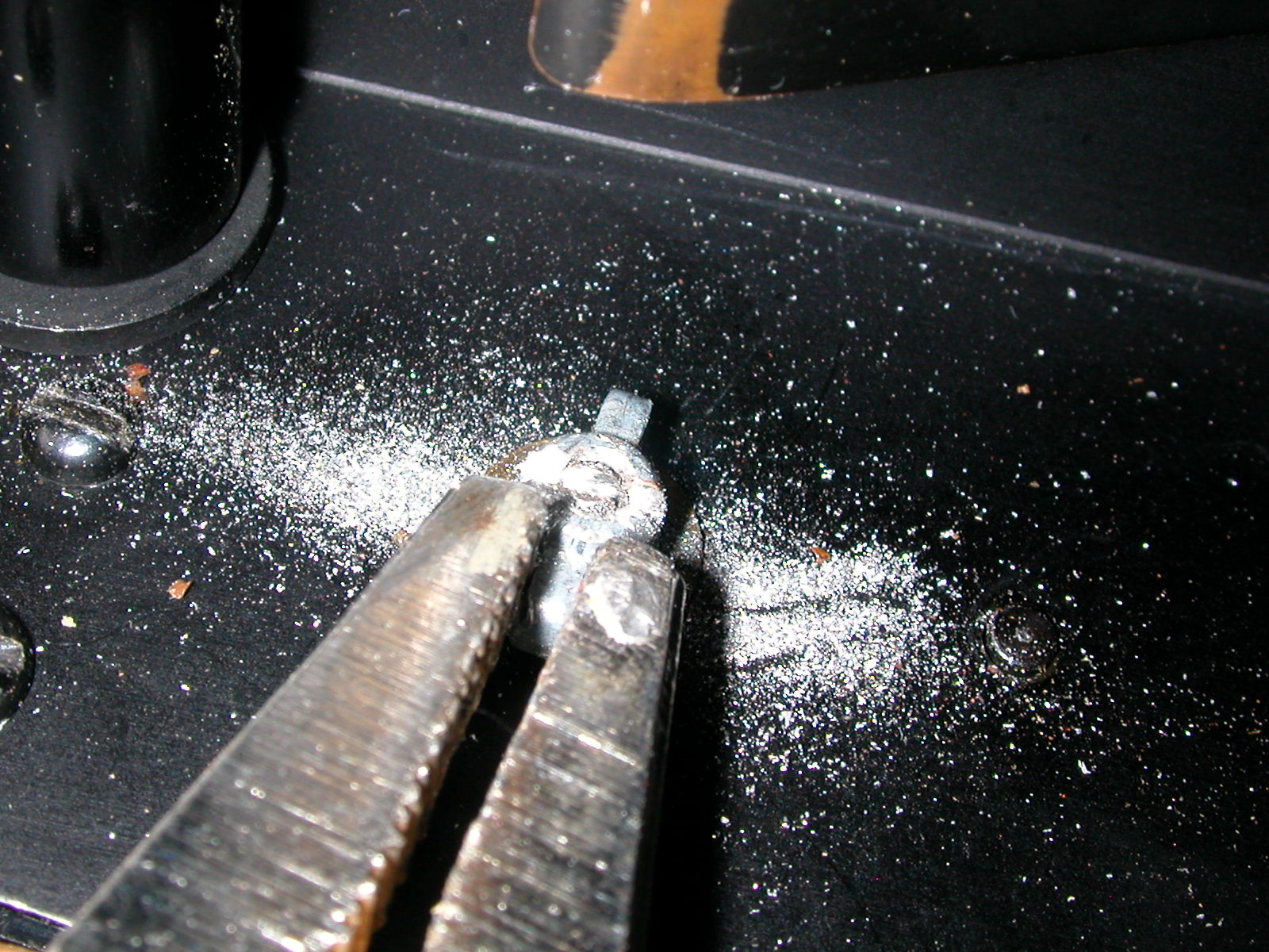

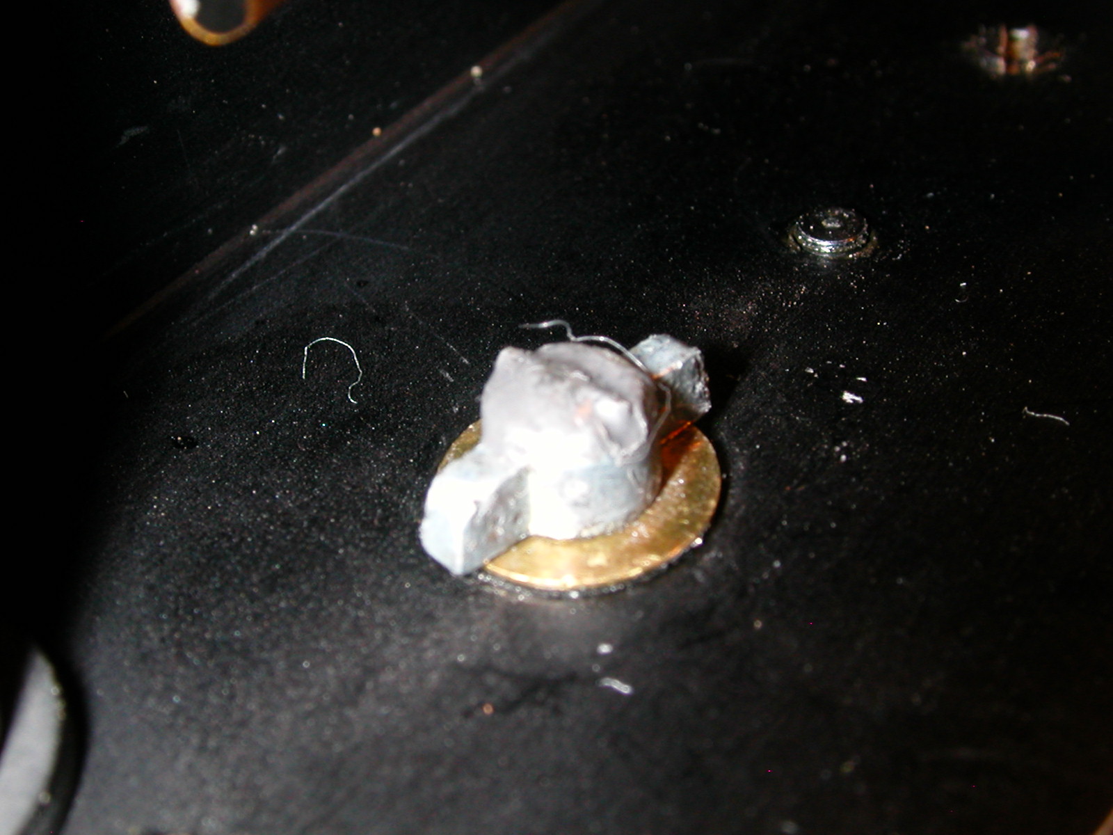

Ok... could not slip the end off, nor with pressure on the "Knob" would it unscrew.. So it must have been pressed on. It may well be a Singer because there is no label on it saying "23", just a black back.
So notched it. Started with an X-Acto fine tooth saw, then a fine tooth hack saw blade. Filled the notch with a (see photo's) using a strand from an old Chimney Cleaning Brush, that had unraveled, and still had some strands lying in the gavel. Attached that to the notch with some JB weld.
Tested it over half a dozen times, as something was wrong, with the way it advanced.. was not behaving correctly.
Daaaa.. So Note: Be sure to have Counter Dial, item #9 (from post #11) set in the correct direction!
Putting it back together I had placed it 180* off. :smile:
So its ready for a full test, will see how it does.
