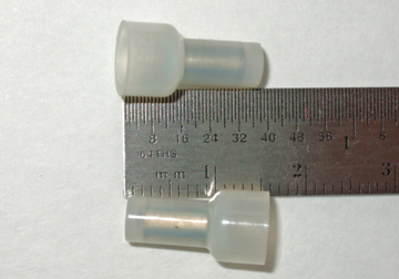

Hello, Denverdad:
My Clipper is not a Special so my experience may not apply; I say this because you said that a 120 spool just slips into the filmholder: not so on my Clipper, the 120 spool is too short. Anyway, here are the answers to your questions. (I'm hoping that APUG allows image posting.)
It would be quite surprising if the crimp connectors I use are unusual: I find them in a small, neighborhood hardware store that has a bit of everything and not a lot of anything. They are in the familiar slide-out trays with little boxes inside, in the electrical accessories shelves. I haven't taken the time to look at your link; I hope that you will see the following photo of the connectors against a steel rule: CrimpConnectorsMeasured.jpg

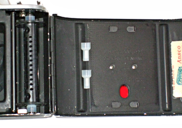

In the next photo you can see a 120 spool installed in my clipper. It is on the feed side; using the crimp connectors a 120 spool will also fit in the takeup side. ClipperCrimpsInstalled&OnView.jpg
Next to the Clipper pressure plate you can see another view of the connectors; this may help in identification.
Please let me know something doesn't work in this post. I don't use APUG often. It is doesn't work, I'll send you an email if you like.
I have used the screw anchor method on a Kodak 616 folder; it worked but the fit was not as good as these connectors in a Clipper.
Billdele in St. Paul

Like wire nuts except they are crimped to connect. Great idea. Only thing I don't understand is on the take up side, doesn't it need a key or key-way to have the force needed to wind and advance the film? Maybe if I had the connectors in front of me the answer would be self evident. Very inventive.
billdele
Mar 7, 2006
22
Hello, Fotch:
At this point, I have only wound dummy film through it with a 616 spool as takeup to see how the film unrolled with the connectors on the supply side; that worked. I think I will stick with that, modifying if the film doesn't take up neatly. As you say, to use the connectors on both sides something will have to be done to engage the 120 spool to power advancing of the film-- should be possible. By the way, I can't take credit for using crimp connectors: I'm sure that I read it somewhere-- don't remember where. I'm glad that some people on this forum are working on a way to use this camera; I really liked it years ago and am eager to figure out a way to use it again for a roll or two.

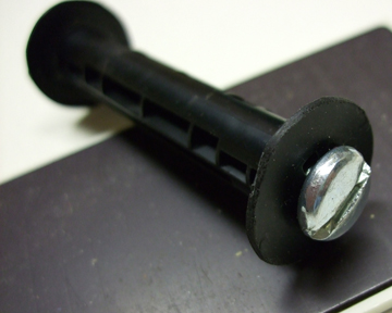

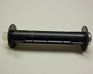

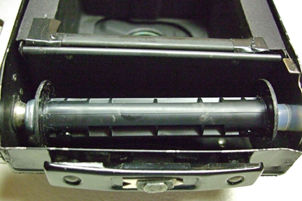

Months later I've pretty much finished my work with the Ansco Clipper discussed above. Using a modified 616 spool as a takeup continued to produce slippage and loss of focus in the center of the frame. Once I bought a 1/4 x 20 pan head machine screw in 3/8" length, I was able to use a 120 spool for takeup. (See earlier post for details and see photos that follow). Length can be adjusted by how far the screw is driven into the 120 spool; at first I thought the spool was binding because of end width and I clipped it around the margins slightly; probably this wasn't necessary because (I think) the binding came from tightness top to bottom; making it shorter (by driving it farther into the spool) is probably all that's necessary. At the end, I'll add two photos made with this most recent modification of the Clipper. It's a nice camera and can make a sharp, contrasty picture-- more than I remembered from 61 years ago. I still have things to figure out (a simpler system for measuring film advance, especially) but I can recommend the method described here for adapting 120 film to the Clipper.
