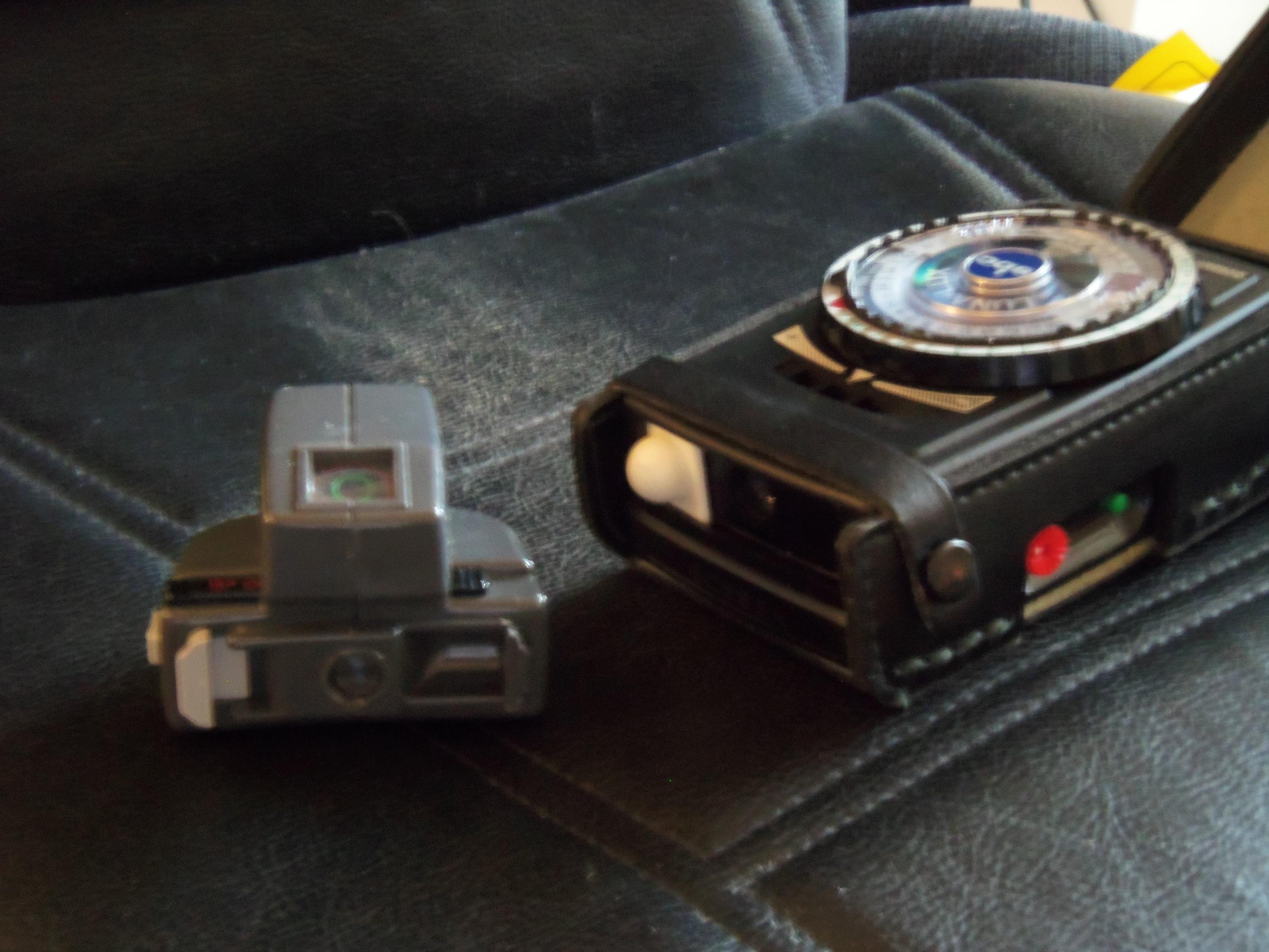

I just received a Gossen Luna Pro Spot Attachment. I also have a Luna Lux SBC which has a sliding incident light dome. The dome is in the way and I have to see if it can be removed and put back in without damage. Any ideas are welcome.

I wouldn't try removing the dome. Scary! I use that attachment on a Luna Pro (the old one, not SBC) and the dome needs to be positioned "just so" for the attachment to be attached. If slid all of the way to the end it seems not to fit but if slid just a bit back toward center it should fit -- at least mine does. I never use the attachment with the meter in the case, BTW.
Thanks Brian! I moved the dome away from the edge a little and then it attached! It even works correctly!

Steve... isn't the meter that you are using the same meter as in the manual link (post #7)? Luna Lux SBC with nulling LEDs? If so, it appears that you need to offset the exposure correction dial by 1 1/3EV when using 15deg or 3 EV when using 7.5 deg readings. The normal offset is 1 (or no offset). Described on pages 28 and 11 of the manual. Then you meter "normally" to null. It seems VERY important to remember to re-set the exposure compensation before and after using the spot attachment or subsequent reading will be all wrong.
The "automatically adapts" is misleading. The meter only adapts after you specify the proper offset of the meter for the amount of light it is being provided: 30 deg reading acceptance angle = offset of 1; 15 deg acceptance angle = offset 1 1/3; and 7.5 deg acceptance angle = offset 3.
If you haven't done so already, look closely at the attachment and you will see that it creates the smaller acceptance angles by restricting the amount of light reaching the meter. Smaller hole for 15 deg and even smaller hole for 7.5 deg. It is ingenious, but by it's very design must involve some compensation at the meter for the smaller amount of light hitting the sensor. :smile:
Luna Pro SBC aka Profisix automatically adapts
No it does not. It even can not. As there is no linkage between the meter and that small spot attachment, aside of the attachment's feet that are just a fixture.
With those attachments that connect via electrical plugs there is a linkage, enabling automated compensation.
... or to expand AgX's reply: the correction for the two settings on the spot attachment must be done on the dial calculator: set the light reading value to the yellow index mark for no spot attachment, green index mark for 15 deg spot reading, and red index mark for 7.5 deg spot reading. Nothing automatic there... purely manual. :smile:
BrianShaw and AgX I got it. Set the offset before taking the reading. Thanks.
