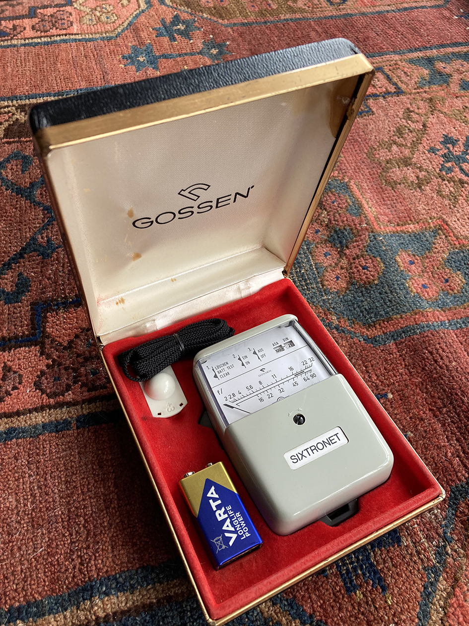

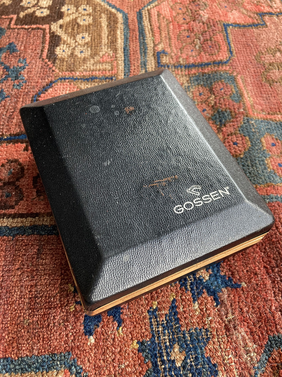

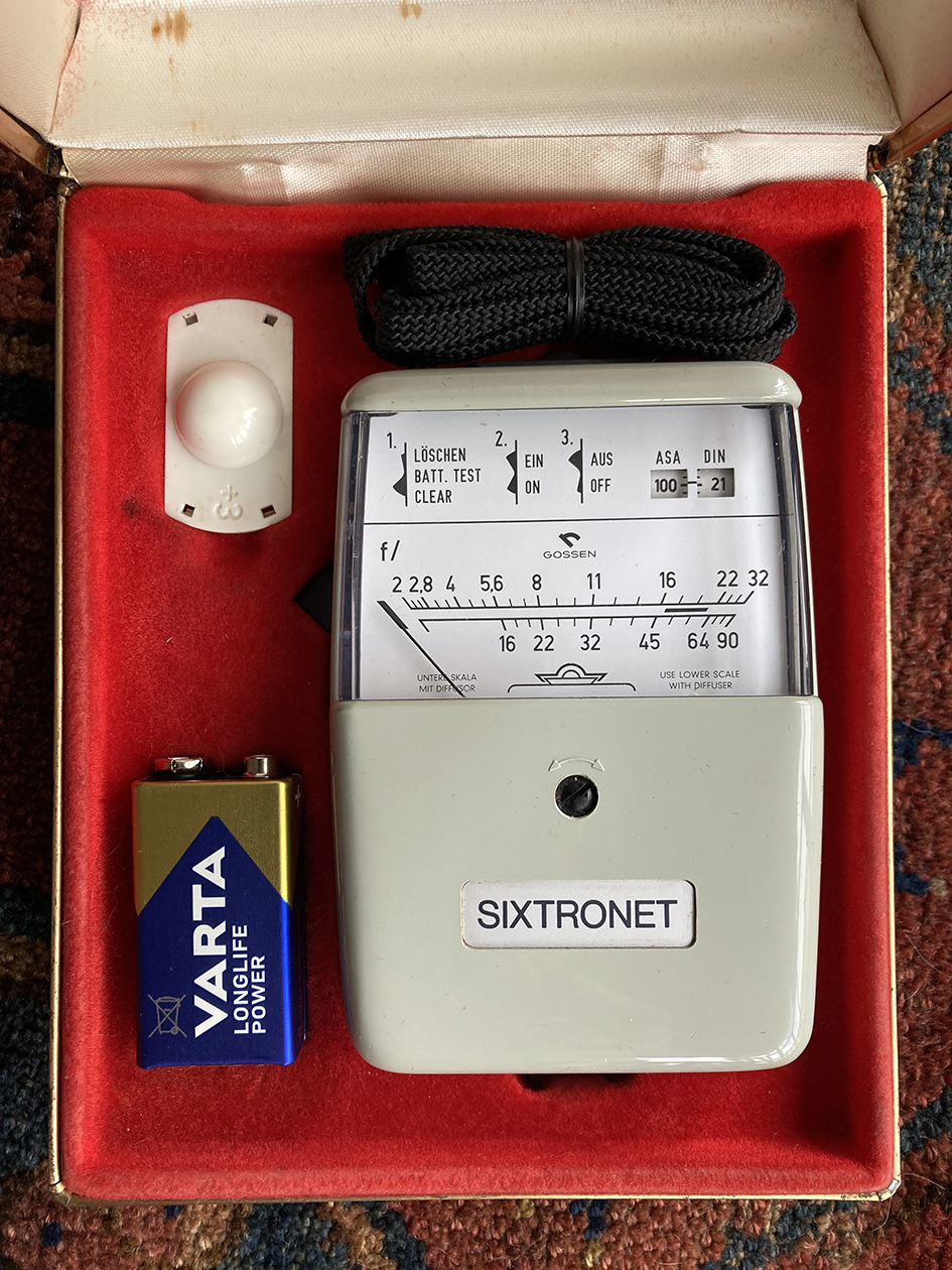

Here, as I promised, some photo's of that SIXTRONET flash meter.
It's presented by Gossen as a jewel, it coms in a jewel case, really much more better (and respectful) than these sloppy, often teared, hard to open and to-small-for-the-paperworkl (if there is some included) cardboard boxes light meters are sold in now!
There even is a dedicated compartiment for a 9V battery...

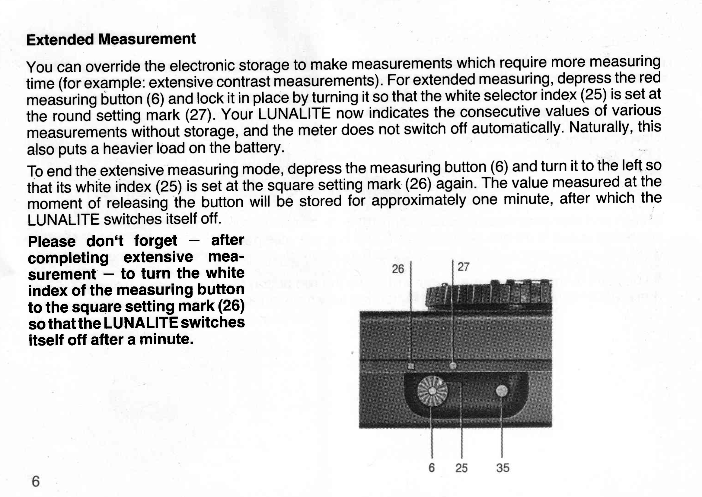

First check the position of the metering button. The white dot should be facing the light sensor. Not the other side.
the red button on the left has a ”locked on” position.
just use the other position.
mine was eating batteries, till Infound out I did not rtfm 😑
Do you mean the left function button? Please elaborate. How do you switch to an off position?
The screen shot below is from the owner's manual for the Gossen Lunalight. I assume other similar Gossen meters work the same way? Basically, these instructions explain how to enable or disable an option to keep the meter on for an extended time -- which may, or may not, be related to your short battery life (?)
The left button that’s used for metering. It’s got a white dot, that should point to the front (sensor side) when it points to the back, the meter is always on (locked) and batteries go very fast.
when you push the button, you can turn it..
that was the problem with my Lunasix F.

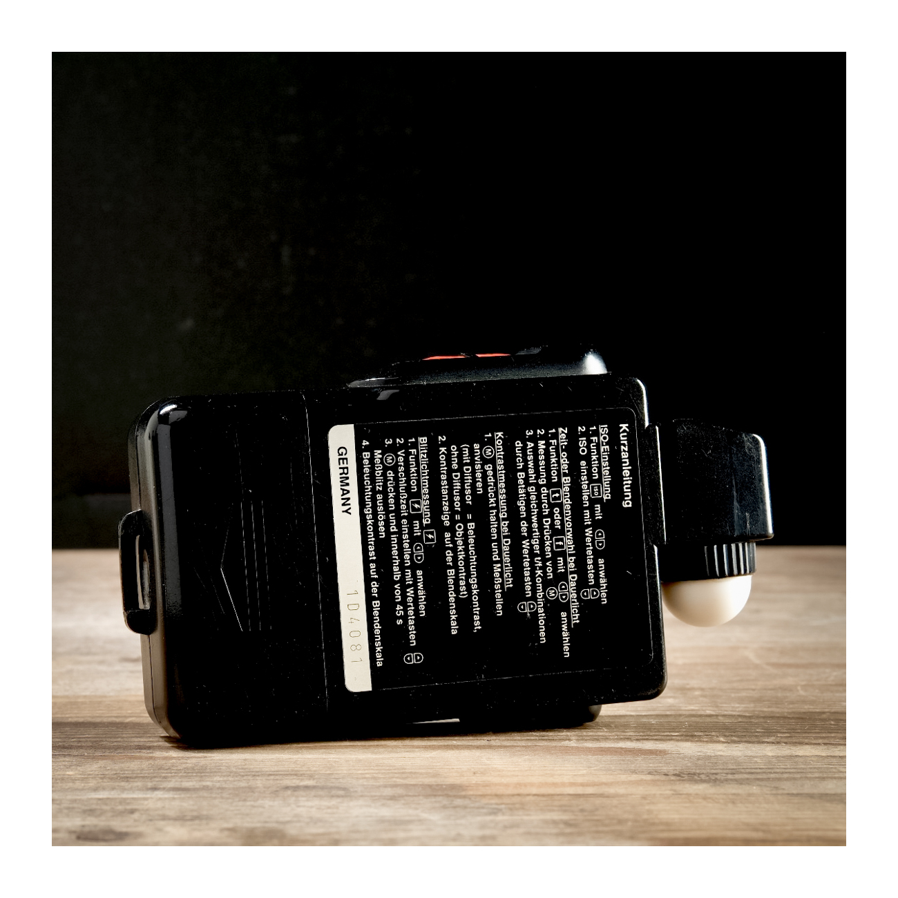

On the back side, carefully peal off the aluminium plate with the short user instructions and then you will see a few screws.
But first open the battery compartiment and take out the battery and, I don't really recall but, there will be an other screw.
I did it with the other one I had and was broken by sitting on it (yes that was stupid), but be careful as that plate is very thin and is easily damaged.
The knob's red rubber covers will fall out too.

No, I was talking about that plate on which the "kurzanleitung" and the serial number are printed. Just above the battery compartiment (see photo), it's glued with a kind of pasty glue that let you 'peal' off that plate. But be careful as it is rather delicate.
When this plate is taken away, you will find the screws in the corners of the slightly recessed space in which that plate fits. It could be that some glue must be cleared away.
Gossen's engineers ware masters in concealing screws...
thanks for taking the time. my Gossen meters do not have such a button.
