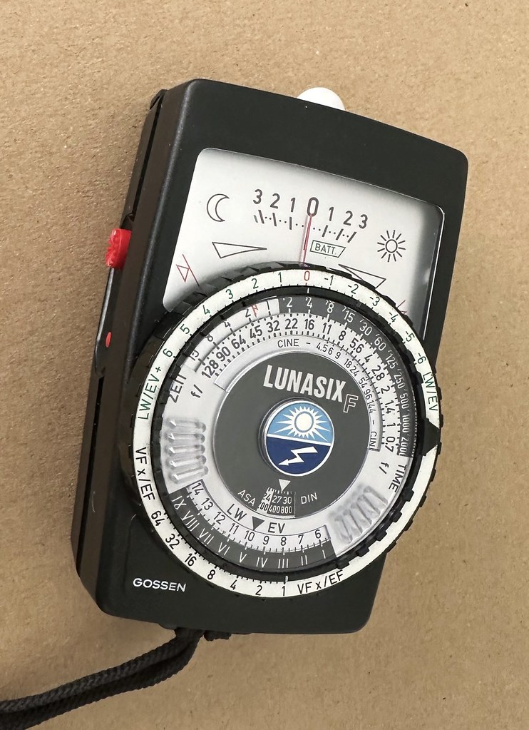

I only have recent consistent experience with a Gossen Lunasix F (aka Luna-Pro F in USA) which I currently own and use.
It has been powered for the past 13 month with a Varta Lithium 9V battery. No noticeable depletion yet. It is the zero-pointer needle type, and the needle returns to the inactive resting position after approximately 25 seconds.

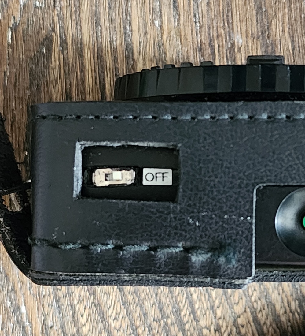

A few years ago I purchase a mint Luna Pro F. I put in a new battery and all was right with the world...for a few days.
The battery was dead. I put in another new battery and a few days later, same thing. Found no help online. I installed a mini on/off switch and turn it on or off as needed and battery lasts forever, or so it seems anyway.
