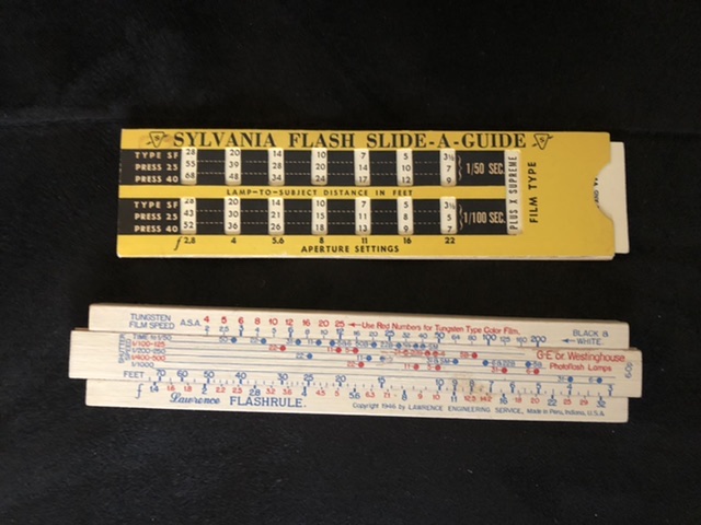

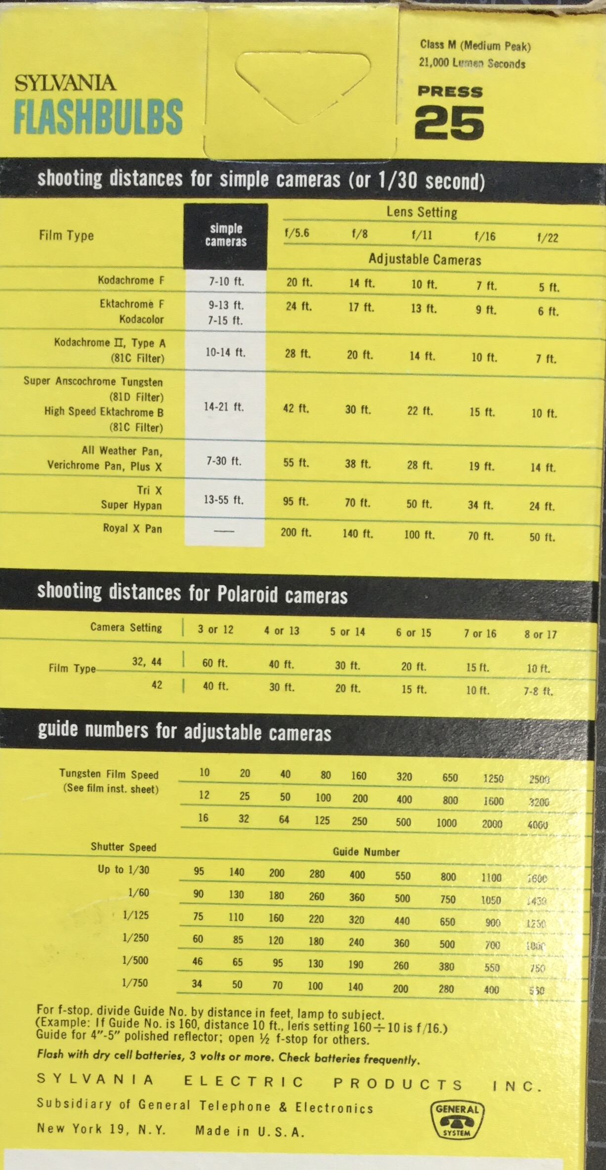

Got a fan type BC flash with a tower rangefinder and some P25 bulbs. Got a battery and a new capacitor on the way and trying to find a source of info on guide numbers etc to play around with this. TIA
I assume you don’t have the box, it’s usually in a table on the back of the box. I can check if I have it on one of my boxes.

The instructions I have just list films like "kodachrome, anscochrome, ektachrome, kodacolor" etc. I wasn't sure if there was a website I was missing that talks about using flash bulbs I wasn't finding. This looks like it could be fun!
Thanks!!! And from these guide numbers, that's an insane amount of light!
They do put out a lot of light, if you're taking pictures of people they will complain about loosing their vision but it's usually only temporary. I have done some bracketing tests by placing markers at different distances with the distance and f-stop marked on them. I also included a test patters with a range of colors. That allowed me to make a cheat sheet that I taped to the flash. I did this for my View-Master camera since it has a dedicated flash and there's only one shutter speed that works with the flash. I just guess the distance and set the aperture, works great.

If you plan to shoot with bulbs, I can't give a better recommendation than the Kodak Master Photoguide. Calculators, tables, and a whole lot more. You can find one cheap on the 'Bay or at major online dealers.

I'm curious - wouldn't the size and shape of the reflector have an impact on GN? And, with older equipment, the condition?
Some GN tables have different values for different reflector types.
Size, shape, and even finish of the reflector will have an effect on the GN; the 1977 kodak guide has guide numbers for "polished bowl", "intermediate" and "shallow cylindrical" reflectors. Bill Cress' site lists different GN tables for different style reflectors as well: https://web.archive.org/web/20180519103715/http://www.flashbulbs.com/ClearBulbs.htm . An old Westinghouse #11 bulb box I have states "increase exposure 1/2 stop for satin-finish type reflector"
... and as long as we’re discussing the myriad considerations that are important to consider when using flashbulbs, don’t forget the effect of shutter speed on GN. It can be significant!
see in posts 3 and 6, and the right side table in post #14.
