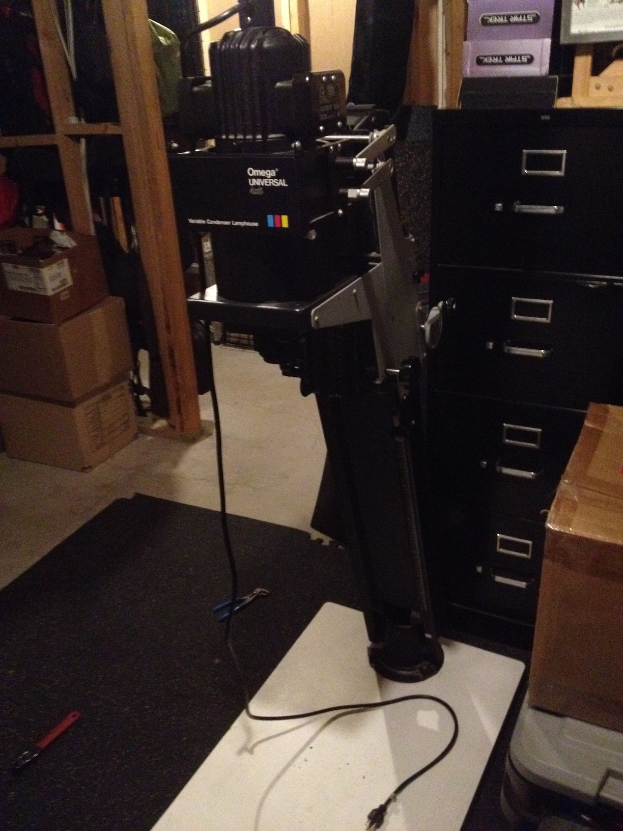

The easy part is over-- I bought it. It came with a 135mm F5.6 Komuranon-E lens and a negative carrier. $150. Some of the movements are stiff like it needs a good lube, but otherwise appears to be in good shape and with all of the pieces. Now to clean it up, mount it, align it, and take it for a spin. Thanks everyone!
