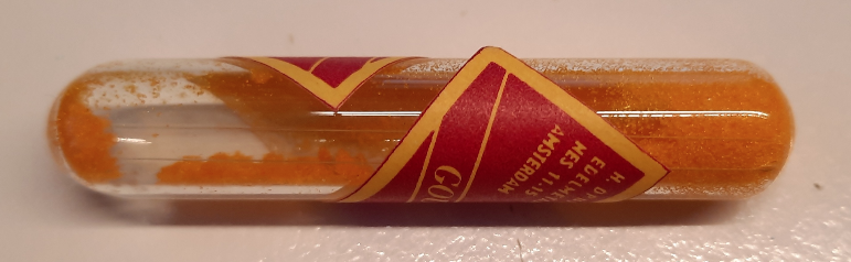

Used to be "gold chloride" was sold in sealed glass ampules. 15 grains per ampule. I have a couple Mallinckrodt ampules, I would estimate to be at least 75 years old. Beautiful stuff. Makes wonderful toners.
Yeah, I still have one of those here, too. Over here it was 1g, IDK if you guys got 30mg for free or we received 30mg short, or that companies actually measured different weights for different markets, LOL! It really keeps indefinitely that way. Beautiful stuff as you say.
That's what I have as well. They are 15 grains = 1gr. I don't know what the going rate it, but I mix them into a 1% solution for use -- 1 ampule mixed with 100ml of water. You can buy it in 1gm ampules or as a 1% solution of 100 ml. I have no idea which is less expensive. I'd advise against trying to mix less than 1gr, but mixing it yourself is E-Z, P-Z.
