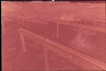

The LS9000 produces linear scans using Vuescan
I'm still interested in seeing these actual raw scans that would look something like this:
If it looks like a normal photo with recognizable colors it's already inverted and interpreted and something has happened which may or may not be linear. You never really know.
