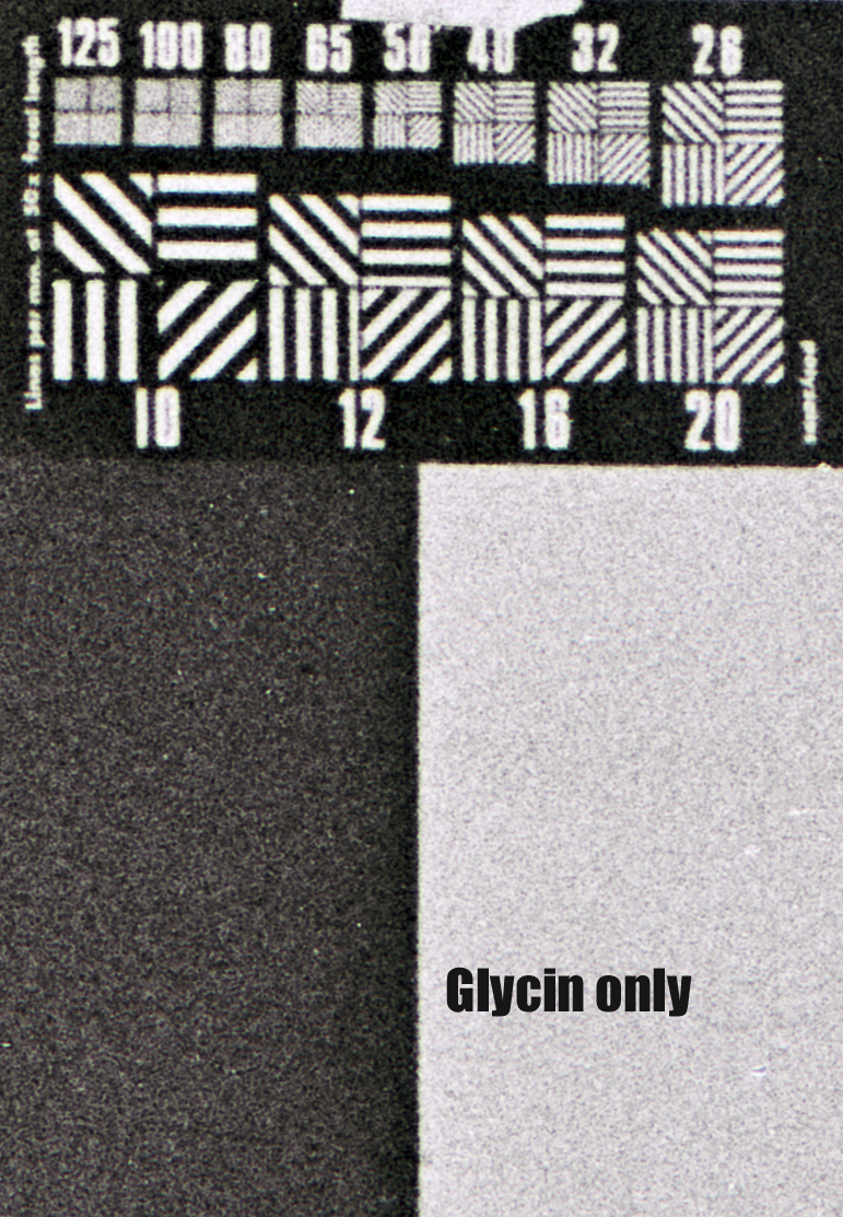

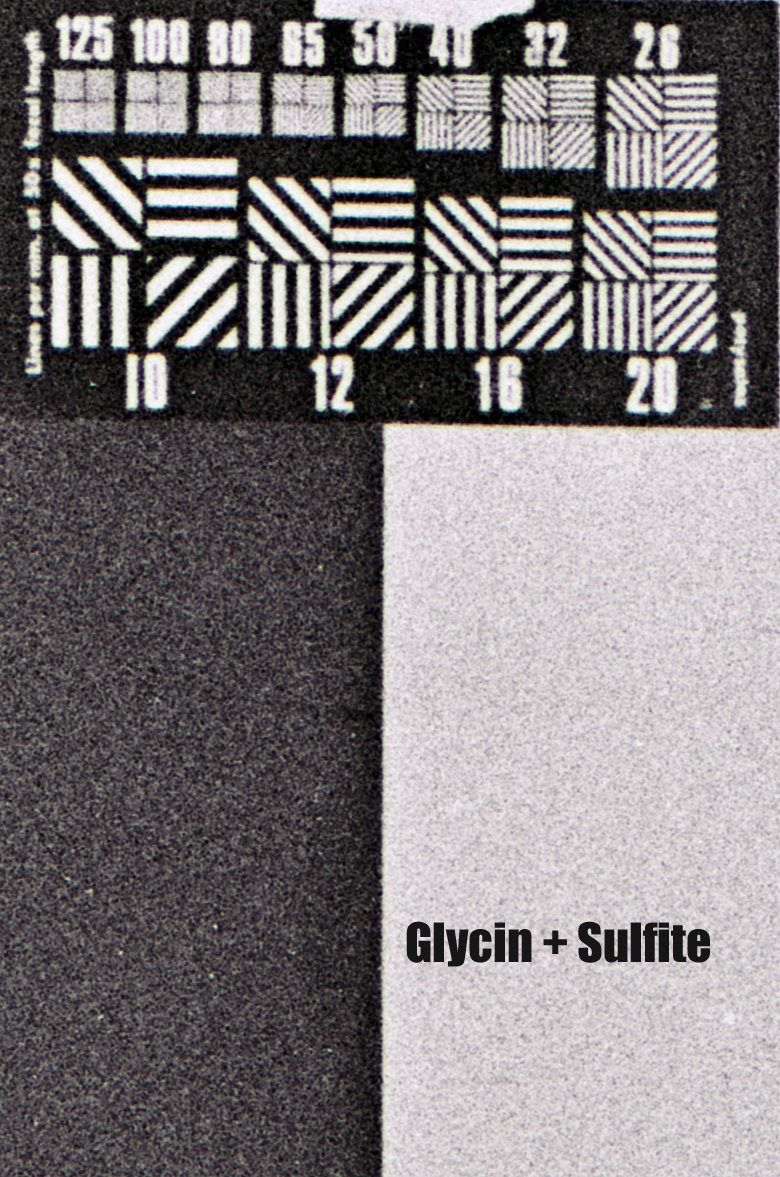

I tested an example formula with and without sulfite since read in the book by LFA Mason that, unlike metol, glycin will develop in absence of sulfite.
Photographs were taken of a dark grey card on top of a light grey card, including for reference a resolution chart taken from the correct distance.
Old style Efke 100 film was used to better show up any edge effects.
Development was in glycin-carbonate, 1g glycin, 5g sodium carbonate anh, water to 1L and
glycin -carbonate-sulfite, 1g glycin, 5g sodium carbonate anh, 5g sodium sulfite, water to 1L.
Both were developed for 1hr at 22C with agitation at 30 min only.
All dissolved in a few minutes at 35C. Results are shown in the attachments, processed identically. The width of the full 35mm frame is about 14 times the width of the test chart.
Conclusions to date:
Added sulfite makes no visible difference on the attachments but it does prevent the slight fogging/tanning seen with glycin alone.
There is a dark line at the border of the dark grey card with the light grey card. Hopefully in field tests using FP4 this may provide the sharpness from edge effect wanted.
I think it is called a Mackie line.

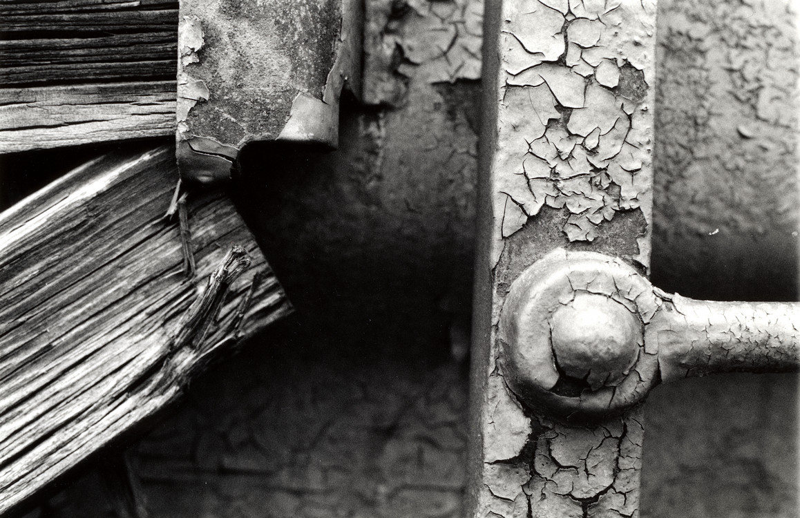

Conclusions from a field test using Adox CHS 50 (~Efke 50) and FP4 type 517 cine film semi stand developed:
High contrast subject:
Adox CHS 50 shows edge effects at high magnification (On computer click the image twice).
FP4 cine film shows somewhat less edge effect:
Low contrast subject (pics of piling rig on Flickr) -edge effects not visible with either film.
The glycin -sulfite- carbonate developer gave streak free images using plastic reels with semi stand development for 1 hr 22C.
This suggests it may be possible to get a better result using stand development with no halfway agitation in the case of glycin.
I used GSD-10 1:20 to develop FP4 cine film semi-stand 45m 22C. There was some unevenness in the sky in some cases.
With full stand the sky was mottled, ruling this out.
For comparison ,half the film strip was developed in PC-512 Borax.
Conclusion- using semi-stand glycin any edge effects are hard to see. They only show up in contrasty lighting with shots taken against the sun, post 14,and not too clearly there.
The grain is coarser in the glycin developer pH~11 than in PC-512 Borax pH<9.
