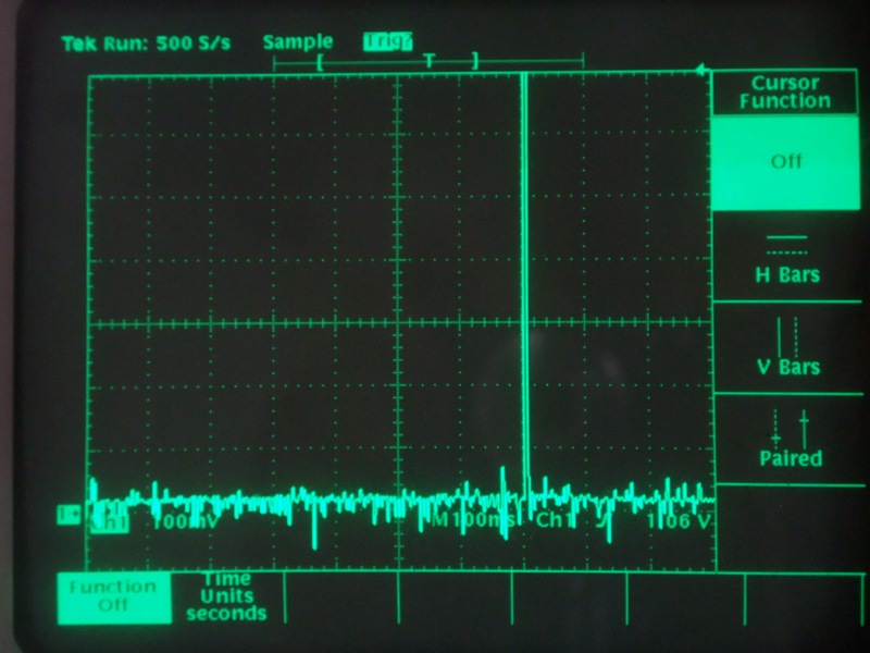

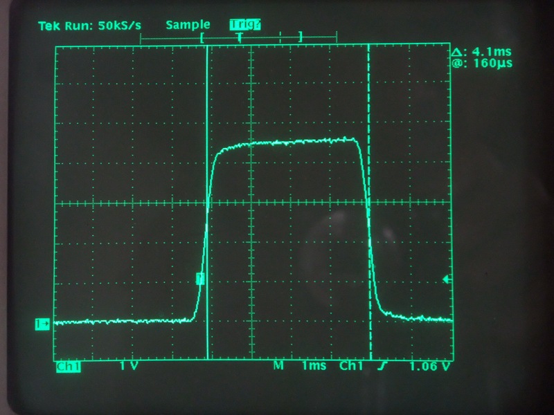

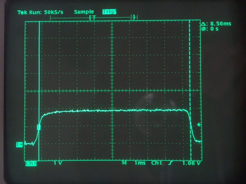

Illumination versus time in focal plane
A further confirmation would be to record the light in the focal plane during one cycle, and to confirm that an extra, spurious, pulse of light occurs before the main exposure. This would confirm Brett's explanation, and definitely kill the idea of shutter bounce. Setting up that test my take a few days
Below the result of that test. Performed at two shutter/aperture combination that resulted in well visible ghost image in the previous film test (post#21). As a preliminary, I measured sound-wise (laptop, microphone, Audacity) the duration of the mechanical sequence of the Contaflex: 300ms at most. Purpose: to know how early before the main shutter exposure to look for a spurious illumination, as proposed by Brett Rogers, even though I did not see anything in a visual test (post #22).
1/250 f:5.6, main exposure. hmmm, shutter is slow by 0.1ms (2.5%) not bad for such an oldie.
Ditto, looking for extra pulse of light. Vertical sensitivity boosted x10; horizontal scale 100ms/div, spanning 1 second total. Nothing there!

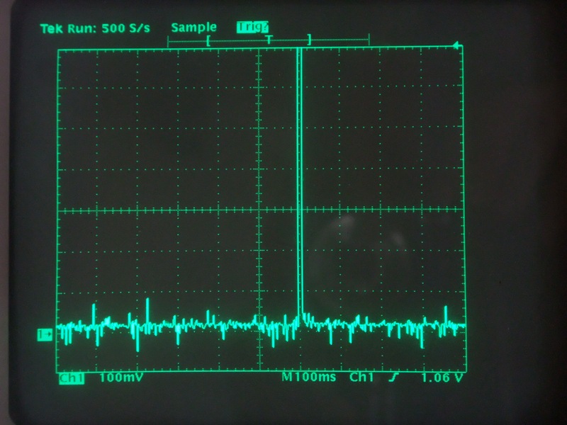

1/125 f:8. hmm shutter is slow by 0.56ms (7%); I'll let it pass this time.
Ditto, looking for extra pulse of light. Vertical sensitivity x10; horizontal scale 100ms/div, spanning 1 second total. Nothing there!
"grass" is just noise pickup

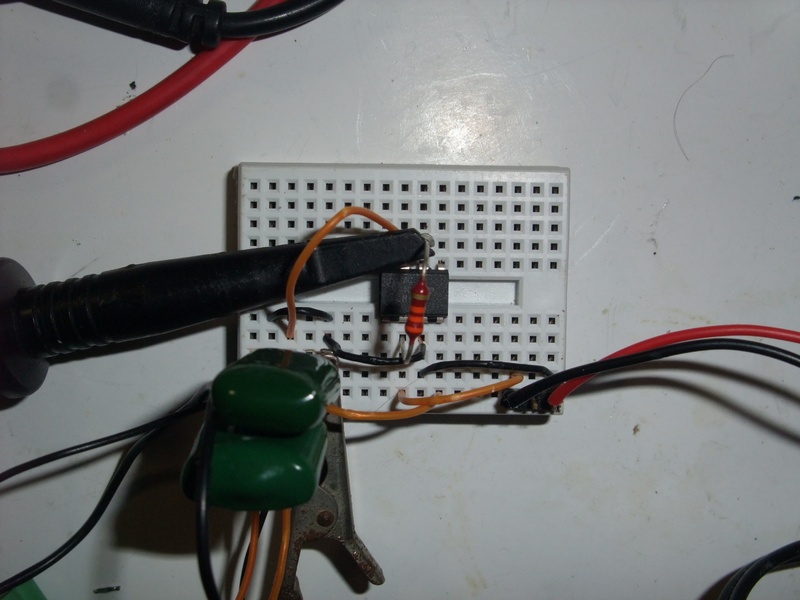

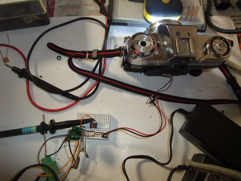

For those interested, two views of the setup:
The circuit operates the detector (vintage Se cell) in true photovoltaic mode (zero bias), which ensures wide-band and linear response. However, because the light source is not properly defined or secured w/r the lens, the intensity scale calibration is not maintained accurately between successive measurements. Someday I'll build myself an exposure checker. Someday.
So, here we are. No extra pulse of light on the time axis, whether before (post #19) or after (my "bounce" hypothesis).

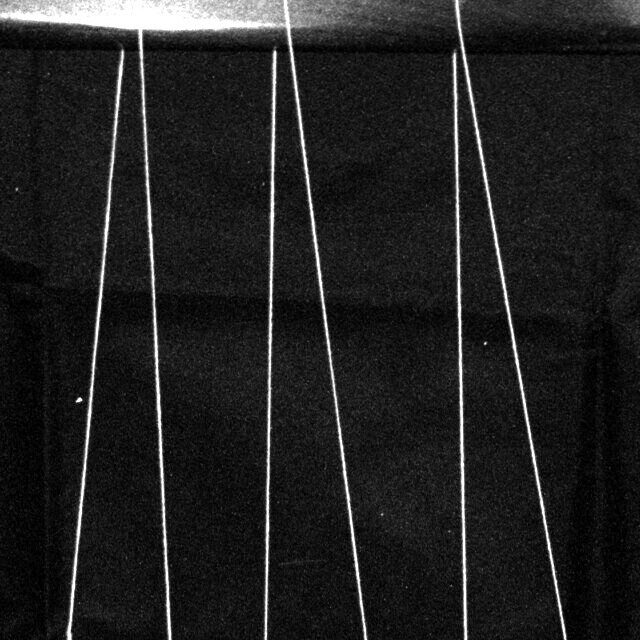

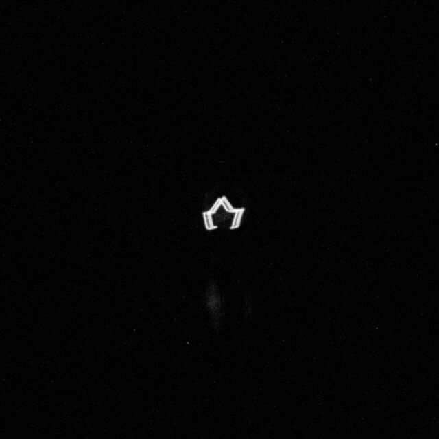

And now the remaining tests of the 2do list. I shot 12 frames, but will show only 4, and you'll have to trust me that they are representative. All shot with 85mm FL, at approx the same distance as in the previous series of film tests.
Flash exposure. No ghost. This eliminates an optical ghost. Setup: thin white string against a black cloth. 1/250 f:5.6.
Hand-held. Tungsten filament (same as previous). 1/250 f:5.6. Supply spool un-wound completely, i.e. as loose as possible. Ghost as usual.
Supply spool re-wound fully an held tight during exposure. 1/125 f:8. Ghost is here!
Supply spool re-wound fully an held tight during exposure. 1/250 f:5.6. Ghost is here!
So, whatever is causing the ghost is not affected by tensioning the film against the sprockets. I'm loath to give up on that Contaflex; actually, it's a Super BC.
Where was the flash with reference to the camera?

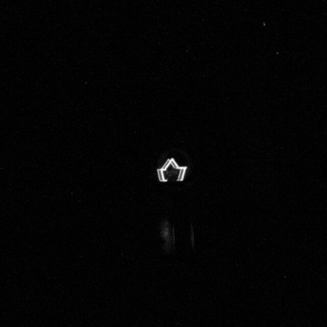

Latest and probably last tests.
A) Re-do basic test. Just for consistency. Hand-held. Distance to bulb 3.50m.
Top row: 50mm, bottom: 85mm. Left column 250 f:5.6, right: 125 f:5.6
B) Camera resting firmly on the tiled floor. The idea being that some internal part motion during the exposure sequence might cause the camera as whole to shake. Same layout as above. Results not better, not worse.
C) Sprocket wheel dis-engaged. By putting camera in "rewind" position. Testing (again, but differently) the hypothesis that the film advance mechanism might jolt the film. Proposed by MattKing, #36 above. Problem still there. Ideally I should have made several repeats of that, but: (a) the effect is still with us; (b) I was unsure how the film advance mechanism would behave after going back from "rewind" to "normal", possibly making a mess with zero usable pic;

Conclusion: probably some play in the focusing helicoid, actuated as a collateral effect of whatever mechanism by which the main body tells the shutter to actuate. Even if the slack is more pronounced in the vertical direction, this seems to point at the cause in general terms at least. And an helicoid with some play is not repairable (at least not by me). Unless the slack is located in the mechanical link between the base of the helicoid and the main body. Brett Rogers, Mark Overton, Others: Is that easy to access, maybe under the front leatherette?
