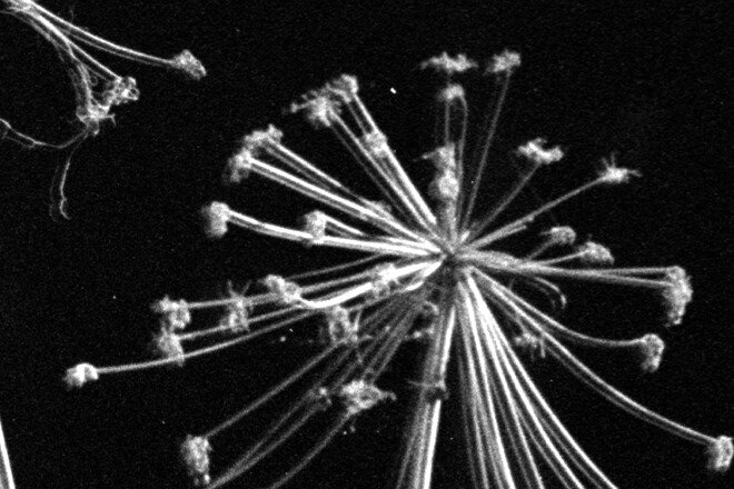

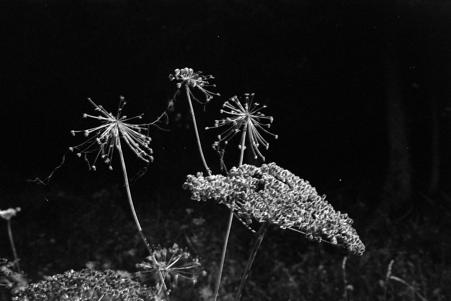

Made the first test of my second Contaflex (Super) body, bought last June. Some images show a ghost image, offset from the main image by a small amount. Most noticeable on pictures taken with the 85mm pro-tessar. Some pics with the same 85mm (and same body) do not show that problem. Still unsure whether the problem might be present with pics taken with other lenses (50mm Tessar, 35mm pro-tessar). See attached pics: full frame, and two details @2700dpi (yes, I know; but how can I communicate my problem??)
The secondary image appears to be offset along a direction between 2 o'clock and 3 o'clock; the twigs along that direction appear as single. Nothing is rattling inside the Pro-Tessar 85mm (Zeiss construction). The only (tentative, incomplete) explanation I can come up with is some mechanical jolt occurring in the middle of the exposure. The problem might be made more visible by, but not caused by, the longer FL of teh 85mm. Mirror slap? Is that a Known Issue (as they used to call bugs at Microsoft)? Thank you in advance for insights.
Surely motion blur, caused by mirror slap or anything else, would be just that: a blur. The ghosting appears as a faint overlapped and offset image, as distinct and sharp as the main image, so surely it must be caused by some kind of reflection or refraction. Are you using a screw-on filter? Screw-on filters won't inherently produce these kind of artefacts; I'm clutching at straws really.

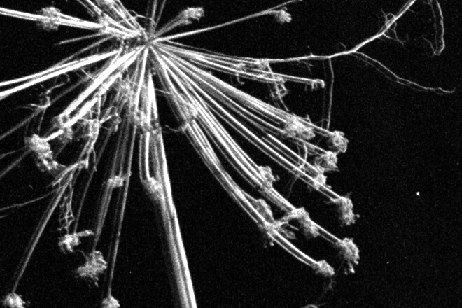

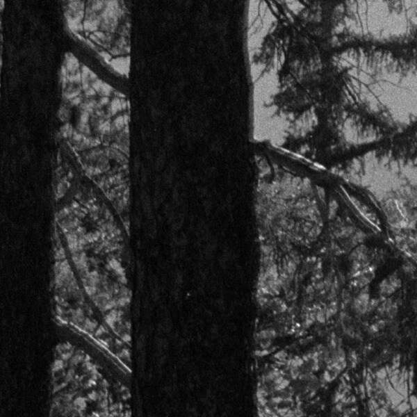

To answer a question that might come: the example I showed is not unique. Another example, also shot with 85mm FL, which helps to put in evidence small camera motion:
See the ghosting on the bright upper edge of the branches sloping from upper left to lower right. Because the ghost image is weaker than the main, it tends to be washed out for dark features on a brighter background, and to show better for bright features on a back backdrop.
And, BTW, the fact that ghosting is more apparent on images shot with the longer FL argues for camera motion as a whole, rather than film motion inside the camera, which would produce identical amounts of separation independent of the lens FL.

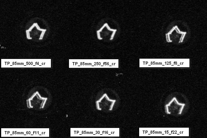

Test shots -- As promised
Yesterday evening I developed the test shots, and this morning s*****d them. See attached pics. The subject was a 15 watt 220V bulb, powered with 120V. Located approx 3m from the camera. Exposure guesstimated to have room in the dark and filament above middle grey (anybody has a spotmeter that can measure an incandescent filament??); in that respect the results meet my expectations. Each series runs from 1/500 f:4 to 1/15 f:22, except 85mm hand held where I stopped at 1/30. Images shown are 240x240 crops @ 2700dpi.
Hand held, 50mm Tessar
Just like in the "natural" images that prompted my post, the ghost image seems to be to the left and slightly below the main image. The ghost becomes relatively weaker a longer exposure times; and conversely at 1/250, the ghost is brighter than the main image (or the offset direction has reversed). At 1/500 no ghost is visible
Hand held, 85mm Pro-Tessar
More or less the same observations as for the previous series. Again at 1/500, no ghost is apparent.
I'm surprised and gratified that, ghosts apart, the main image shows no motion blur at 1/30 hand held (85mm); didn't know i was that good:happy:
Tripod mounted, 85mm Pro-Tessar
Ghosts are still there (!) and with an offset globally of the same order of magnitude as in the previous series. The direction of the offset, almost horizontal, is also the same. And now we also see a ghost at 1/500. I didn't know my tripod was that bad:sad:

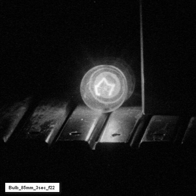

Bulb "flash" with open shutter
A test proposed by IanC in a so-called conversation. Original proposal: shutter in B. Open shutter, trigger flash, close shutter. Which I did, except instead of firing flash at reflective target, I turned on/off the tungsten bulb, same as previous tests. Approx 3s @f:22, more exposure than other test shots, but the dynamic range of the film copes with that. Possibly some optical ghosting of the lamp, but the filament shows none of the duplicate ghost seen previously (that would have been quite a puzzle, which is not a reason for not doing the test).
What to make of this experimental material?
The data might fit with what is proposed by Brett Rogers (thank you for your detailed write-up). Brett, do you agree?
A further confirmation would be to record the light in the focal plane during one cycle, and to confirm that an extra, spurious, pulse of light occurs before the main exposure. This would confirm Brett's explanation, and definitely kill the idea of shutter bounce. Setting up that test my take a few days, so anyone interested in the outcome should make sure he/she has thread watching turned on.
Again thanks to all for their attention and suggestions.
You could try isolating the functions of the shutter closing and mirror and capping plate lifting from the exposure process, by setting the self timer, so that the exposure process is delayed. This will enable you to assess the initial phase of the mechanism by itself and, with the back off the camera, should any light penetrate through the lens before the timer has run off and released the shutter, it may be visible. If so, it would be confirmation that I may be onto something above
I had overlooked this (sorry about that). I did the test. 1/125 f:2.8, self-timer, camera back removed, LED flashlight into lens, me looking from the back. Normal exposure (after self-timer delay) produces a very distinct flash of light, nothing at all is seen when shutter button is pressed and capping plate lifts, uncovering the rear of the lens. Repeated 5 times.
<<scratches his head>>
