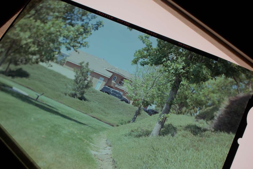

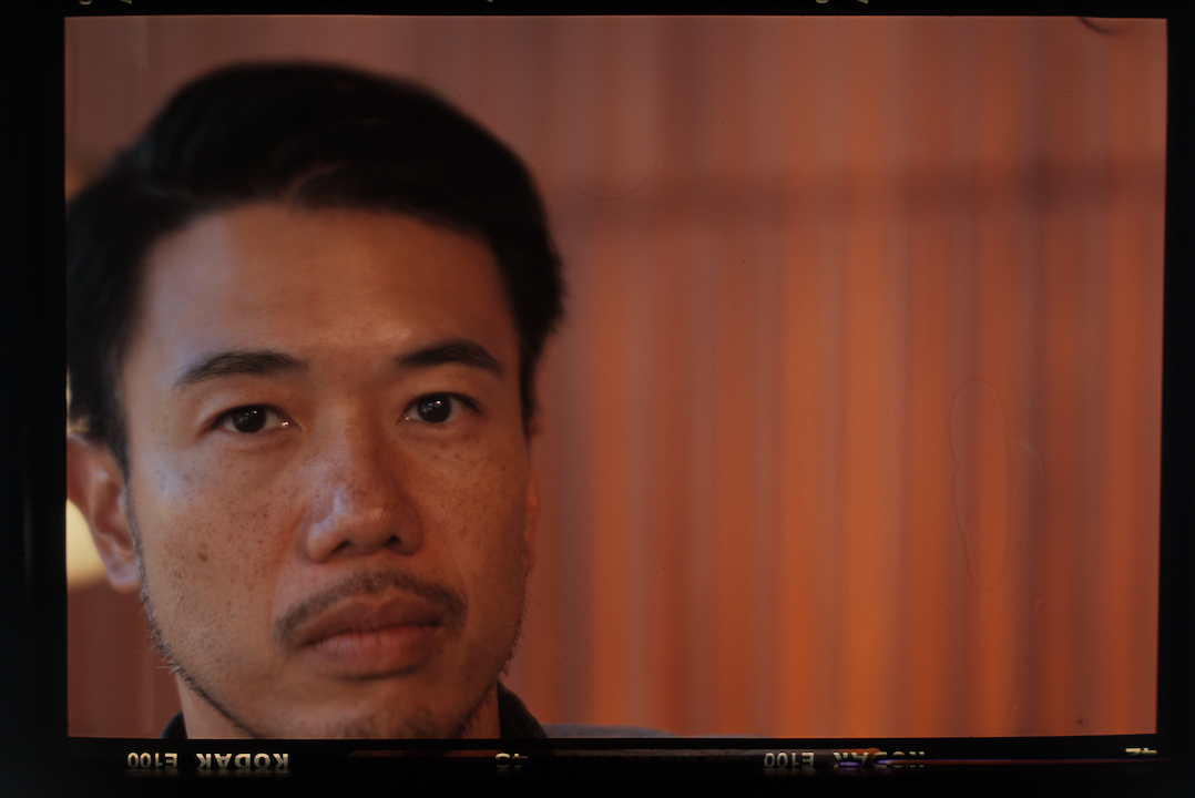

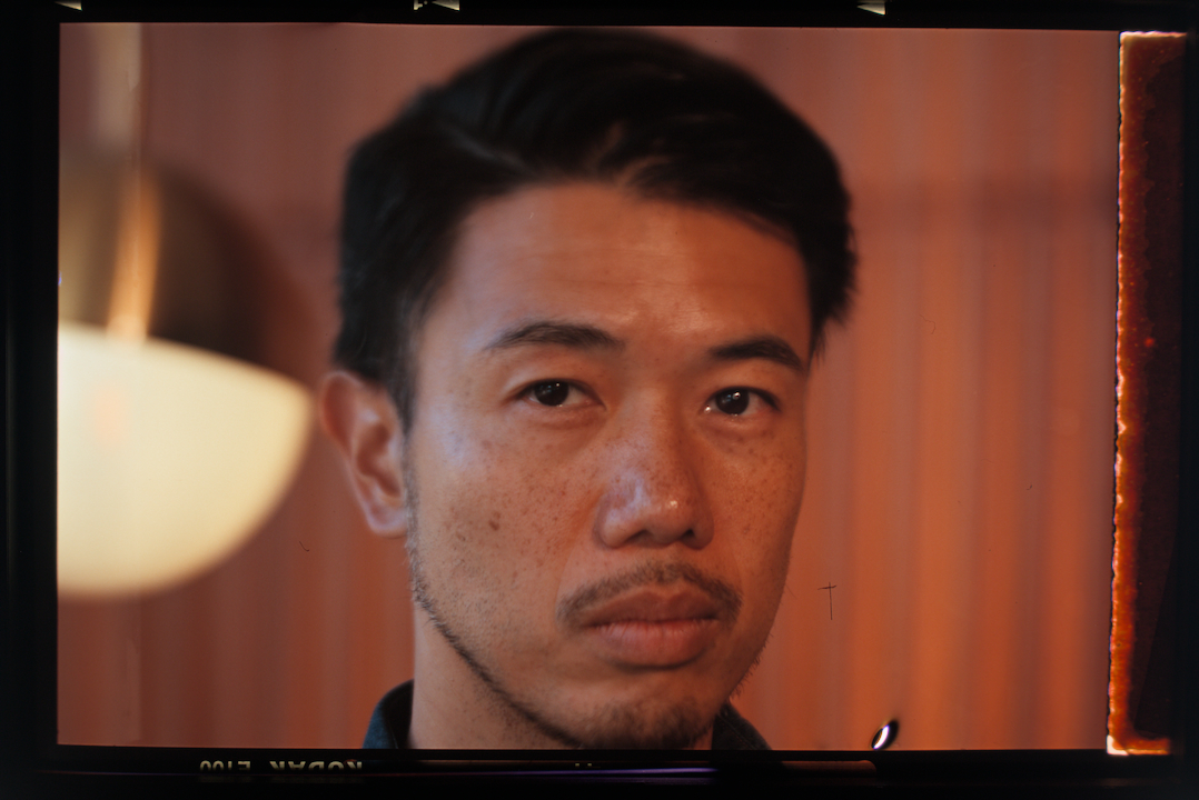

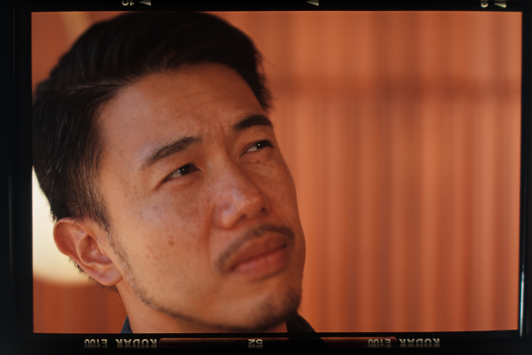

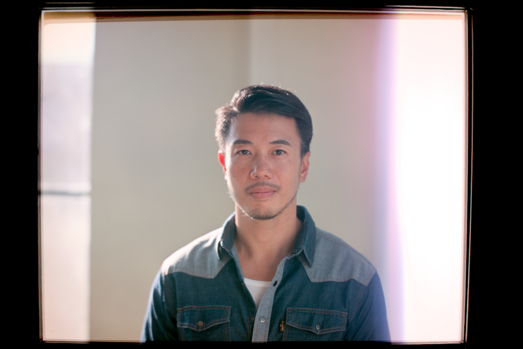

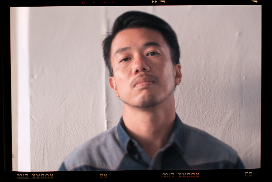

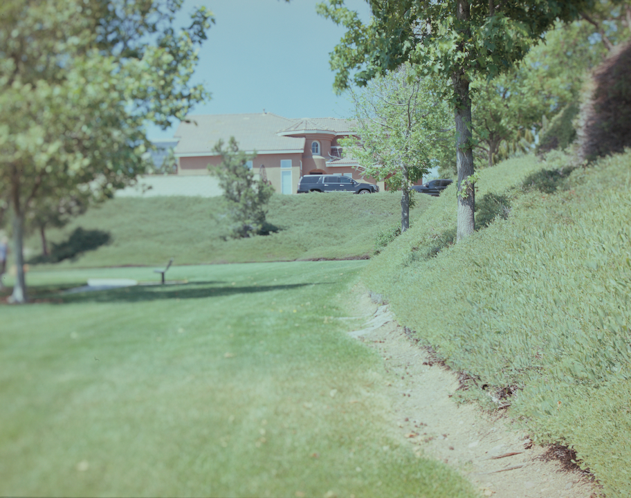

Finally getting some more time again for shoots and experiments; Got my hands on some Provia a couple months ago, here are my results. The portraits have a Mole Richardson (2k, 3200k) on the right side with natural light coming through the window as fill (colors look a bit more accurate in person), the other two are natural sunlight. I developed these 4 with the Dynamic Chrome (D9), 1+2 dil for 10.5 mins, the other two cycles for 9 mins each. It seems to be well developed, let me know what yall think. (I should be able to shoot more provia and e100 then dev with Bellini to compare later)

I never shot Provia, but that outdoor scene does not look like it was shot on slide film. The contrast and saturation are too low and there seems to be some color cast (cyan in highlights and magenta in shadows?). What format are you shooting? Assuming it is sheet film can you make two identical exposures and have one slide developed by a good lab to use as a reference?
Unrelated to the subject of the thread but how did you manage to have the tree on the right in focus and the one on the left out of focus? Swing?
It looks better in person, but it is definitely overexposed (I remember it being a very bright day!). The magenta you see in the top right shadow is just a magenta bush, but the highlights are definitely blown out and possibly a color shift, the highlights on the tree look color accurate (at least in person), heres a raw from the camera thats a bit more accurate to what I see (still a bit off, there isnt as much as a cyan color cast on the whole image it looks more yellow in person, idk why my camera or darktable is processing it like that). But it does seem a bit off regardless and that just might be the claimed "wanted effect" from cinestill D9 at 1 to 2 dil which claims to give it an extended highlight latitude, which also may affect provia differently especially direct sunlight vs tungsten/mixed lighting. The third picture of the keycaps, seems to be color accurate, but is diffused sunlight through a window rather than direct. This is 4x5 and I definitely will be doing some identical exposure tests! I'll most likely send one to The Darkroom to see what they come out with and will also be comparing these to a bellini kit down the road.
Yep! I'm using a front swing and a asymmetrical rear swing on an Ebony SV45U2 creating a sort of thin wall of focus on the right, from the lens to the house

There's something very odd (not in a good way) with the color balance. Your portraits are entirely magenta/red, much more magenta than you'd expect with 3200K light on a daylight film. The outdoor scene looks very very flat and with a very strong cyan cast. The product shot looks desaturated. I'd say there are some major processing problems going on here.
I'd suggest getting some proper E6 chemistry; ADOX just launched their E6 kit. Might be worth a try.

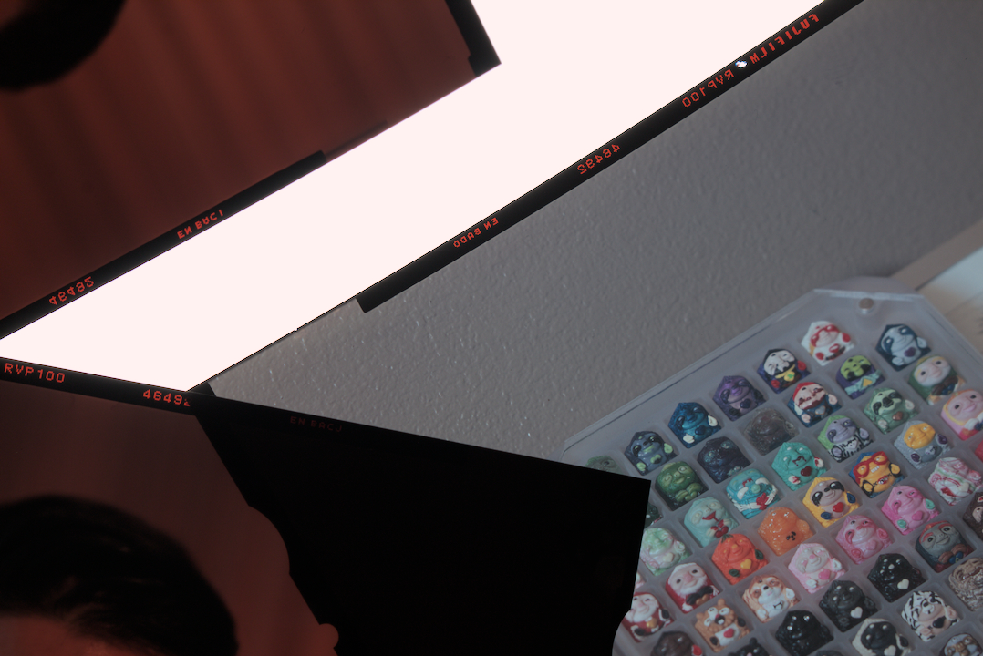

Did Fuji really change the edge printing from yellow to red?
First time I'm seeing this but I haven't shot any E6 in a looong time.
Glad you pointed that out! the edge is more orange in person and noticed darktable was trying to auto adjust temp, so I fixed it to be 5600k(sunray iii box). I changed the portraits and you can see what it actually looks like more accurately(still has that magenta/red), the fuji logo is a darker orange going towards red rather than yellow, so I wonder what the D9 is doing (what extended highlights actually means). This is the 1 to 2 dilution so I'm curious to see what 1 to 1 gets me.
Very odd, but like I said, maybe they changed the color of the edge print? It used to be yellow with a small hint of magenta, so as to make a 'warm' kind of yellow that went into the direction of orange, while still remaining convincingly yellow. If they haven't changed it and the edge print does come out like the red/brown as shown in your photos, something is going very very wrong with the processing.

I suppose it refers to compression of the curve. This is what's seen especially in the outdoor shot.

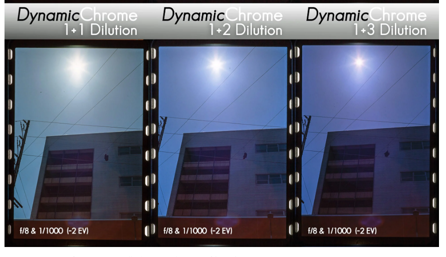

As evidenced by the Cinestill examples, at least some sort of severe color shift.
To each their own and all that, but in all honesty, I don't think this Cinestill approach to E6 is very successful. Provia is an excellent, beautiful film when processed normally. I'd really recommend giving it a try with proper E6 chemistry so you know what can be gotten from the film. You could then always go back to the experimental approach to twist and turn the curves in a non-standard way.

Judging by examples in this thread I agree with @koraks .
The situation with E6 kits has improved and even here in Australia we have Bellini, Ilfocolor and Cinestill (with D9, which is the most expensive option). If I were to shoot a lot of slide film I would choose between Bellini and Ilfocolor. And I won't be saving much by processing it myself compared to sending to the lab.

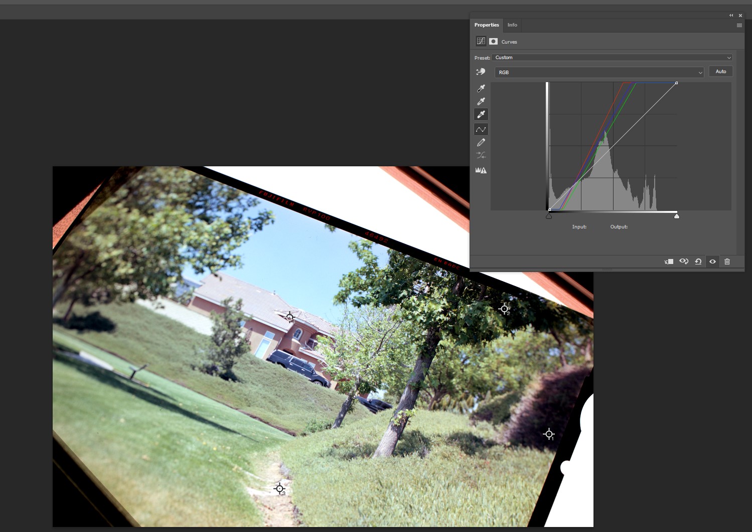

It's hard to tell where the crossover is coming from - maybe from ambient light?
That looks much better. So you used custom curves to tweak the gamma of each channel. I checked the characteristic curves of Provia 100F and the three channels are nearly identical up to the density of 2.5D. To me this looks like a problem with processing. From what I read the first developer is the most critical part of the process so I would start troubleshooting there.

I did not play with the curves - I just defined a dark and light point, there is no minute. A quick way to see the linearity of color channels...
wow ya that looks exactly to what I see in person! Thanks for fixing it, I'll have to remember setting dark/light points when needed.

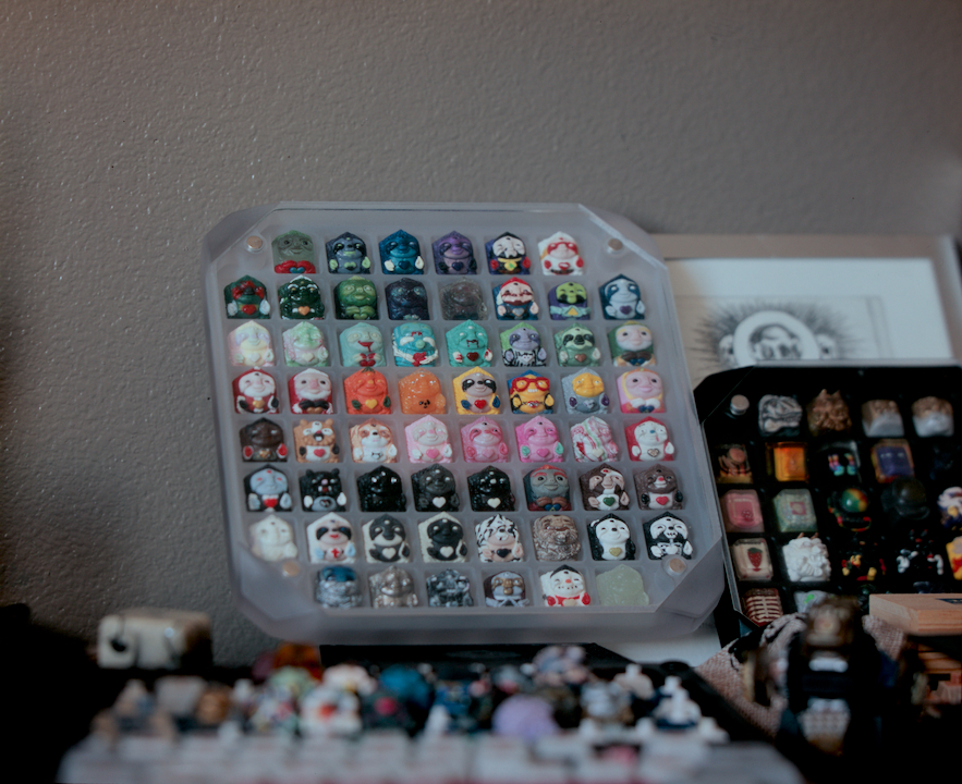

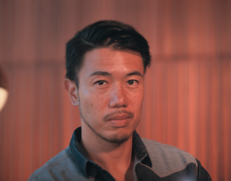

Did some D9 (DynamicChrome) 1+1, 9 mins for every cycle. The last two are Velvia 4x5, also should note the last slides I posted were Velvia as well sorry for the mistake. The rest are E100 120 (6x9)

They look nice!
With regard to the last few images: it's a little odd to see an Ektachrome slide that's more saturated than a Velvia slide of the same scene. But in the case of the Velvia shot, there seems to be a large amount of lens flare, which degrades contrast (and saturation), so it does make sense - it just made me look twice!
Anyway, not bad at all, especially the Ektachrome. On the Velvia slides there's a lot happening and I can't tell whether it's related to film/processing or shooting conditions.

Yeah it seems the 1+1 for D9 is the much better choice for the ratio. For the Velvia it definitely had more going on shooting wise (obviously that light leak), those were the first couple shots of the session so the sun was close to be at its highest vs. the e100 equivalent which actually were the last shots I took so the sun was starting to go down, and the lens directed at the window ofc.
