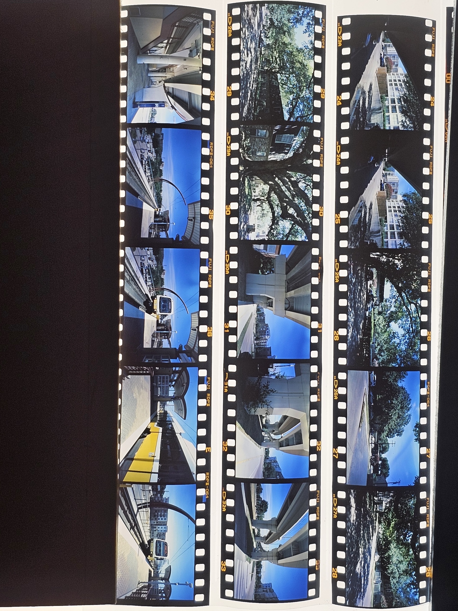

I ran the second roll at 11min 30sec in the first dev. This is 25% longer than the minimum time Cinestill recommends. Based on other chemistry this should provide 1 stop of further development. The film turned out just as expected; the trannies are spot on. The dymanic range is very impressive. Look at the shots under the viaduct. The bright concrete sidewalk and the very dark underside of the viaduct are all well rendered, while the slides retain great contrast. Provia is very good with dynamic range anyway, so I can't know if this is the chemistry or the film. There are some turbulence marks around the sprocket holes and something weird happened to the sky happened in one frame. Both of these happen on occassion so I won't blame this specific chemistry.
My opinion (based on two tries) is that this chemistry is completely usable. The real problem is that Cinestill is trying to oversell this as being able to create different "effects", which are actually just over and under development. They should have stuck with recommending 11-1/2 minutes for the first developer with instructions for pushing and pulling, like other manufacturers. My only other gripe would be the excessive first developer time. This is nearly twice as long as other chemistries. I've got a rotator, so time isn't much of an issue for me. But if you're doing manual inversions it would become a pain.

Forgot this.

Well, that still looks very blue/cyan to my eye!
This is not necessarily very surprising since extended development will likely favor (relatively speaking) the lower, cyan layer of the emulsion stack, tilting the color balance in that direction.
It's Provia! It looks like Provia.
Quite the difference! The colors look way better than the first time and the shadows definitely show some good range. Yeah it seems like their timing is one of the biggest issues so I'll mark that time down for the Dynamic and see what I can come up with (I'll try to grab some provia too), I do manual inversions so I'm sure it'll help the carpal tunnel set in lol
No no you're definitely right, Provia at least from what I've always seen and always known has had the magenta type tint to it (not to say those slides aren't provia Im sure they are), no matter the kit. So these are definitely more blue/cyan. I don't think it being expired from 2019 would cause this, Cinestill claim this with their Dynamic dev (containing Sodium Sulfite and Hydroquinone),
  • Preserved highlight and shadow detail with rich tones for a more cinematic look
  • Renders slightly warm tones in daylight, shade, or with electronic flash
  • Optimized for scanning
So I'm not sure if that would cause this color shift along with the extended development time, but it would explain Ivon's red shadows at Train tracks
