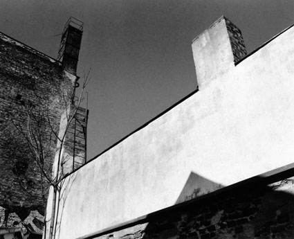

For the urban landscapes that I now do, I prefer the skies to be a good strong mid grey. This I achieve with no filtration at all. I use Delta 400 in a two-bath developer and I get the skies I want with no need to burn them in. During my most recent exhibition, a number of visitors enquired what filter I used and were visibly shocked when I replied "none".
Here is an example of the effect that I get (straight print):
I would suggest using the Minus Blue filter and processing in a two-bath developer. You should then get strong skies which you can, a la Adams, then burn-in further.
