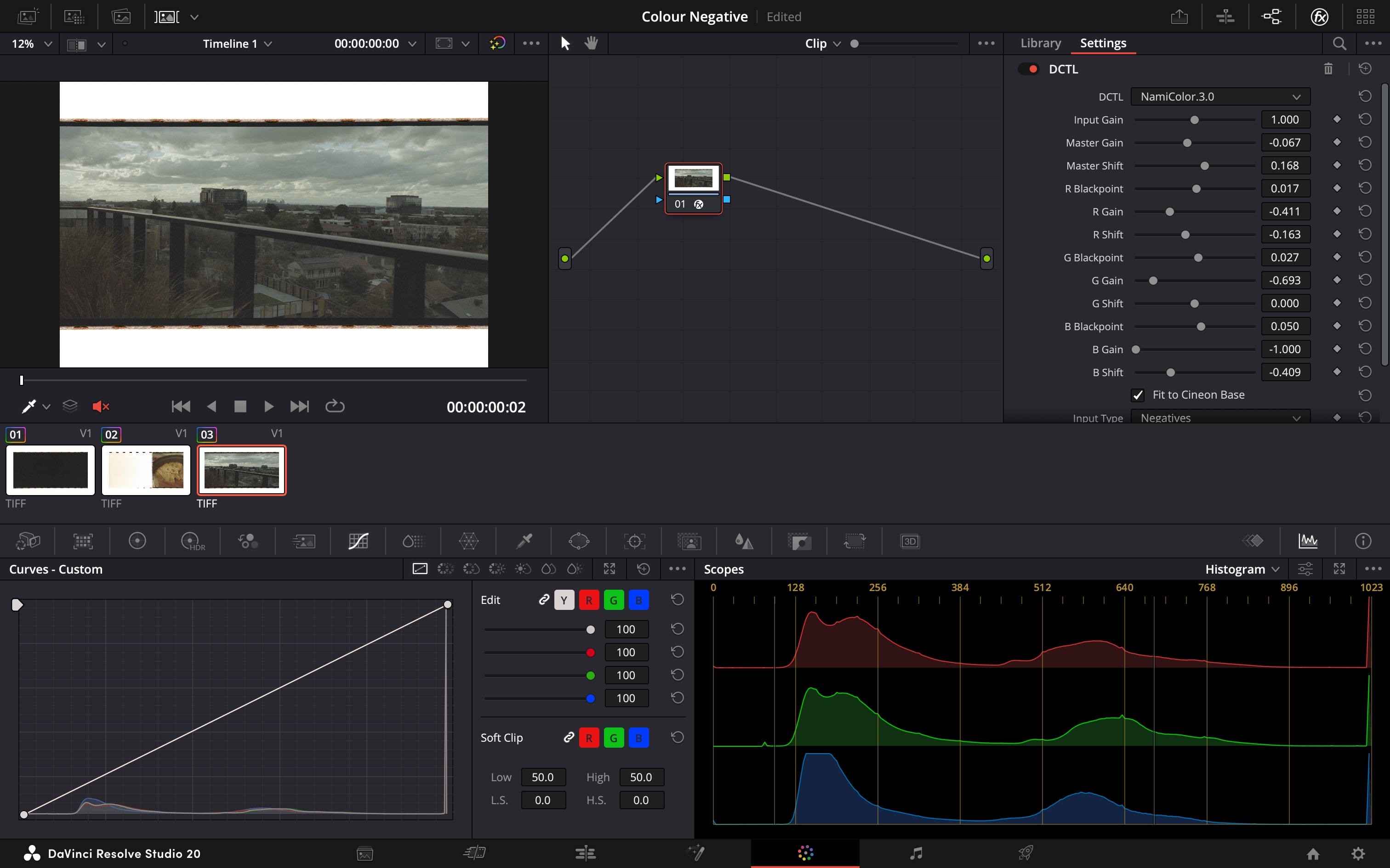

I use DaVinci Resolve to do grading, with NamiColor DCTL as the first IDT node. It automatically converts the linear scan into log space, where RGB alignment should be done within. After manually aligning RGB in both Dmin and Dmax (aka black and white levels) using shift, black point for Dmin and gain for Dmax, you get an image that is somewhat mapped to Cineon film log, but still does not actually match the toes and shouders of the film characteristics – as we all know they (almost always) don't have parallel RGB curves, especially in highlight/shouders:

Next to do is basically to adjust black point and gain according to the toes and highlights of the curves. For instance, Portra 800 after pushing would have significantly earlier roll-off on G channel, so G gain should be decreased. Also, B channel at highlight is steeper, so increase B gain a bit to match. I admit it's a little subjective here, but every move is based on film characteristics, not by taste. Toes don't need adjustment here, becaue we can see Portra 800 has excellent parallel RGB toes. At this point the colour cast due to unmatched curves should be removed, and the cool overcast sky is rendered correctly. With a second node of Color Space Transform to make it right for display, it would look like this:
It's pretty much a graded result, except a little underexposed. Lift the global gain as wish, then done. I call it "density-referred" workflow because it respects the actual density distribution of the negatives.
Right, I see; thanks for illustrating that so well. I've never worked with Da Vinci, but the overall process I can wrap my head around. I was wondering in particular about how you'd get from a curve in the datasheet to a digital adjustment curve, but that part is now clear to me. I understand you use the datasheet more or less as inspiration to do a visual adjustment manually.
