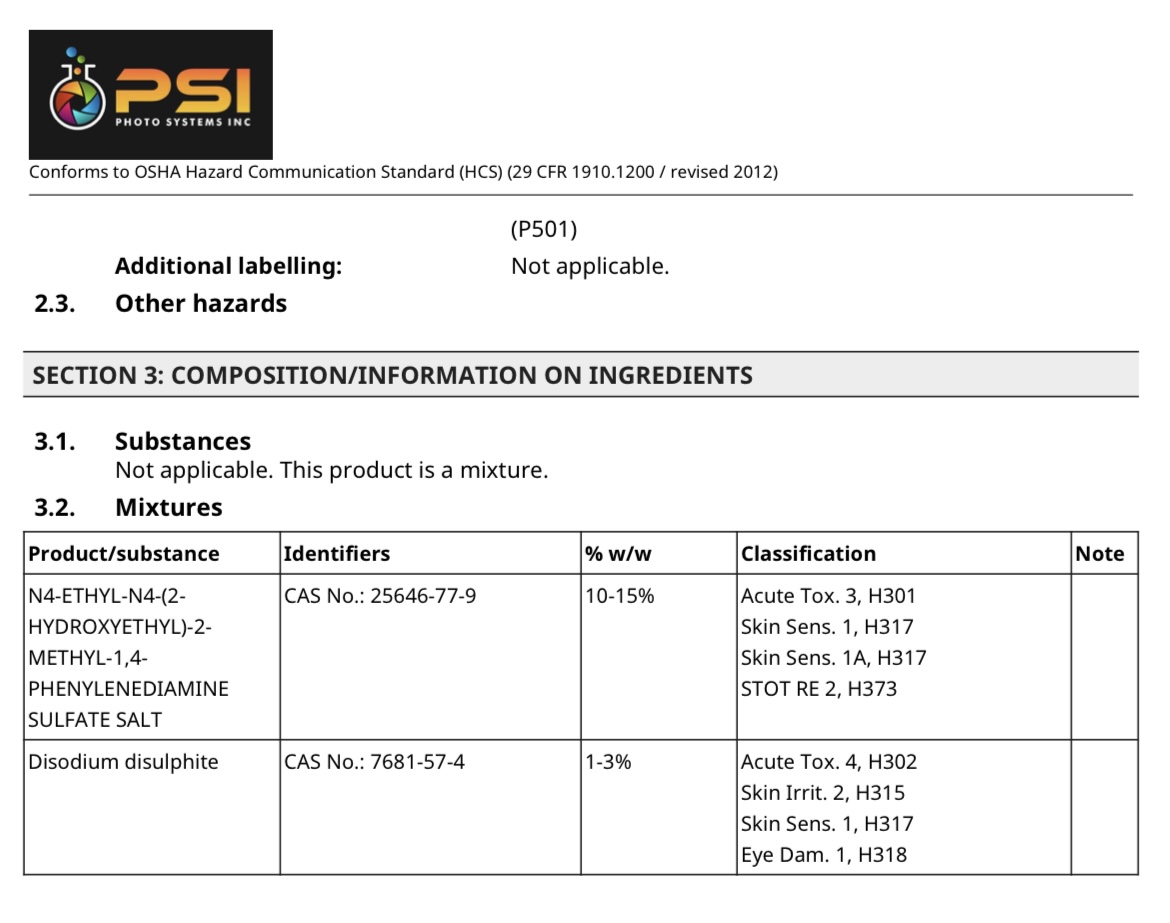

Hi. New member here just to share my experience regarding roll capacity. I came from a Google search and this post really says what I just noticed.
I’ve tried both Jobo and Ilford’s C-41 kits which are in fact both manufactured by Chugai in Japan. After having inconsistent results I noticed one potentially problematic design: their CD Part-C only features 25ml for 2.5L working solution, while Kodak’s has 94.6ml. This difference seems too much to me, so I dig a little deeper.
Upon checking the SDS of both Jobo/Ilford and Kodak (PSI) regarding CD Part C, their effective ingredient are both listed as 10-15%. I don’t know much about chemistry and its math, but together with their volume difference it then appears me that Jobo/Ilford’s kit cut corners significantly in its capacity. This is in line with their instruction manual which states for 1L working solution it needs extended dev time when processing 5 or more rolls of 135-36. Kodak’s states up to 20 and doesn’t need time compensation, which means 8/L.
Now correct me if I’m wrong: As I understand C-41 is a processing method designed to have a standardised CD dev time at 3:15 (unless some certain film stocks designed with “push” in mind), and no such thing as “if processing more just extend the time.” This really makes me think that not all C-41 kits are born equal when it comes to capacity.
I’ve also tried processing one roll with 500ml solution and it worked pretty well, both for C-41 and E-6, only not economical. This further supports my suspicion.

Could you perhaps link us to the SDS you found for the Jobo/Ilford chemistry? I'd like to verify what you relayed - not that I don't believe you, but to see if the contextual information gives some more insight and possibly an explanation.
From what you say, the possibility arises that the Jobo/Ilford product contains perhaps as little as 25% of the amount of developing agent as the Kodak/PSI chemistry. That would be odd, because I don't see any way (provided the pH is the same) to get the same degree of development with such a massive difference. In other words, if this is true, not just capacity would be affected - there would be more and more profound differences as well. I would expect the Chinese product to have a considerably higher pH, or the instructions to recommend a considerably longer development time and/or higher temperature.
Looking at the formulas and SDS for C41 developers, they turn out to pretty much all end up at around 4.5g of CD4 per liter of working strength developer. It would be really, really odd for a product to deviate from this by more than let's say 20% or so.

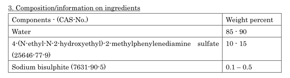

Hi koraks,
I’ve only got the files and I just screenshotted them. I uploaded as attachments.
I could be wrong though and I honestly do hope they actually didn’t cut that much, given that Ilford’s kit is cheaper here.

Thanks for the quick follow-up! I had a quick peek and I do recognize what you also saw. The Jobo SDS for C41 developer part C lists 10-15% CD4 content in a 25ml bottle for 2.5l of working strength developer. This boils down to something like 1.5g CD4/liter of working strength developer. AFAIK the solubility limit of CD4 in water is quite high and I wonder if perhaps the SDS is simply incorrect and the actual CD4 content is higher than stated.

Koraks,
Here is what I found on the Jobo C41 sds active ingredients. Parts A and B attached.
Links are here and here. Oops, sorry, I was too late!

Thanks @jl_nims and @koraks ! Glad that I wasn’t entirely mistaken.
I do suspect the CD4 in Ilford/Jobo isn’t as extremely diluted as the SDS states, but given my inconsistent results I had to suspect it’s likely not enough to match their capacity claim without quality issues. I scan and grade them manually by sampling both unexposed and fully exposed film base to map the density range in Cineon Log space, so it is very picky about processing results.

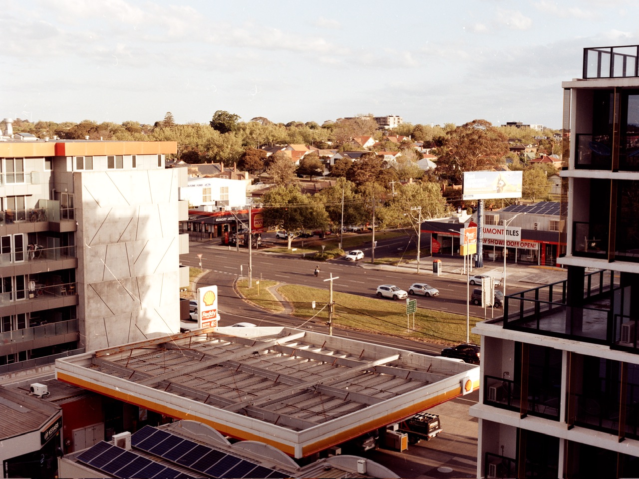

These two rolls were processed with 500ml solution at 3:15 using Ilford’s.
Oof - those both look really bad on my laptop. But of course there are too many variables too make any decisions based on that.

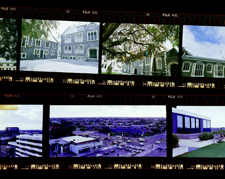

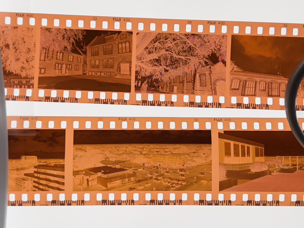

Here are the negatives. The upper strip being lab processed, and the other was the Ilford batch. Slight inconsistent base colour on each strip could be the back light issue, not the films.
Any advice is appreciated:smile:

The main thing I see is that the bottom negatives are more blue; looking at the negatives there doesn't seem to be a lot of cyan or magenta dye being formed. In part this may be due to differences in lighting, but that's surely not the entire story.
Note that the density in the sky is roughly similar. If one developer would be starved in CD4 (with everything else being the same), I would expect a large density difference there. It doesn't appear to be the case. My first thought would be issues with pH (mixing error) and/or process temperature control - although both would logically also result in significant overall gamma differences.
Can you describe your process in detail, please?
PS: I can't make much of the comparison in post #16. The main thing that stands out is that the lighting was different (time of day). However, again, that's not the only/main factor in the color balance. Different types of film used can account for part of the difference. I suspect color grading after scanning plays a role here as well.

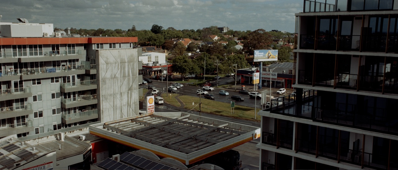

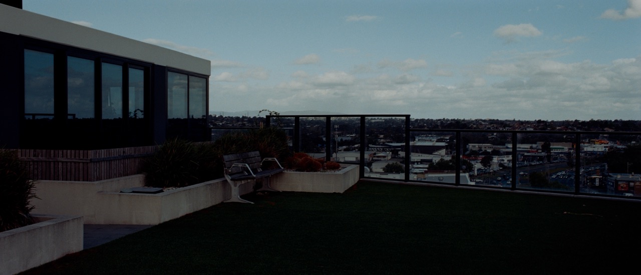

koraks,
Most likely due to grading approach as you said. I've attahced my scan for the two frames. (Raw file -> linear tiff -> Resolve Cineon log invert -> RGB alignment in Dmin & Dmax -> matching film characterstic curve slopes -> output). Also, the negative strip image you worked on was taken on a wide spectrum (high CRI) white light panel, so dye crosstalk for CN was quite significant there.
I've attached a third sample, a roll of Superia Premium 400 processed with 500ml as well. No issue of crushed shadow or underexposed look to me.

I'm sorry, I can't make out anything from those images. They are inverted scans/photos, so what the negative might have looked like cannot be reconstructed.
The kind of photo in #20 works well for troubleshooting, especially if a known-good negative is included as a benchmark. Inverted scans are generally all over the place.
The light source of the panel you used there really is not the problem.
If that refers to the frame numbered #33 that we've seen before: note that the negative itself holds plenty of density differentiation in the area that's 'crushed' in your photo in #22. So at least in part we're looking at problems with your digitization process in post #22.
One problem with that particular frame is that you have a very bright sky and a foreground that's apparently not receiving direct sunlight (it's in the shade of a cloud I suppose), so contrast is high. Exposure erred a little to the side of underexposure, which is not a development problem, but one of metering the scene. Then in the digitization process, what differentiation there was in the foreground was lost in the process; note that there's plenty differentiation (but a crappy color balance) in my very crude inversion.
I think you're battling a cluster of problems and it's unclear at this point to what extent these are potentially related to film processing.
The third example above (the portrait-oriented shot) does in fact look underexposed to be BTW; note the group on the left that drops away into undifferentiated shadows. This may or may not have been intentional. There may or may not be actual differentiation in the negative itself.

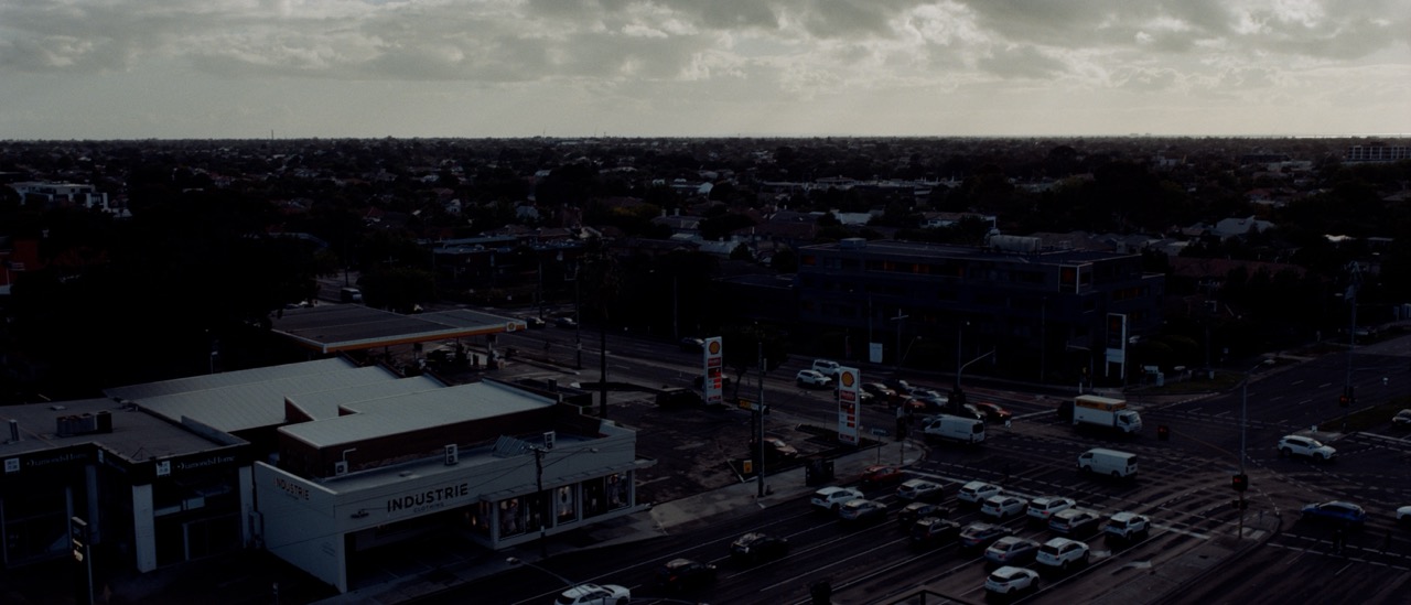

I'm still to find out. Currently my plan is to keep everything controlled but using Kodak's kit to do a batch and see. I'll share how it goes once done.
As for the no.33 frame. I agree I'm dealing with more than one thing here. I think it was a combination of development and exposure, although more on the former I reckon.
Grading should be fine, it's just that my workflow is really cruel to underexposure or development problem. Here is one when done right.

I suspect in your grading process you may not be taking into account the inherent flexibility of color negative media. It's very different from E6/slides where you have pretty-much a predefined contrast range and color balance. Color negative is inherently more variable - but also more capable when it comes to accommodating a wider range of SBR's (scene brightness ranges). This brings the risk of tailoring an inversion, balancing and grading process on a particular type of negative that represents only a small part of the total bandwidth the process can move in.
