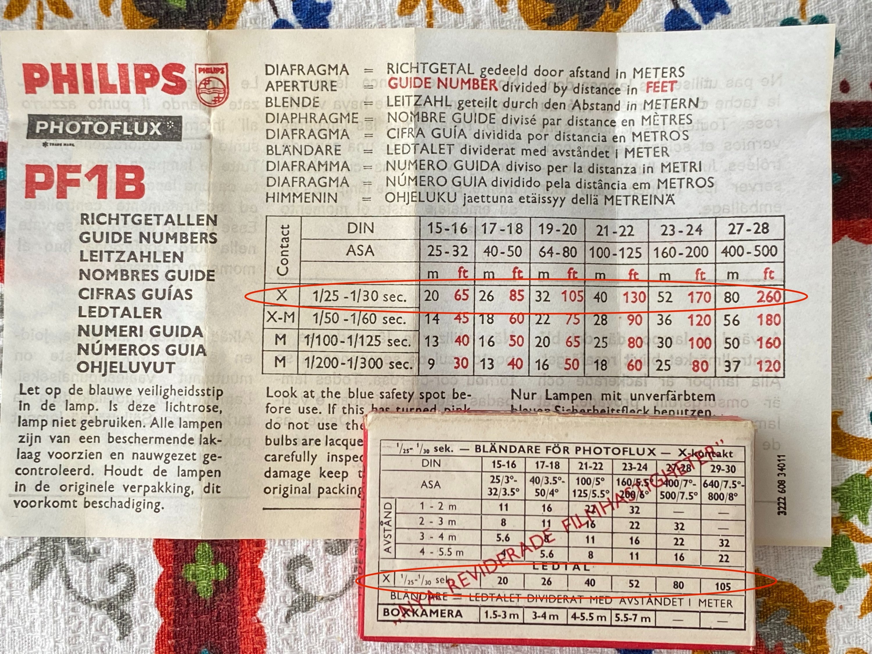

Note to those who may not know: The GN table images, above, are for TUNGSTEN film speeds. Daylight film speeds may differ. Also, the tables that reference fim brands/types are likely not the same speed as the same film/type made today. So don't forget to factor in all of the changes between the film of the flashbulb era and today; check your GN calculations carefully. :smile:
“b” bulbs are, if any, only a smidgen slower than the non-blue ones.
That much is evident from the packs data sheets, among the one I posted above.
It also evidently works for when the bulb is inserted in the special blue shield Polaroid flash.

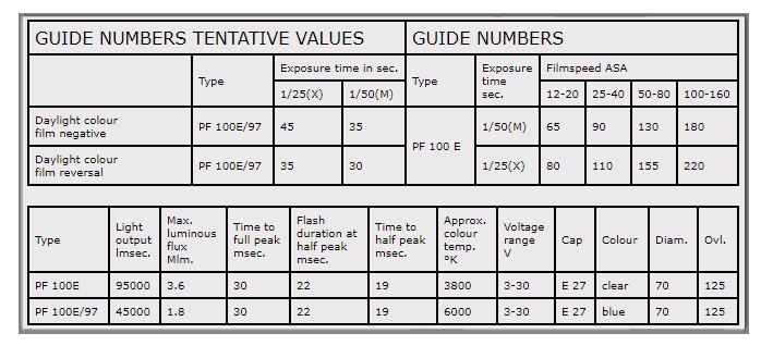

But true, as opposed to xenon flash, bulbs has a climbing (smooth) spectrum that extents far into infrared with very good output.
The blue coating is quite transparent to IR.
Aviphot film, and other IR sensitive film sings with bulbs, with or without IR filter.
25% less emission (Philips data)
But for speed of course the spectral sensitivity of the film must be taken into account.
Where is that data?
I have data too (web and packs) but it’s very ambiguous because the split in ASA is different, and some of the packs are before the ASA/ISO adjustment.
Doing a bit of math the speeds are very close though.
Osram bulbs are the same speed.

Dug out some M3s. Thanks to Laser for the “B” variety.
These are pretty contemporary, but again the rating spans are written out differently.
Look at the 25 on the B and the 20-32 on the clear though.
These are reasonable close. With a tiny advantage to the clear.
The speed difference is 18.18 percent. (Not accounting for the tiny advantage in ratings to clear.)
Edit. Also:
Seems even Philips couldn't see much difference.
The diagonal disclaimer on the box is "new revised film speeds" in Swedish.
