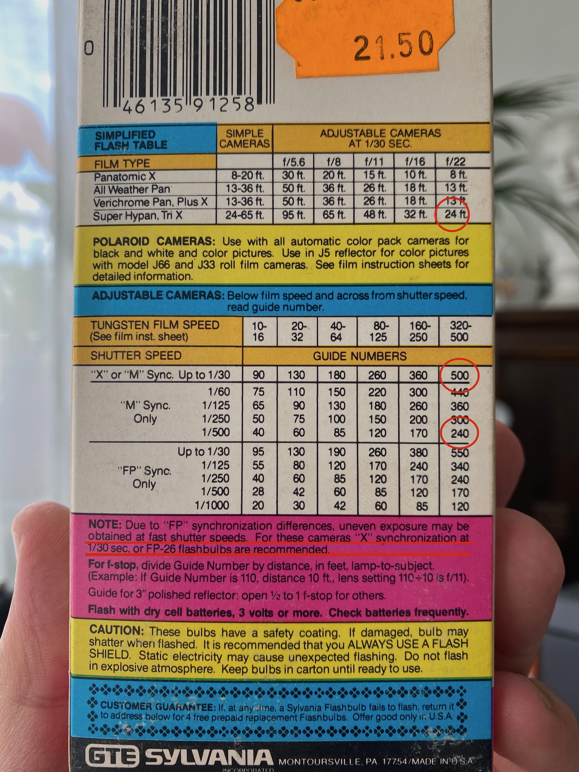

I acquired a Crown Graphic with all the trimmings several months ago, and one of the accessories that came with it was the Graflite Jr. flash gun. While the Graphic is getting some other work done, I decided to get the Graflite working and try to use it. It was a bit of a failure, and I'm trying to figure out why or what steps I should be taking to troubleshoot.
I bought a whole mess of GE #5 bulbs ("Guaranteed Rhenium!") and installed the 5" reflector on the base. My Ricoh TLR has an M-sync setting, so I plugged the flash into that camera and set it to M. The bulb boxes have guide numbers listed by film (not by ISO); camera had some HP5 loaded and I figured Tri-X was close enough to that so I went with that. I'm trying to do this all in our tiny dining room, and I can realistically only get about ten feet away from my test subject, so I picked a GN of 280 for 1/500 second. Maxing out the camera at 1/500 and f22 should make the whole thing a little overexposed.
Took two shots to finish off the roll of film, developed it, and... totally transparent frames with the exception of a couple of small dots where the flash bounced off a picture frame on the wall. Given the enormous light output I keep reading about old flashbulbs, I was expecting to be half blinded when the flash went off in such a small space, but it was a bit of a letdown. Can these bulbs go bad after all this time?

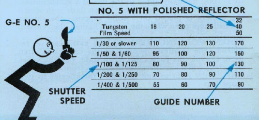

The comments about shutter speed are very important. Did you, or the GN table, adjust for “shutter efficiency “? To do that, there is a different GN for a variety of shutter speeds. If not, you were not using the majority of the flash light with that exposure. Unfortunately, you tried the most demanding conditions on your first try.

By "let down" I meant that I was expecting it to be a lot brighter. It did not make me blink or anything; compared to my dinky Godox electronic flash I'd even say the Godox at max output was brighter.
At bulb tables you will find exposure times up to 1/1000 sec, to control output ogf strong bulbs, if necessary. And shutter efficiency should be calculated into such tables.
Or do I overlook something? (Is see the OP used "just" the GN.)

Here's another table for a #5 bulb from graflex.org. In theory, a 280 GN was a reasonable choice:
GE® Number 5 Flash Bulbs Class M (Medium Peak)​
<=1/25​
1/50​
1/100​
1/200​
1/400​
EI​
Guide Numbers for 4-6 Inch Polished Reflector For satin reflector open 1/2 stop. For doors, open 1 stop. For close indoor spaces, close 1 stop.​
16​
110 95 80 70 55
20​
120 110 90 80 65
25​
130 120 100 90 70
32​
150 130 120 100 80
40-64​
190 170 150 120 100
80-125​
260 240 200 180 140
160-250​
380 340 300 240 200
500-800​
650 600 500 440 360
Which equals exactly two large hammerheads.
Note to those who may not know: The GN table images, above, are for TUNGSTEN film speeds. Daylight film speeds may differ. Also, the tables that reference fim brands/types are likely not the same speed as the same film/type made today. So don't forget to factor in all of the changes between the film of the flashbulb era and today; check your GN calculations carefully. :smile:
