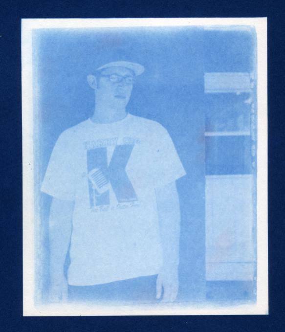

Here is where it stands:
1) Overexpose FP-100C (color) by 1-2 stops. Wash goop away and dry in plain water.
2) Tape flat to glass and apply a paper towel wet with household bleach (Clorox) to backing. Backing will dissolve away.
3) Place in my contact print frame with a sheet of Lana Aquarelle hot press watercolor paper coated with Ware's New Cyanotype emulsion.
4) Expose 80 minutes under 45 W of fluorescent blacklight (sunlight equivalent is probably 5-10 minutes)
5) Develop in mildly acidic water with final rinse in dilute solution of Hydrogen Peroxide.
This is the result attached. This is the best result I have obtained. FP-100B negatives were much too thin and the contrast was even less. FP-100C negatives with bleach/fix or just fix gave worse results.
As you can see, the image is way underexposed. The film itself appears to have a strong UV blocking layer. Further exposure improves shadow density but highlights suffer accordingly.
Ideas appreciated.
