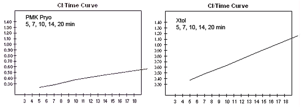

Two Time/Gradient Curves. Same film different developers.
From the PMK curve, we can conclude it would be very hard to over process. The low development velocity means that the film is very tolerant of processing errors. One minute more or less isn't going to have as big an effect on contrast as with the Xtol negative. The two curves also illustrate why it's not a good idea to use percentages to communicate changes in development time.
