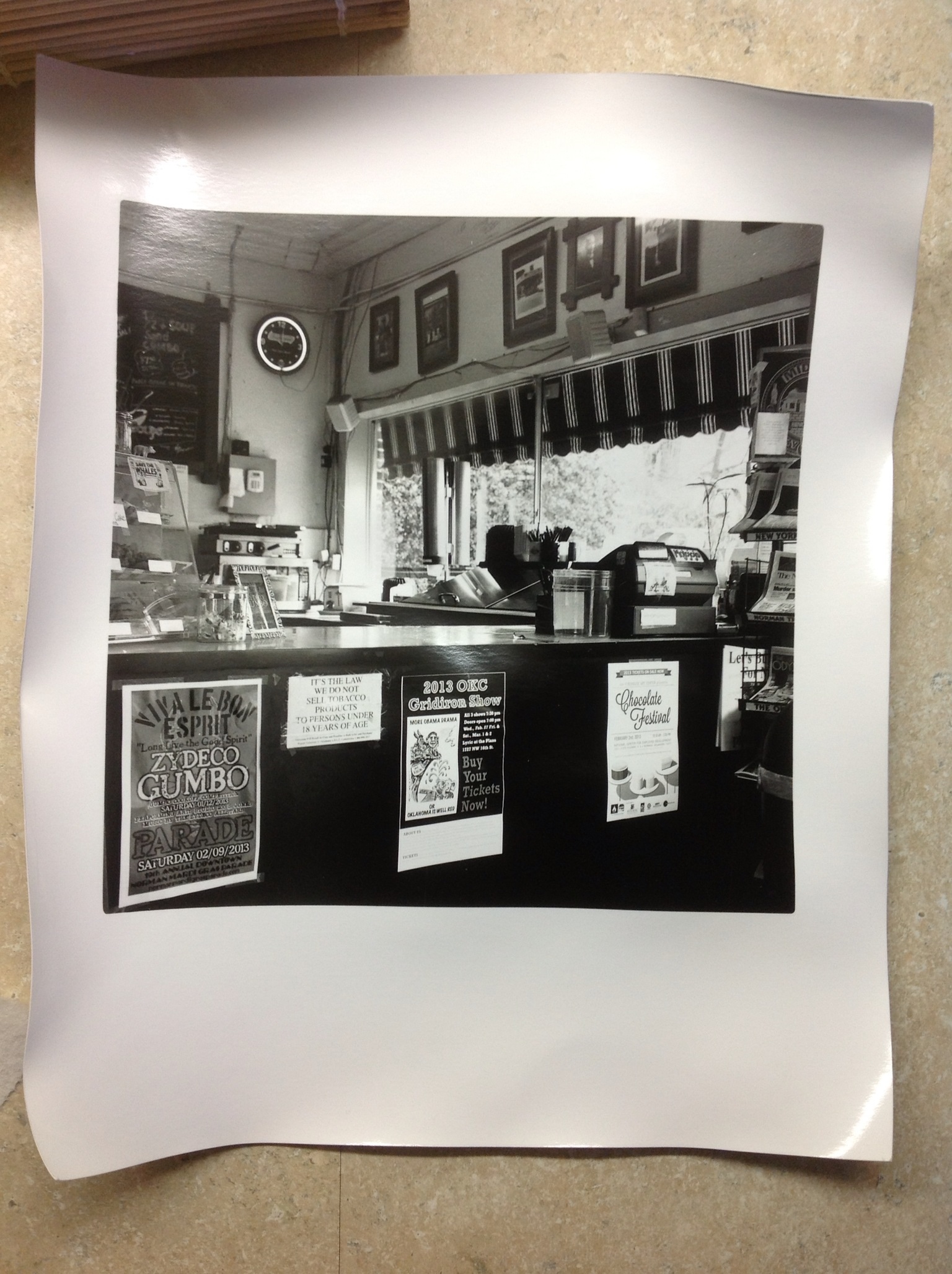

Rodinal can sag mid tones especially with high dilutions. Imagine a zone 4 to 5 dropping a 1/2 zone lower on the tonal scale. Now imagine a highlight that prints well surrounded by darker than normal mid tones.
This print has a Rodinal look. The print is rich in tone, hard to tell on the thumbnail. Posters float off a darker background. The window light is not blocked up. FP-4, EI 50, Rodinal 1:65. Straight print on Galerie grade 3.
Rodinal has a romance to it. A love hate relationship with me. But renewing my commitment to one film, developer and paper, I believe our relationship will grow.
Don't blind date Rodinal. I recommend the inexperienced double date with a general purpose developer like D-76/ID-11 or XTOL. Establish a standard to compare Rodinal to. Rodinal is a special purpose brew to control contrast. For me I like the occasional surprise. It has a different look. Maybe others can describe it better.
