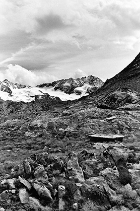

I am a regular Rodinal user ! i love it with hp5 and tri-x for street photography , and with rollei 80s for landscapes.
With 1:25 or 1:50 diluition , 30 seconds of initial gentle agitatons , than only 1 gentle agitation every 30 seconds.
Or a splendid 1:100 1h stand!
This is a print on mcc 110 in moersch eco4812 , rollei retro 80s (agfa aviphot pan 80) 64 iso in rodinal 1+100 semistand
