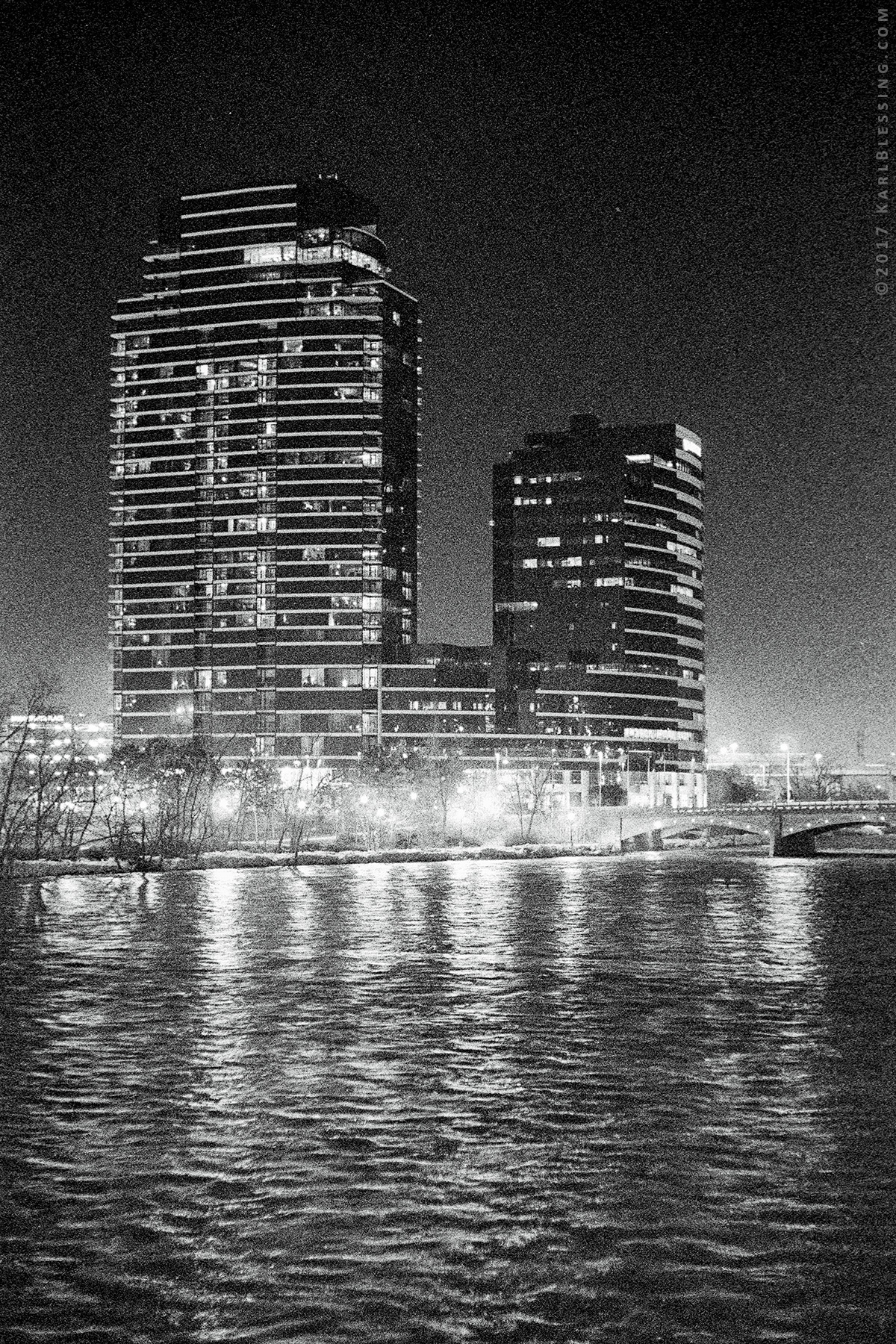

And I have several 135-36 rolls of Kodak TMax P3200 that only expired in 2004, but has aged much worse than the other stuff (apparently P3200 ages badly). Can get a decent result scanned out of it if you shoot it as ISO 400 (develope as 3200), but kind of defeats the point of P3200 especially when it has much more grain than equivalent 400 speed films. Though I'll try Microphen with the other rolls and try for 800 or 1600 to see what I can get (the base density of the negatives due to age makes it harder to get good contrast).
Canon 7 Rangefinder (1961)
Canon 50mm f/1.8 Type 6 (8 bladed aperture with curved edges on the octagon, serenar style optics)
Kodak TMax P3200 (expired in 2004, not refrigerated, kept at room temperature)
Developed in Kodak HC-110 Dilution B, 68F 10.5 minutes, Agitated once every minute (a 'tap' every 30 seconds in between)
Scanned on a Canon FS4000 dedicated 35mm film scanner.

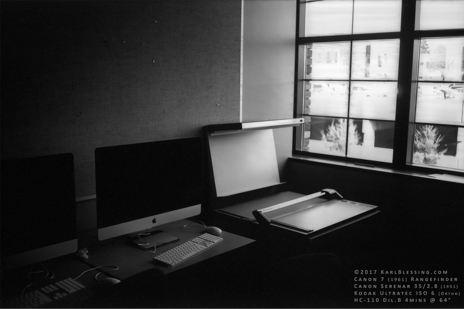

Where as this UltraTec stuff (which I have a bulk roll of) expired sometimes in the 90s, and yet still yields a very nice image (I need to rate it around ISO 3, and looking at other developer combinations to see what I get).

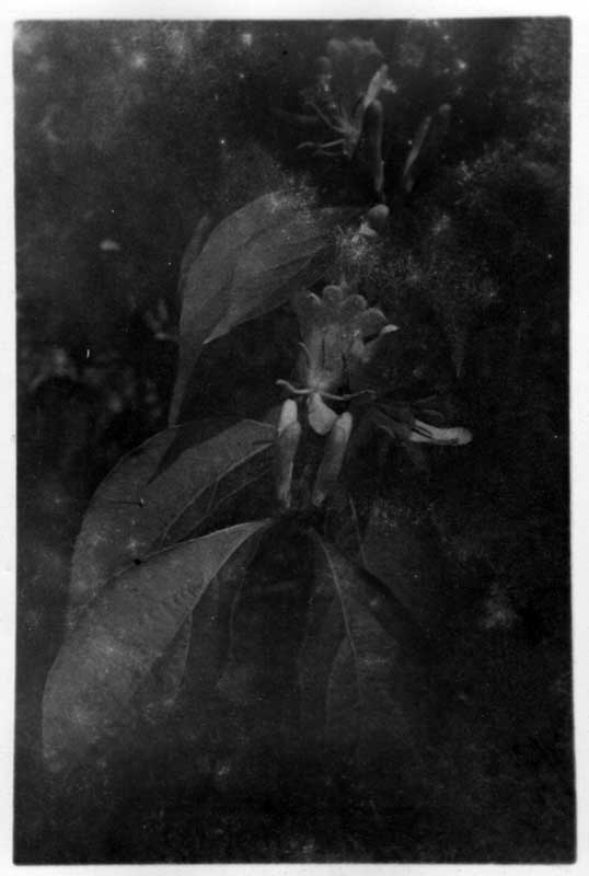

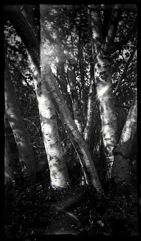

See below for an example of 65+ year old film, shot in an 80+ year old camera in 2016 (with a whole bunch of extra exposure compared to what would be normal for its original ASA). You can read more in the following thread: (there was a url link here which no longer exists)
