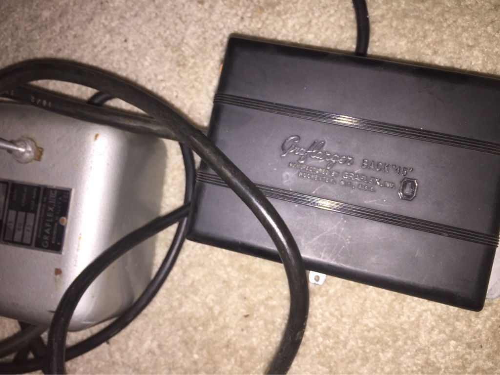

Your idea reminds me of this:
I used to tape the paper to the wall and project it with the graflarger back in my lf experimenting days
heespharm
Dec 8, 2009
527
Wait a minute.... Hahaha look what I found in my photography closet
Forgot I even had it

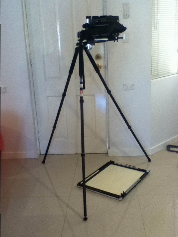

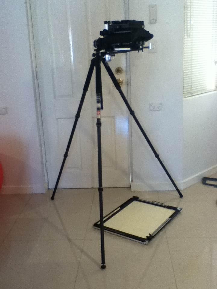

Anyway, back to the realistic bits. Just for shits'n'giggles I mounted my camera vertically above an easel, and there's more than enough room in there to work.
attachment.php
It's a Toyo 45G (not a light camera, but at 6kg it's less than my 8x10), on a Vanguard Alta Pro 283CT (load capacity 8kg), with Arca Swiss Monoball P0 (max load 20kg, probably on-axis, which this was not). The easel is 'only' 16x20", the biggest I've got lying around for now (there's no point buying bigger until I get this LF enlarger happening).
Despite being less than ideal, it certainly held the weight fairly well and with no more (but not much less either) wobbling than my LPL6700.
I've got a beefier tripod for my 8x10 (Vanguard Abeo Plus 363CT) which would hold the weight a lot better (except it's only got a Sunway DYH90R levelling-base so it can't point straight down, I'd need a 90-degree adapter for it).
But still, besides needing said adapter to point straight down, it still fits in the 'if you can shoot it you can enlarge it' category.
I did also think about modular, actually making things modular is one thing I like doing. The biggest problem is in the joining of the PCBs, both mechanically (to retain flatness) and maintaining the distance between LEDs for even illumination without getting a dark or light stripe. Certainly doable, but a lot easier with bigger LEDs on a bigger spacing than smaller close-together. I did think that eventually someone would want a 7x17" or something, so I'll investigate modularity too. 8x10 is *probably* better off (cheaper) as a single PCB compared to work in joining, but I'll check it out.
