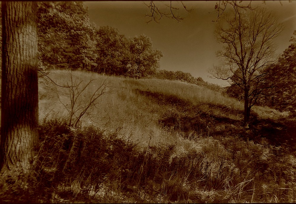

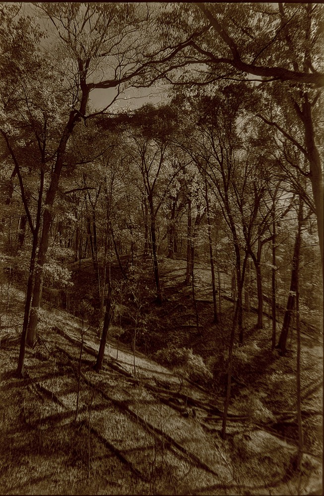

After more careful analysis, I believe it's likely my developer inconsistencies are due to my own measurement errors in using measuring syringes as well as sodium carbonate solution storage rather than the developer going bad in the bottle. Here are two examples of my scanned negatives that were taken last fall on Kentmere 100 developed in PC-glycerol 1:100 with what I thought was 6g/liter sodium carbonate solution.
Kentmere 100 MC-glycerol 1:130 12 min. density range 1.03 sodium carbonate likely less than 6g/liter
For me, the measurement syringes are extremely error prone. I purchased some very tiny measuring spoons that let me mix this developer as a powder, so will likely be using that method, which I believe for me is much more reliable. For others, the developer mixed in glycerol may be much more convenient and reliable.
