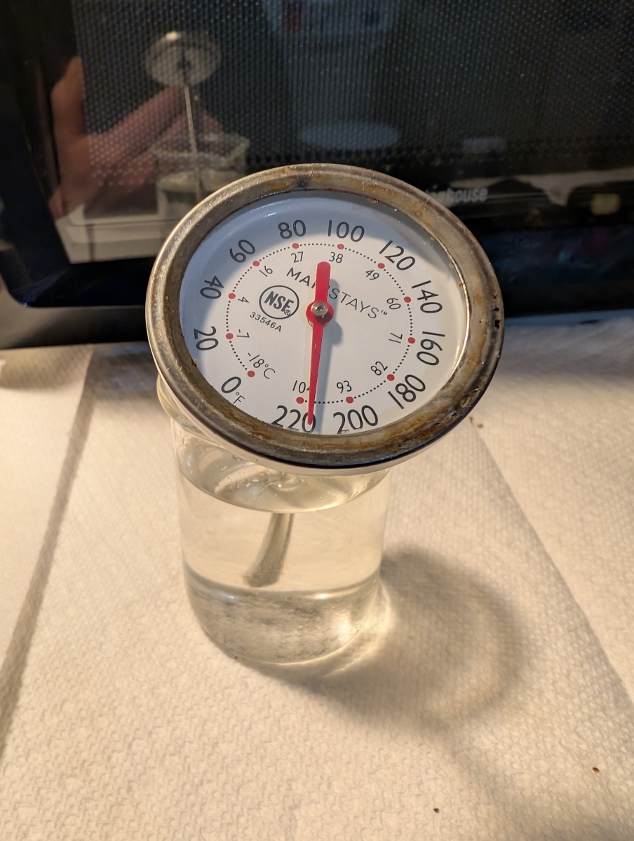

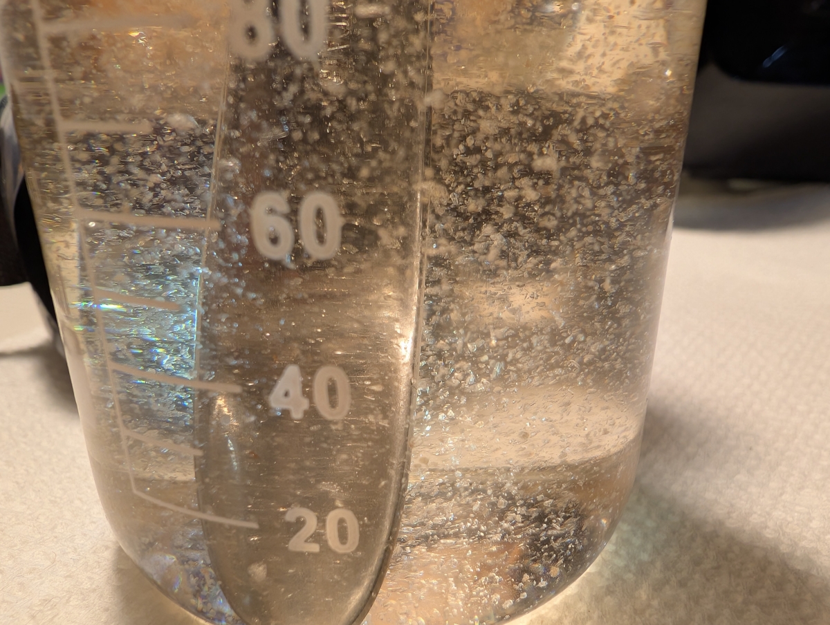

Here are the photos of my first attempt to put Gainers Original MC-sod. carb. monohyd. into glycerol.
This was my equipment and materials. The glycerine is a high quality one that I got on Amazon for thirteen bucks. The small microwave is only 600w, but still needs to be turned on for 5 seconds to gain ten degrees or so temperature. Best to use highest power setting, since it duty cycles on lower, making it much harder to use.
The thermometer was one I got at Walmart a few years ago, goes up to 220 f, which is adequate to get above boiling point of water to checking water content of glycerine. If present, steam bubbles will form and raise to the top. This temperature was after attempting to add metol the first time.
I stirred the glycerol with the hand of a stainess steel spoon, which worked very well. Note what looks like bubbles, but is undissolved material of some sort due to my errors in mixing the metol.
This close up shows the little pieces of something that shouldn't be there. They looked more like filaments but look more like just clear crystals here. These formed right after I added the 1g metol to everything else. I tried to add it slowly. but with so little that was not possible. It was all dumpted in at one time, and somehow cause a chemical reaction, probably a sufation of the glycerol, that formed these strange little particles and destroyed the metol. In the next post, I will show the negs I got when testing this. I hoped these little particles would turn back into metol when added to water. They did disappear, but the developer acted like an ascorbic acid only developer. A learning experience.

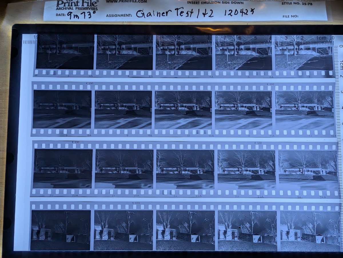

Here are the results of using that first bad batch of developer.
The strip at the very top is correctly developed film using Gainers Original MC wet. Sorry my light pad is so small. The botton two, of course, are the testing exposure that are extremely flat. So flat I velive that only the ascorbic acid was active in the developer. I did try to manipulate one to look good, which is the most uper left negative of the lower two strips. The film is expired tmy using my Minolta X700 in aperture priority mode set to ei100. Note the high base fog despite severe underdevelopment. From left to right, +2, +1, 0, -1, -2. Since this camera has no mirror lock up nor is it usable in metered manual mode, I use it only for film testing.
Notice there are some good mackie lines around the tree branches. Tomorrow I may be able to test develop some film in my second version of the developer, the one that works. In that case, I added the metol first all at once at room temperature, then heating while stirring up to the point it fully dissolved, which was at 160f. In this way the metol was fully dispersed in the glycerol before heating. I would get metol is only about 0.1% soluble in glycerol at room temperature. Therefore even the 1% level at the end of high temperature is a supersaturation situation, even though that seems very low. On gradually adding the 10g ascorbic acid while heating and stirring, full solution required 180f. I know from research that ascorbic acid is only 1% soluble at room temperature. Ten percent is obviously supersaturated. One of the mysteriously wonderful thing about polyols like glycerol and glycols is that supersaturated solution are stable at room temperature and below, unlike most solvents.
The tongue of the first film I developed in the wet version of this developer has a density of 2.91 developed 9 min at 73 F kentmere 100. Same film clip test yesterday with latest version of glycerolled MC developer with same film at 70 F 9 min was 2.62, a little lower than expected at least partly due to lower temperature.

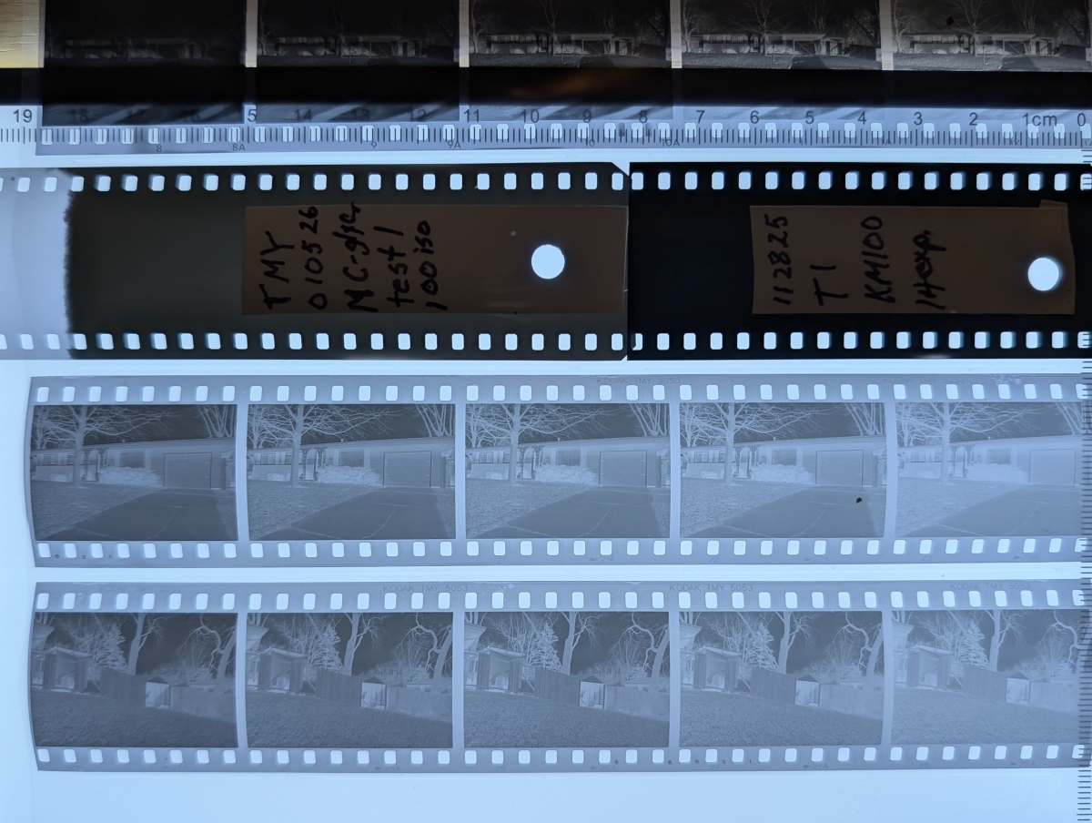

Today I just processed a short roll of the same film that I tested on the same day as the wet version. This time I used the glycerolled version at 1:100 with the same sod carbonate concentration of 6g per quart monohydrate. If this gives better acuatance than I got with the original wet version, it is the one I will use for my camera film in the future. This is not a solvent developer, so not sure if dilution gives improved acutance. Generally, higher ph does increase acutance, so I used this higher than I would get if I diluted both the developers and accelerators the same.
I developed this roll Kentmere 100 for 12 minutes at 68 F. My darkroom is in the utility room in the basement, so when warmer out it's colder there and vice versa. I use a foam cooler with about 5 inches of water and an aquarium heater set for 70 F in it. My dilution was tempered in the cooler, but the sodium sulfite was not, so got colder today on the shelf. The negatives look all good, so I am very happy. Will scan when dry.

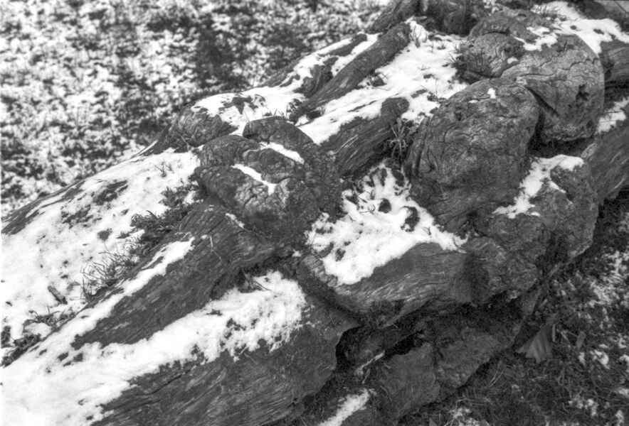

Here are the scans from negs processed to today in MC-glycerol sod carb at 1:100 for 12 min. at 68 F.
Top two strips are Gainers Original wet at full strength, 9 min at 73 F.
Bottom two are from today using glycerolled version on same at 1:100 12 min. at 68 F. These are slightly thinner, which is good since the first were clearly over developed.
The sequences from left to right on all strips are +2, +1, 0, -1, -2 cemtered on ei50 using minolta X700 my only good for film testing because it has no mirror lock and can't take really sharp pictures camera.

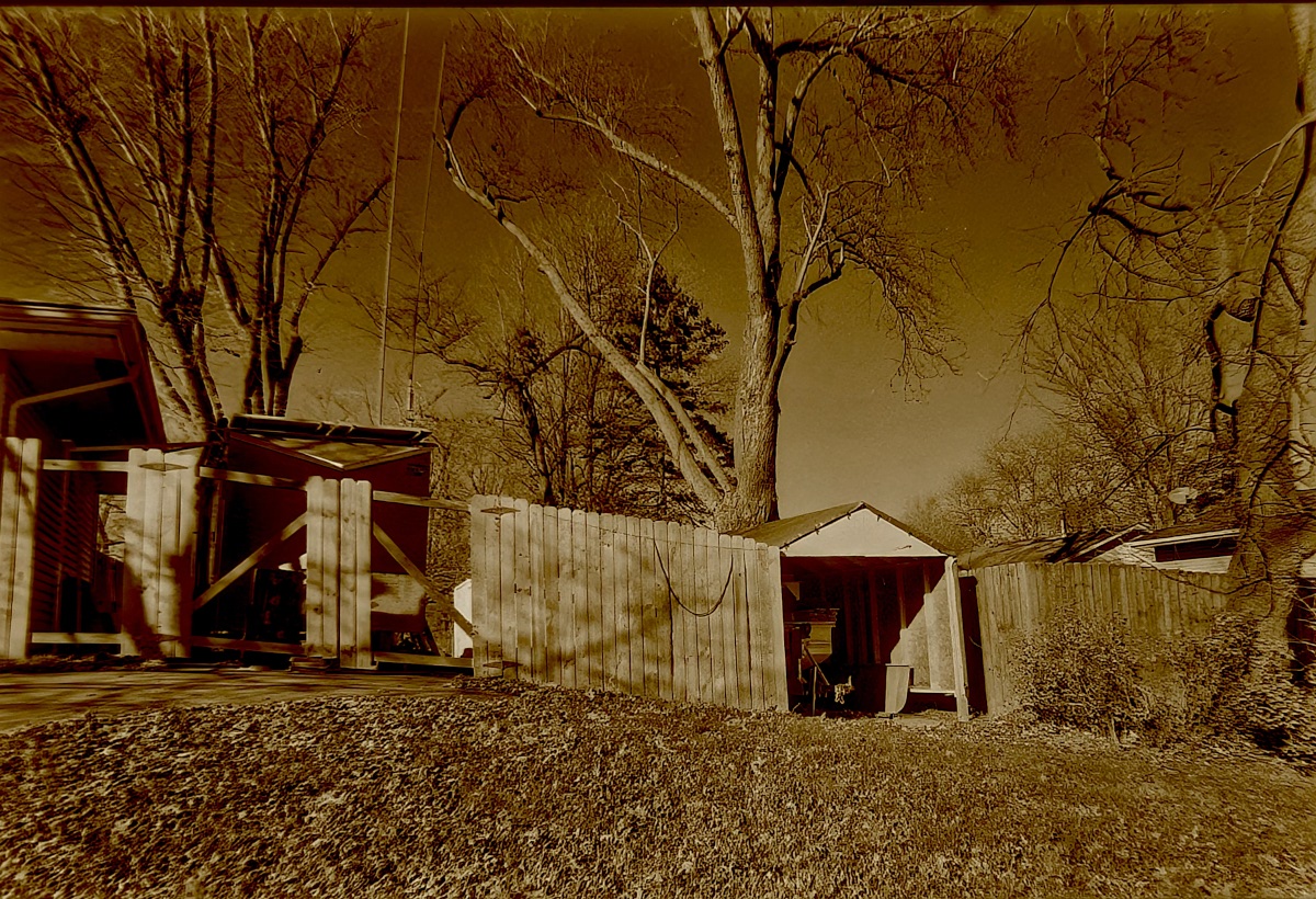

This is a converted image from today and was exposed at ei100, a full stop more than I normally use. Notice the stronger mackie lines now, a real improvement to me. This now my personal favorite developer. My phone scans are simulated VanDyke Brown prints using my phone in color mode with a very cold light tablet, making my negatives look really cool, kind of xrayish, which becomes warm brownish on inversion after I remove some saturation.
Another shot with same settings as last picture. I really like this new developer now with the higher acutance than before. Also more economical if that is even possible. I used 3.6 ml of my concentrate for this roll of 35mm. I will not try it at 1:3 since the acutance at 1:1 here looks about right to me. Grain is also very fine as well, hardly visible. It was fun pulling this old Gainer Original Developer out of the scrap heap of time and sticking it in glycerol for shelf keeping and super convenience. Thanks to Pat Gainer and old the old message boards including this one.

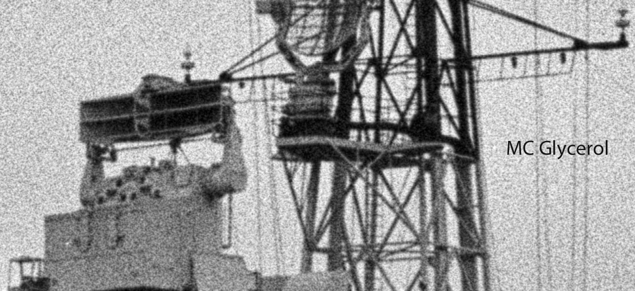

I compared MC Glycerol 1:100 (D-76 time was OK) with Rodinal 1:50.
Negatives were scanned and processed as far as possible identically.
Here is the full 35mm frame with MC-Glycerol, crops with MC-Glycerol and Rodinal are attached.
My conclusion so far : Rodinal grain with its jagged edges may look sharper, MC Glycerol offers somewhat higher definition.
