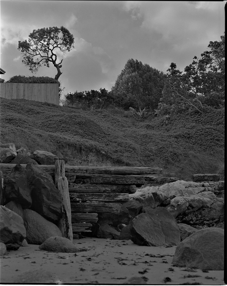

Technical term for low contrast, flat negative, although some people like the mushy look, I dont. Probably something I was doing wrong, doesnt matter, they dont make it any more and I wont be buying any more rolls.
Medium format cooked in pyrocat hd.
